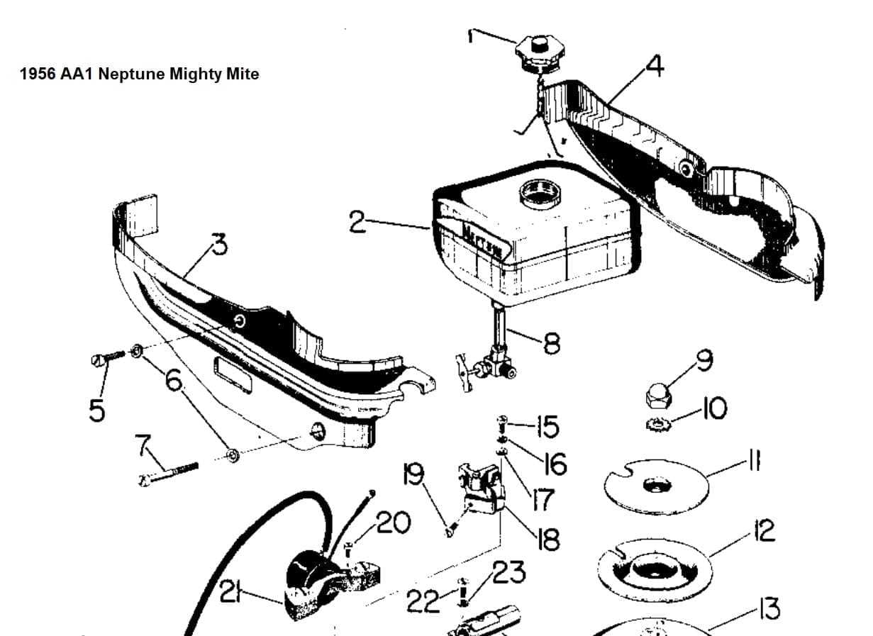

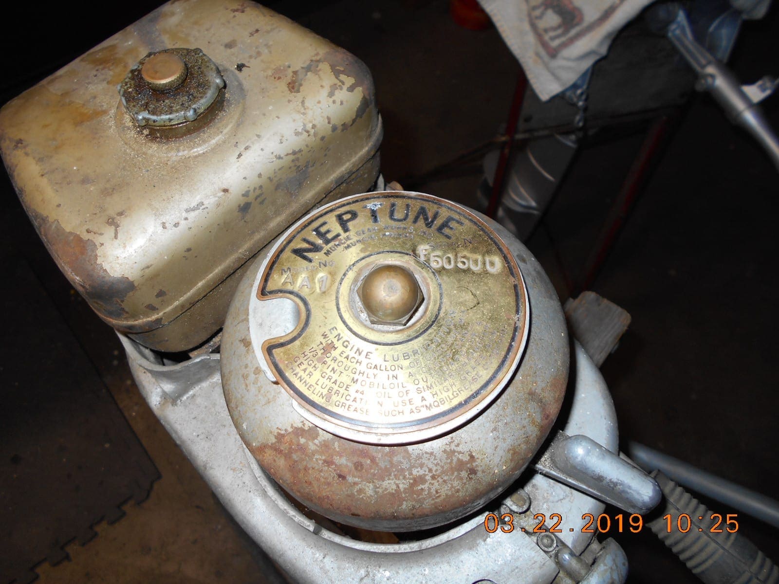

Regarding the 1956 AA1 Neptune I’m working on, does the fuel tank shut off valve pipe
unscrew from the tank? It almost looks like it’s pressed or stamped into the tank.
Tried to unscrew it, but didn’t want to break it. Metal tank with ancient gas inside,
so very rusty.
Did these have a screen inside the tank?
Thanks!Prepare to be boarded!
April 2, 2019 at 8:17 am #172486I am not an expert on these motors but part 8 looks to be a filter screen.
I would be very surprised if it was pressed in as I’ve never heard of it.
If there is a lot of corrosion in the tank it’s probably just stuck with corrosion.
After you’ve cleaned anything flammable from the tank, heat and penatrating oil are your friend.April 2, 2019 at 9:02 am #172487Thanks for your reply. #8 is a steel 1/8″ pipe. Not likely there was
a screen inside the pipe, but perhaps in the tank.

April 2, 2019 at 4:28 pm #172505After soaking the inside of the tank in phosphoric acid all night, I was able to unscrew
the shut off valve pipe from the tank. There was a tiny remnant of a screen in the end
of the pipe. Got a lot of the rust and crud out with the acid and shaking screws around,
but got tired of that and sandblasted the inside and out. Though a very heavy wall tank,
I still ended up with three little pin holes from the rust, so I have sealer in it now.
According to a Doug Penn article, the “gold” color tank on mine was from a later model,
than the AA1 (1956) that the flywheel plate indicates. Mine is suppose to have a maroon
tank and say “Neptune” instead of “Mighty Mite”.Prepare to be boarded!
April 3, 2019 at 10:17 pm #172577Bucc, something is fishy here… a steel pipe??? how does the fuel get from the bottom of the tank into the TOP of that pipe?
Joe B
April 3, 2019 at 11:56 pm #172582The steel (Galvanized iron) pipe threads into the bottom of the tank. If it rusts, brass may be used.
This reply was modified 7 years, 3 months ago by
garry-in-michigan.
April 4, 2019 at 7:58 am #172590Bucc, something is fishy here… a steel pipe??? how does the fuel get from the bottom of the tank into the TOP of that pipe?
Joe B
Joe, not sure I understand your concern regarding the flow of fuel.
The pipe screws into a boss in the bottom of the tank that protrudes
about 1/4″ up inside the tank. The tank is steel, so I don’t think
Neptune was worried about a steel pipe either. Once I got
the pipe out and cleaned, it was actually in good shape.Prepare to be boarded!
April 5, 2019 at 1:21 pm #172686OK, I get it now.
With the discussion about screen filters, I had the idea that the pipe fit up into the tank, like a filter screen would. So there in no filter screen on the end of the pipe? If not, one could sure be added. That is something that I do for all of my motors regardless of whether they came that way or not.Joe B
