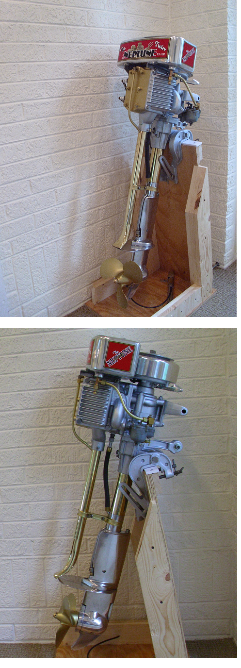

I saw a unusual Neptune this afternoon. I don’t recall having seen one like it before. Model 5A39, an alternate firing twin, looks to be about 5 hp size and it had a WICO mag using a "wasted spark" ignition arrangement. I am familiar with the concept of wasted spark on 4 cycle engines but had never seen this arrangement used on a 2- cycle. The "Outboard Book" does not list this model in the pre war Neptunes, Although the Neptune history section does mention early alternate firing motors of 9 -1/2 and 6 HP. Is this an unusual motor, what’s the story with the wasted spark set-up?
Joe B
wasted spark… when an ignition system provides a spark during a non- compression portion of the cycle. On a 4-cycle motor (your common Briggs lawn mower) you get a spark at TDC on both the power stroke and the exhaust stroke. On this alternate firing twin 2 – cycle both cylinders get spark every 180 degrees of crank rotation, one cylinder at TDC , compression and the other cylinder a BDC ( wasted spark).

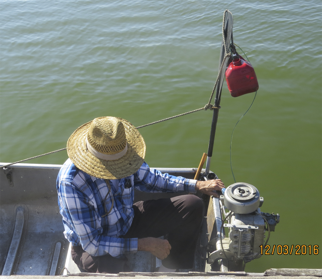

December 2, 2016 at 5:32 pm #48405Tubs, thanks for posting the pix, video. She sure seems to be running nice on your boat. As for starting issues, I’m going back to the wasted spark ignition system. have you ever encountered another 2-cycle with that arrangement? It seems strange that one would introduce a spark at the point of the cycle when the fuel charge is being introduced into the cylinder. I wish that I had had my camera to get a picture of the 5A39. It is configured similiar to your motor (but ?) the cylinders are a one piece iron casting.
Joe B

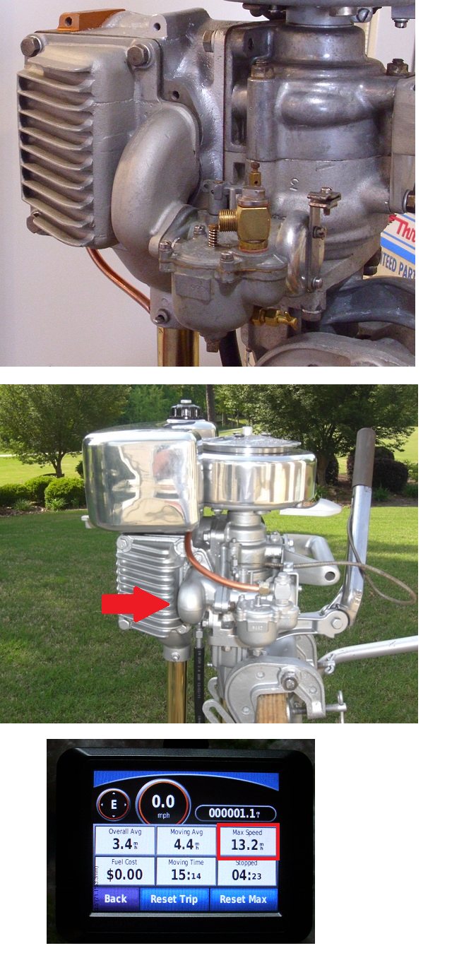

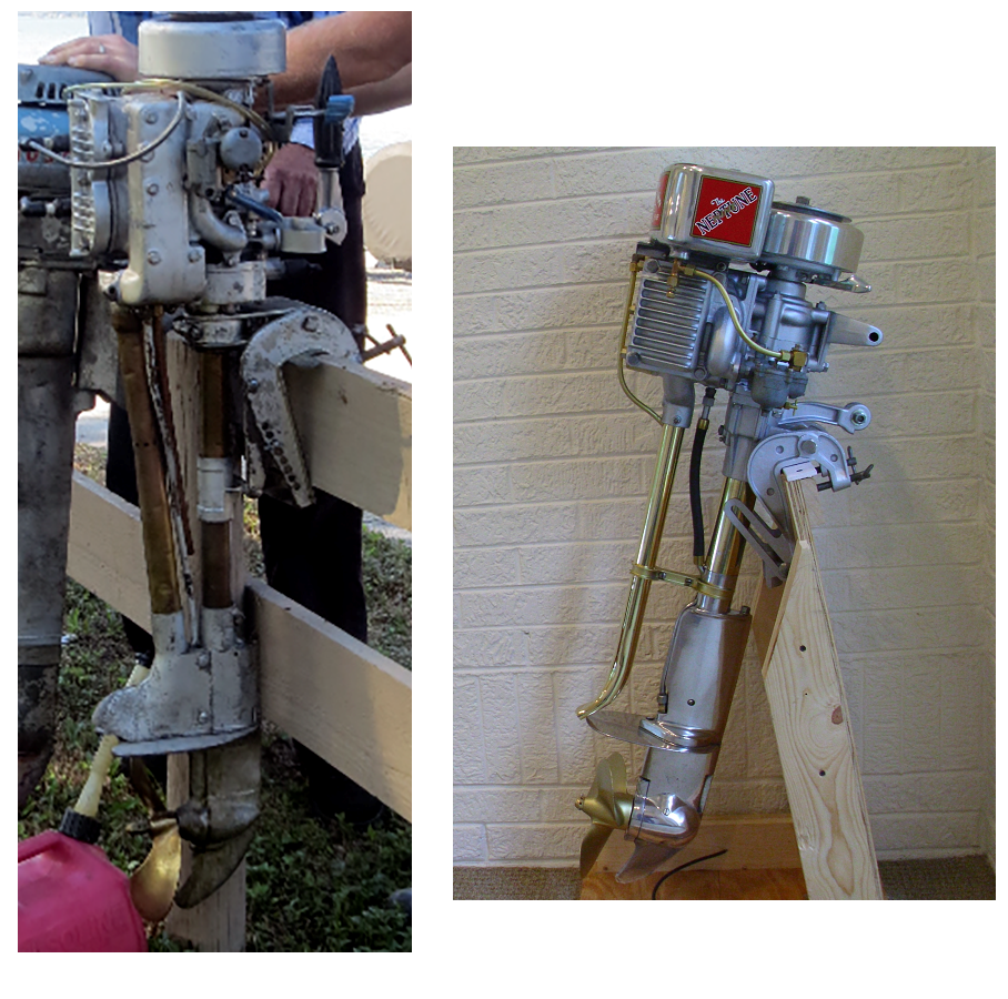

December 3, 2016 at 4:12 am #48439Its not the spark that’s the issue IMO.
Once I learned the point gap was changing
I set them with the mag advanced and
left it there. When priming or pulling it
over any fuel ends up in the lower part
of the manifold which almost makes this
an up draft carburetor it is so low. If you
primed it or didn’t – it would never fire.
Close the mixture screw all the way and
if it was going to fire it would on the 3rd
pull. If you don’t get the mixture screw
open quick enough it will die and you start
all over. If you do get it open quick enough
and get it warmed up and dialed in and
shut it off – it wont restart. Not even a pop.
I’ve seen later models where they have raised
the carb. (2nd photo) Steve Wood bought one
at Tomahawk this year that had a choke. If
I get to go next year I’ll be interested to
hear what his experience has been. When
I did get it running it ran well but the size
and shape of the gear case moves through
the water like a cinder block. 13 MPH is
the best it would do. My 7 hp. Speedsters
would do 20 MPH on the same boat. I have
motors that are much more fun to run but
I still like the look of this thing. Its a great
display motor so I’ll be keeping it.A "Boathouse Repair" is one thats done without having tools or the skills to do it properly.

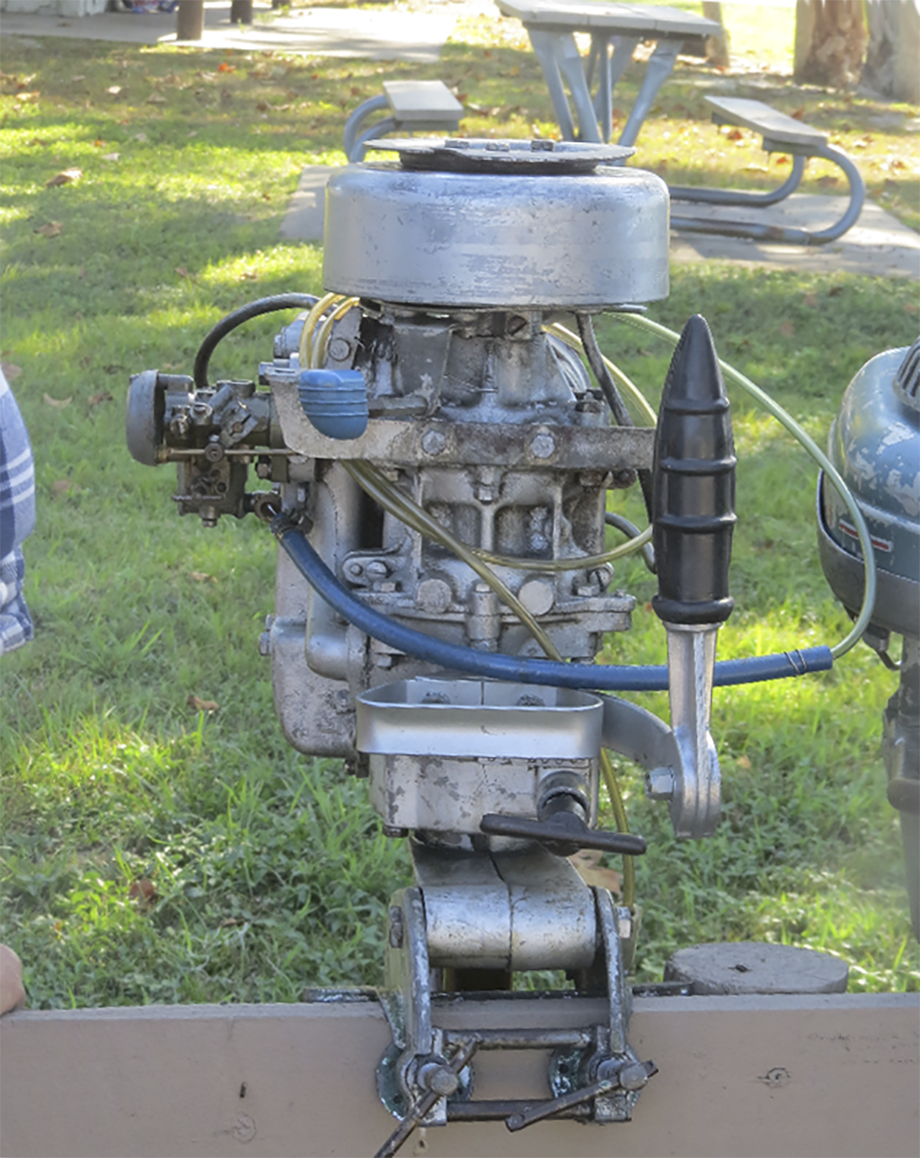

December 4, 2016 at 6:40 am #48494December 4, 2016 at 3:13 pm #48512December 4, 2016 at 6:23 pm #48528Could Steve’s motor be a Champion?
December 5, 2016 at 5:31 am #48570
Since it has the rewind starter under the powerhead, it must be a Champion. But I have never seen one like that before. . . 😳
December 5, 2016 at 11:09 am #48579It’s a 3H 1942 Champion. A fairly rare motor and quite a good running one. I had one years ago.
December 5, 2016 at 2:44 pm #48587I’ve never seen one.
1942 H-3 search only turns up Electra Twin – 7 hp.
If it was first introduced during the war and wasn’t
manufactured after there couldn’t many.
Anyone have pictures?A "Boathouse Repair" is one thats done without having tools or the skills to do it properly.
