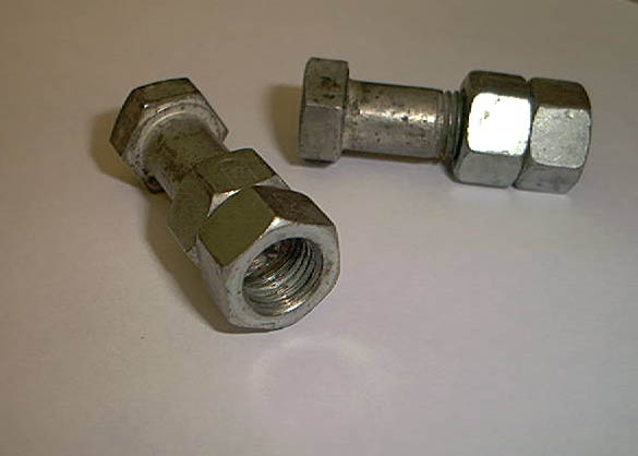

Any sage advice on removing the flywheel from a Mighty Mite? I’ve got a 1941 model. There’s no holes in the flywheel to thread my puller. On a different, but related project, one member recommended using a homemade device, threading a nut on the crankshaft, then threading a bolt in the remaining threads. Downward pressure on the crankshaft versus upward shear force on the crank thread roots. No upward pressure on the flywheel. Does that method have any success?

August 15, 2024 at 4:03 pm #289878Almost correct. It’s called a “knocker” tool. I’v used mine on so many motors that I couldn’t even begin to count them. And never damaged a crankshaft or flywheel yet.
Find a bolt the same thread as the crankshaft and as short as possible, and two nuts. Run one nut up onto the bolt and the second one only a couple of threads up. Run the first nut back down and jam it against the second. You have just made a special tool.
To use, run the tool onto the crankshaft, hand tight. Now here’ where you need to pay attention: Hold upward pressure on the flywheel, which will lift the crankshaft upward in the main bearings (end play). Now use a small hammer to give the knocker a couple of sharp whacks. The flywheel will pop right off. If not, retighten the knocker hand tight and repeat. PUT AWAY THE SLEDGE HAMMER! Use a small hammer, 12 oz is perfect. 16oz max. It is the shock that does it, not the bash. You are actually tapping the shaft out of the flywheel. Bashing it with the sledge is what bends the crank.

August 22, 2024 at 1:43 pm #290079Frankr, I tried the knocker tool today. Worked great! Thanks for the suggestion. My small ball peen hammer was sufficient to loosen the flywheel.
