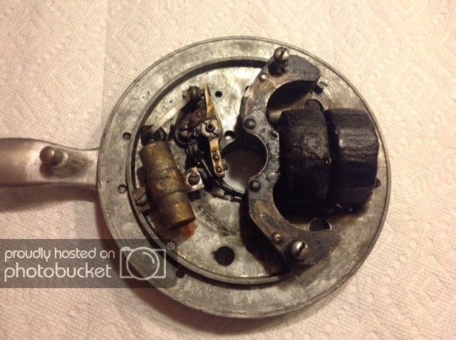

        Richard, I think you’re thinking of a different style Eisemann magneto.
        Mine is like the one in the photo, from this thread….
        https://aomci.org/forums/topic/neptune-1940-6hp-coil/
        Neptune-coil

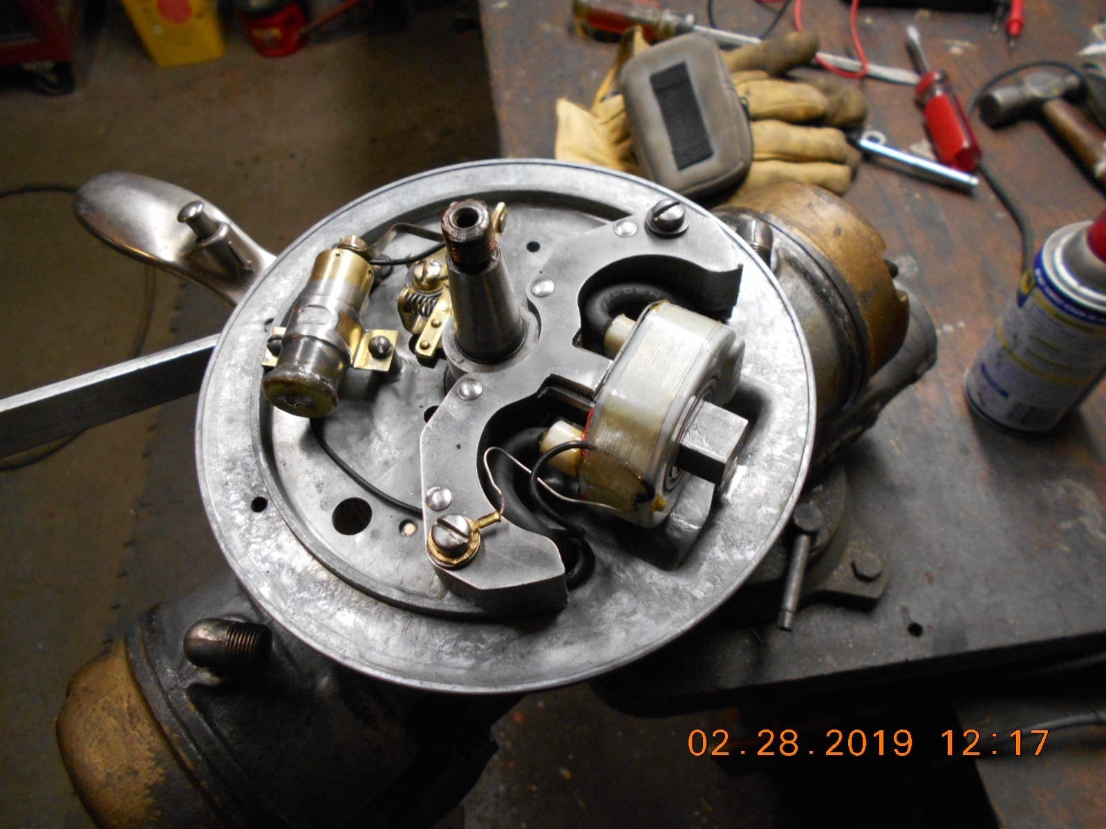

                  Here’s my conversion. Still not sure if my coil is “out of specs”, or if
                  I installed the coil “non optimally”!
                  The coil is a nice snug fit on the laminates, but I’m not sure if the orientation
                  matters?
                  DSCN7620
                  #169926
                  JOSEPH BRINCAT
                    Bucc, so what coil is that? looks like the Briggs twin cylinder ( the older points ignition system) .
                    And yes the JD Pony coil will work on the Eisserman 72 mag . Or a more costly option is buy a new reproduction Maytag twin coil ( $150)
                    Joe
                    #169929
                      Joe
                      Joe, as I first posted, indeed it’s a Briggs Coil……
                      “February 27, 2019 at 2:11 pm #169792Edit Reply
                      I attempted to install a Briggs and Stratton 392329 (points / condenser style) coil
                      on my Neptune OB64A, twin opposed, 6hp, and have very weak spark.”
                      I’m going to obtain another coil the same, and check it on the Stevens for comparison.
                      Then I’ll know if I have a bad coil, or faulty retrofit.
