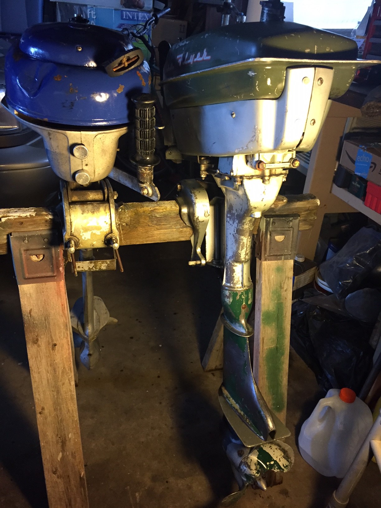

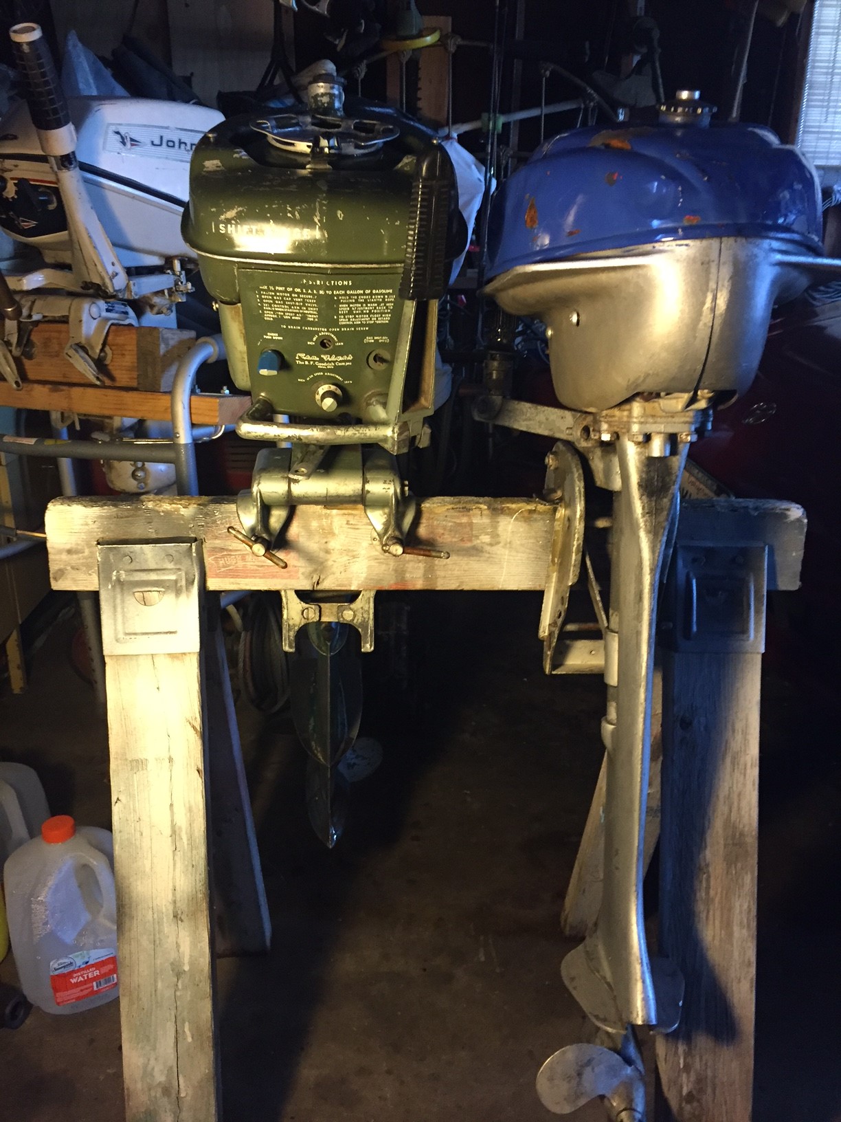

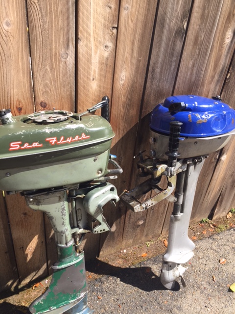

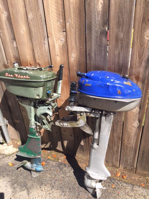

      Hello to all;
      About what year are these?
      I picked up these two today, after a modest drive and $100.
      I posted pics earlier, and seem to remember being informed that the "Sea Flyer" is a Champion, and the one with the rattle can blue is a Scott-Atwater.
      Time will tell if they’re runners or wall hangers, but I’m fine w/ that. The blue one has no serial number plate that I can see on the transom mount; haven’t taken the cowlings off yet, which should be interesting.
      I’ll appreciate any info or opinions anyone wants to share. I’ve done a ’57 Scott-Atwater 16hp, B-A-M, and it ran great. Otherwise I’m pretty much an OMC guy. But, I enjoy all older machines and look forward to getting into these. I hit ’em w/ the garden hose, and wiped ’em down with Tri-flow,but that’s it so far. Get to dump really old fuel out, next, and see how much rust is in the steel gas tank.
      Both turn feely, but look to have been left outside for a few years. We’ll see what the compression test says, and go from there.

        Alan, nice catch! I have the "Voyager" version of the Champion 4.2 hp.
        I believe they were sold thru hardware stores in the mid-west.
        Your Sea Flyer was sold by the BF Goodrich tire stores.
        There’s also a "Majestic" version, but I can’t remember who sold them.

          Your model # is G3LGS. That is either a 5 or a 5.5hp motor with full gear shift. The rubber impeller is located on the driveshaft above the gears. I have a 1953 Voyager V3LGS motor and it runs very well. I took a honda impeller and made it work on this. Do you have the recoil?

              I believe the blue motor is a Firestone built by Scott Atwater. Sea Flyers were built By Champion in 1953 & ’54. . . 😉

                The Champion built motor has a restrictor( half circle) in the manifold behind the carb. This can be opened up to allow for the motor to develop 7 1/2hp like the Champion model. Quite a fast 5 1/2 then.

                  Info appreciated!
                  I’m glad to know where the impeller is, and to know I can adapt a modern one to work.
                  No recoil starter, unfortunately.
                  I’d be happy as a clam at high tide for any technical info like a manual, or even an exploded drawing.
                  So, one was sold by Firestone, and the other by B.F. Goodrich; interesting and amusing.
                  Anyone have a guess as to when the Firestone / S-A was made? About the same era, (early / mid 50’s)?
                  If the BFG Champion wants to run, I’ll think very seriously about pulling the restrictor plate, and gaining "free" HP. Love that.

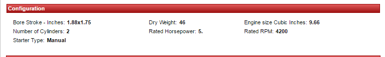

                  I haven’t dug very deeply, but below is what I’ve found on the Champion, so far.
