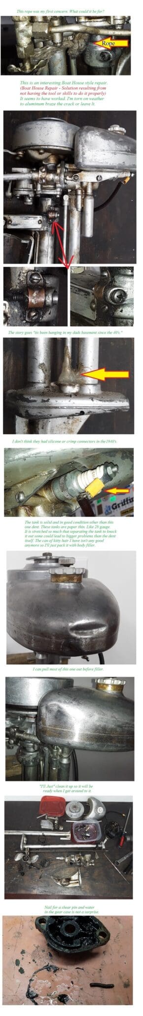

      I had my winter schedule all set and then this thing showed up.It didn’t look very promising but still has value as there is a strong demand for parts. I can get most of my money back if I cant get it running. These things almost always have a bad coil and often are so worn out they will no longer run. I have a Mate that is a wall hanger that after I modified a coil for it, it wont run. I set it aside with the intent of  NOT starting on it till the other projects were done.
       “I’ll Just” spin the flywheel. Compression feels good.
      “I’ll Just” give it a quick look to see what needs fixing should I need to start looking for something.
      N

          Tubs, I have had good results filling in small dents with JB Weld then putting a skim coat of body filler.
          Bob D

                It’s a 1/2 hp Elto Cub. Going by the serial number it was sold in 1939. Tubs
                Bob D
                JB Weld is a way better idea than anything I was thinking. Thanks Bob, Tubs

                    and JB can fix up minor  skeg breaks 🙂   cheaper than a 400$ snow job… held up real good all summer  … not good for rocks of course 🙂
                    buffed it and painted it and  looks a lot better  and for 15$ I can  always fix it again 🙂
