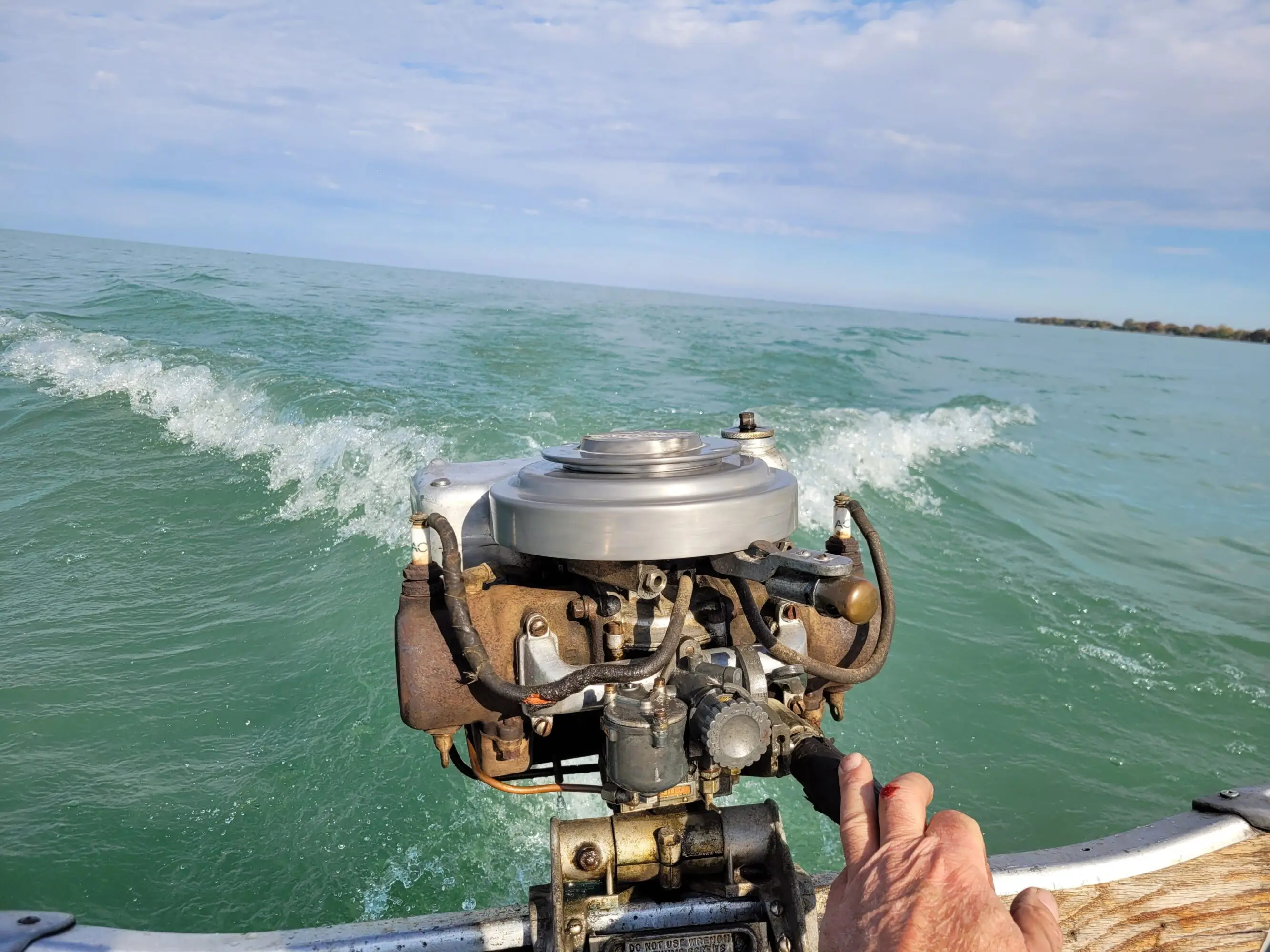

          I have a model R and it runs pretty well, so its worth putting some effort into.
          20231023_151306
