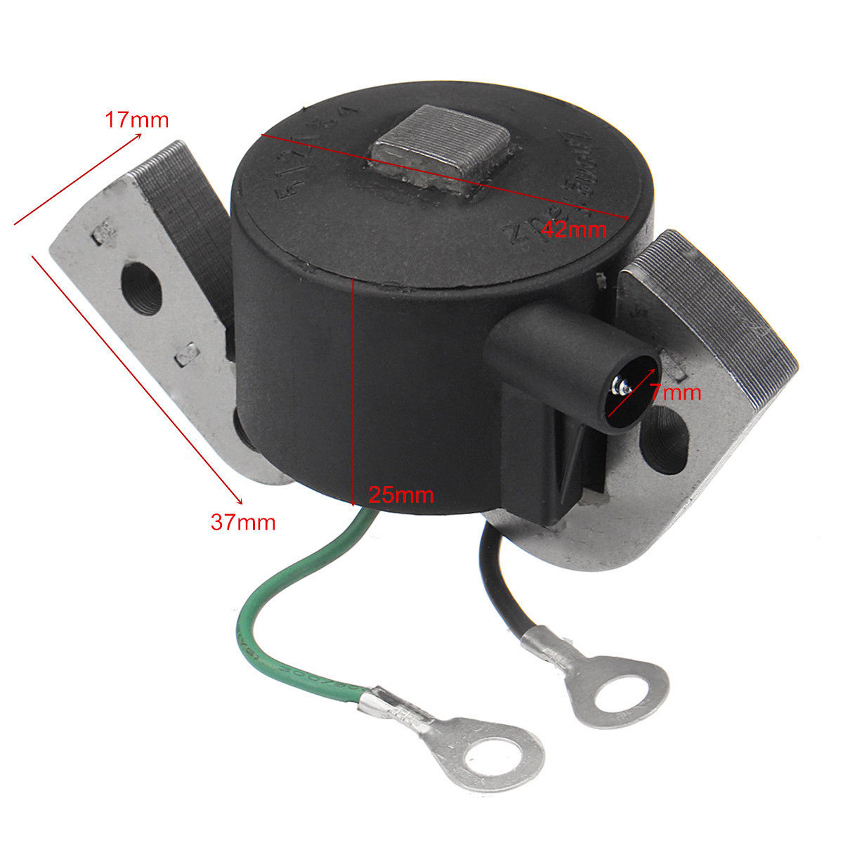

      Just got a couple pairs of new OMC Magneto coils from Ebay. From: joystartshere
      Wonder if anyone has used these. So cheep I had to order some.
      Milwaukee Member Phil
      #74182
      twostroke
        I’ve used a bunch of ’em. They seem to work fine, and they’re certainly cheap enough. I bought the last batch for $10/ea in a lot of 12.

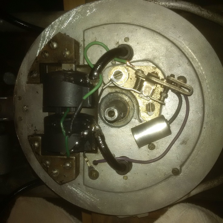

          I installed a pair in a 9.5
          they tested (electrically) OK…. good screw pin for the high voltage connection and they fired up good (good strong spark)
          can’t beat the price so I ordered up 2 pairs for my next projects. OMC square fuel pumps are cheap also so I fitted one on my 6R74 and will be doing some lake testing when this stupid temperature breaks .

            How are the windings attached to the laminate? Do they use the metal tab bent over to hold it or are they glued?
            Kirk
            #74218
              well… they look glued
              #74222
              kirkp
                Wonder if it’s possible to remove them when they are glued? Need some windings for a different set of laminates.
                #74233
                twostroke
                  They’re glued…..if you support the coil in a vise, they knock right out. I’ve got a set on modified original laminates in my soon-to-be-restored OA-55.
                  Jim
                  The coil conversion was done with Tubs’ guidance and instruction. It’ll fire at .100+ gap at hand cranking speed.
