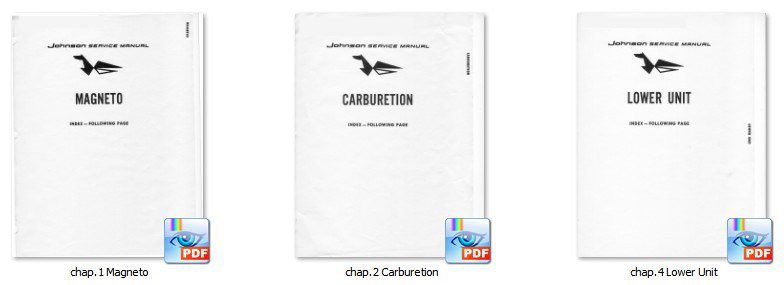

              I agree with CK, that’s how I learn the best too. As mentioned, videos and pictures help, as well as having it explained really well and thoroughly like some of the guys here do. And it doesn’t hurt to familiarize yourself with what the Service Manual says either. Here’s a link (good for a week) to download a few of the chapters.
              When you click on the link you’ll see an option that says “Preview” and you’ll see each individual chapter that you can download as a separate file. Or if you click the blue oval “Download” button it will download all as a “Zip” file that will need to be “Unzipped” or each file “Extracted”…do whatever you’re more comfortable with.
              https://we.tl/t-J25e0yg7GH
              3-chapters
                        3-chapters
                        Steve
                        Those manuals look very interesting, anyway to download them?
