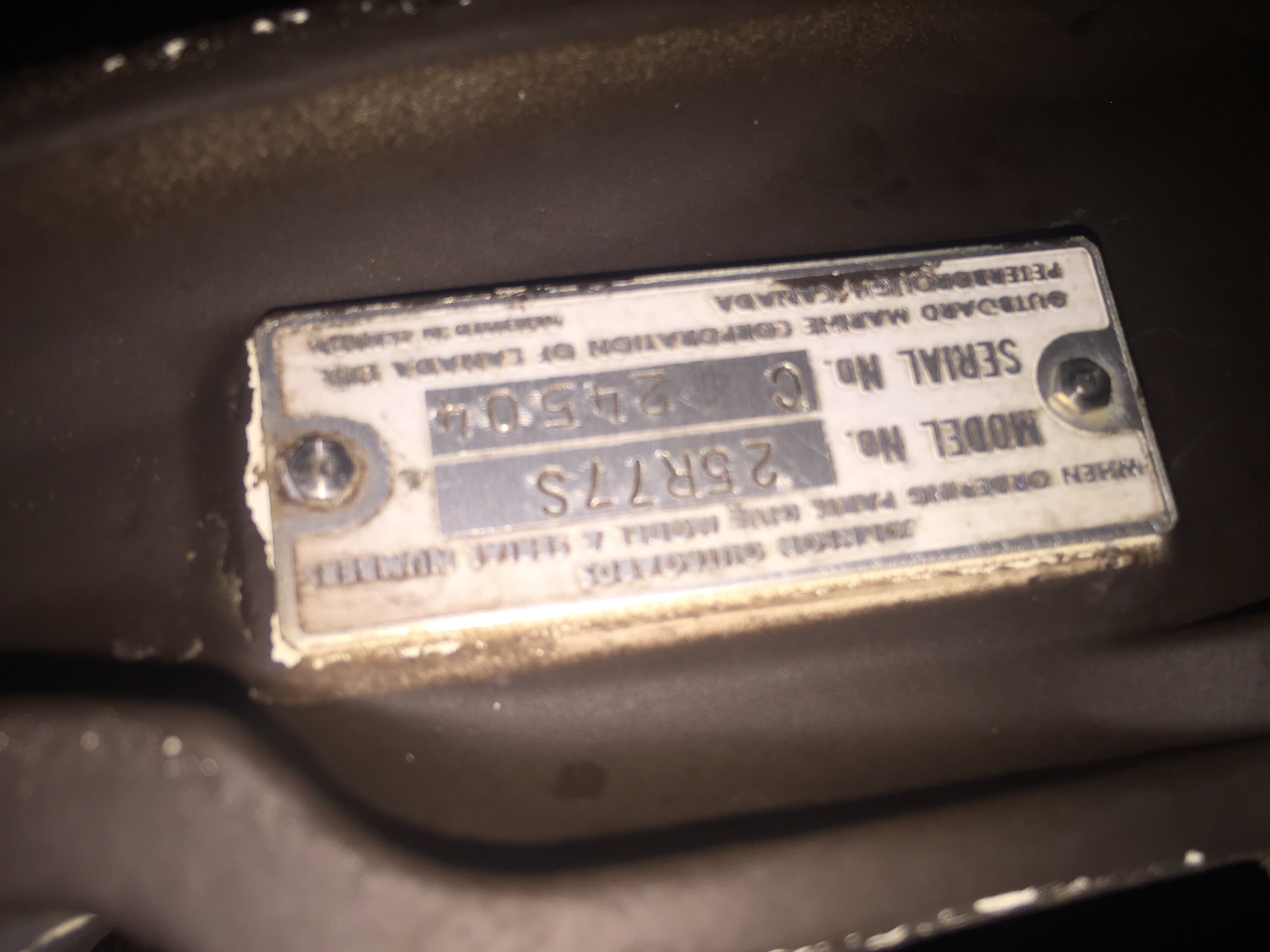

      I’ve recently obtained a new to me 1977 Johnson 25hp.

        Looks like your engine was manufactured in Canada. These are fairly rugged engines, but don’t idle as nicely as models from the 50-60s. The CD ignition is fairly simple and easy to understand/repair. The cooling system can be difficult to service, and watch out for worn clutch dog/gear lugs, replacement parts are very expensive.
