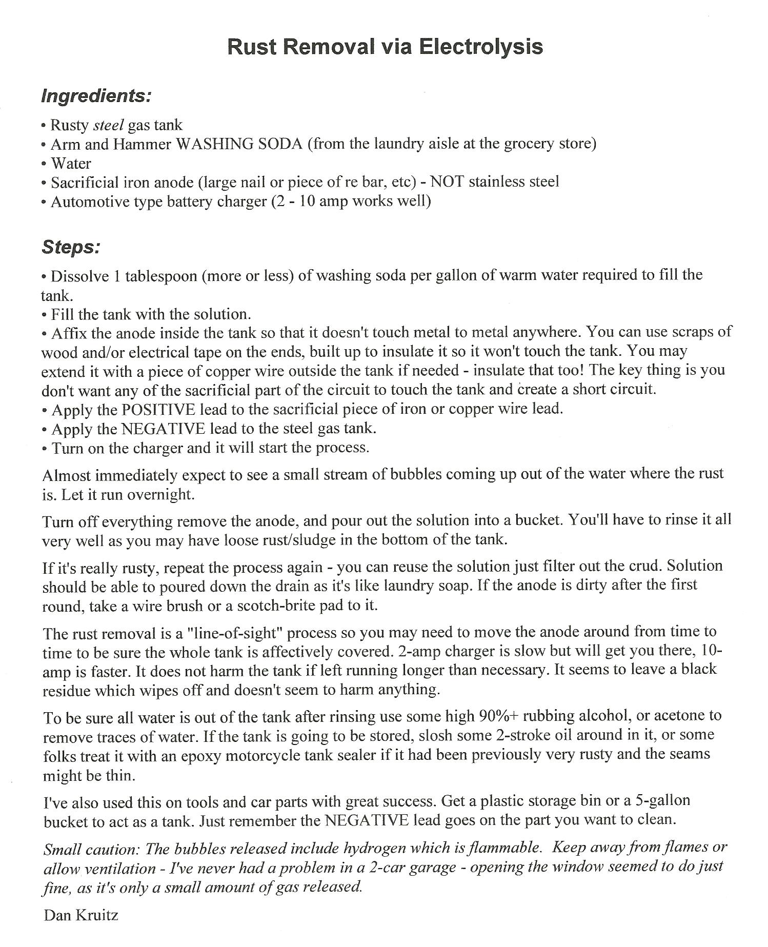

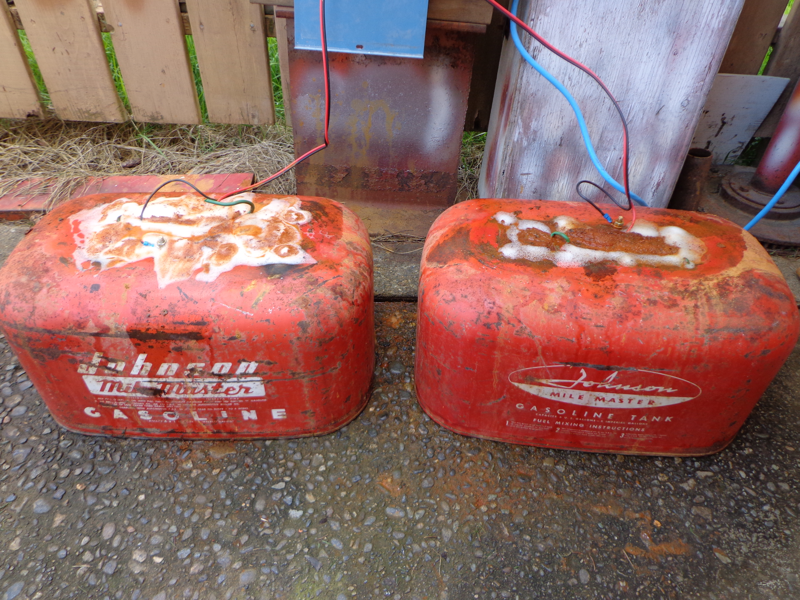

                  My meathooks will barely fit into a tank and when they do, I pay for it with the hide on my forearm all torn and bleeding. Being a bit wiser in my old age now, I use a stick with a cloth to swish around inside a tank or I bead the inside.
                  Here’s some info by Dan Kruitz on using electrolysis to remove rust. It works well and with the three bank charger, I can do three tanks at once!
