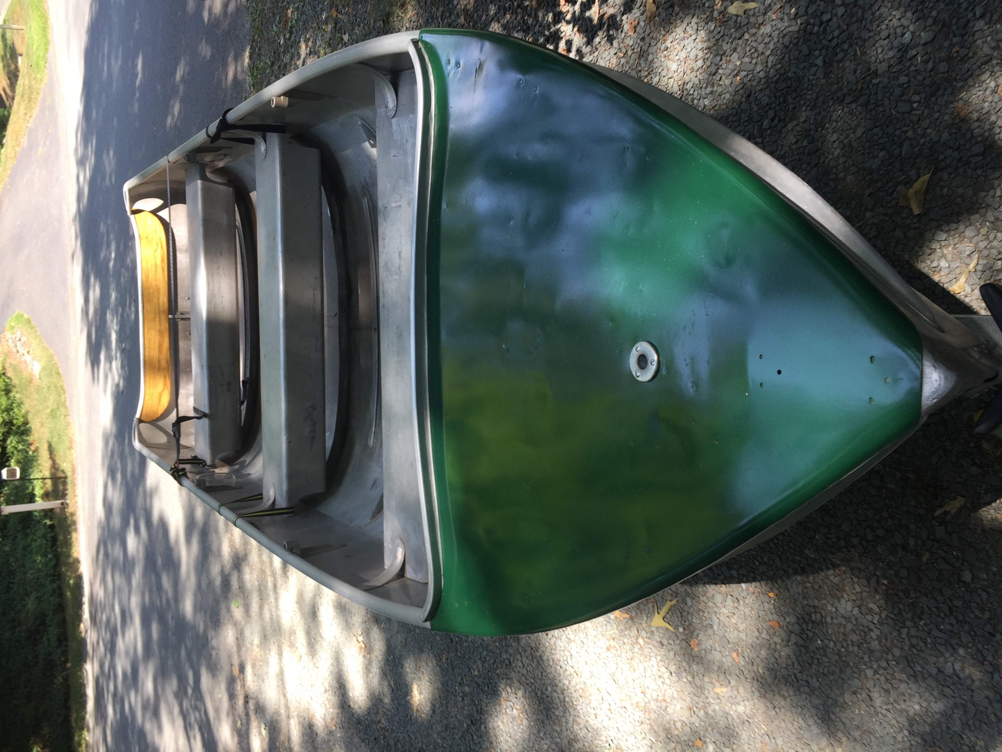

    I am thrilled to be here! Yesterday I bought an
    Excellent 1955 Alumacraft model F.. 14′ with front deck, new white oak inside and new marine plywood outside transom with stainless fasteners. New original style drain with chain and new decals. Metal is very straight. No holes in seats. It is ready for the water… fish, fun or show." That was the direct ad from the awesome previous owner who also sold me an awesome 10 HP, Johnson motor and gas tank. I already love this boat.

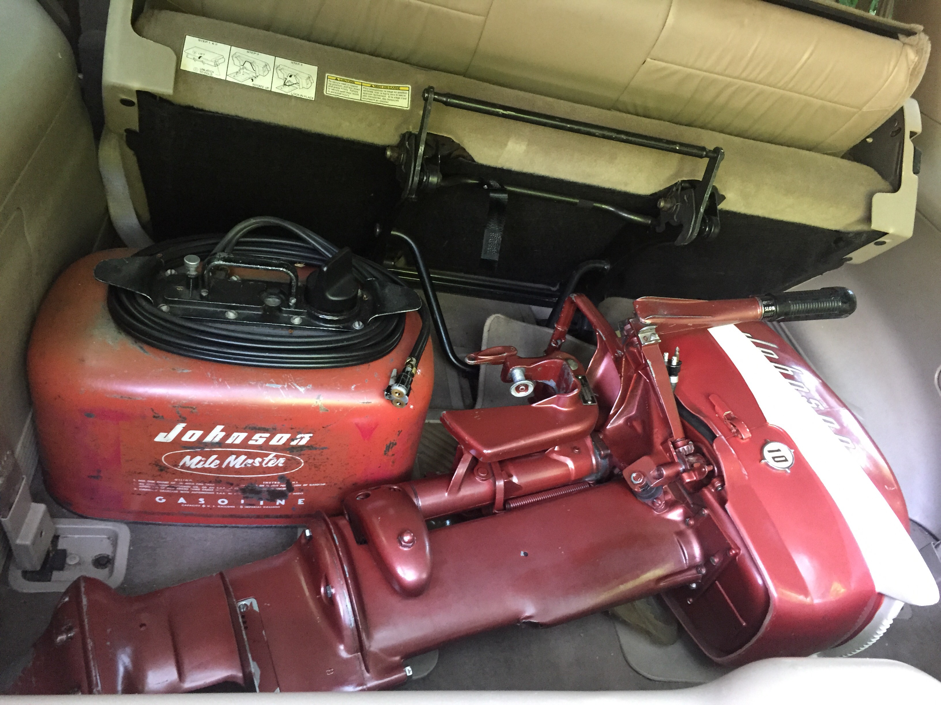

        Thank you! Yes, I would be after a deck, too, though the gentleman I bought it from had a cool steering wheel on an aluminum clamp for a side mount. I looked all over eBay last night, and I couldnt find any drum steering wheel kits. Im not sure I could mount one in the front to the front deck since it doesnt have the middle mount portion, instead, it is more flat…? Not sure of model of 10HP Johnson…I will check. I added two photos.

        vintin
          If you can pick up a side steering console you will be a lot faster on the water with your body weight more towards the rear. I wouldn’t cut into the front deck for a wheel! A friend of mine gets 24 mph with an 18hp tiller steer in an Aluma Craft FD. Your boat is lighter. Put the side steering console so you are sitting on the rear seat. Just my opinion.

              David Stanton
                Your good lookin’ 10 HP is a 1956. Good motor. Don’t skimp on the oil, as the old 10’s were known for rod bearing failure – use 25 to 1 mix.
