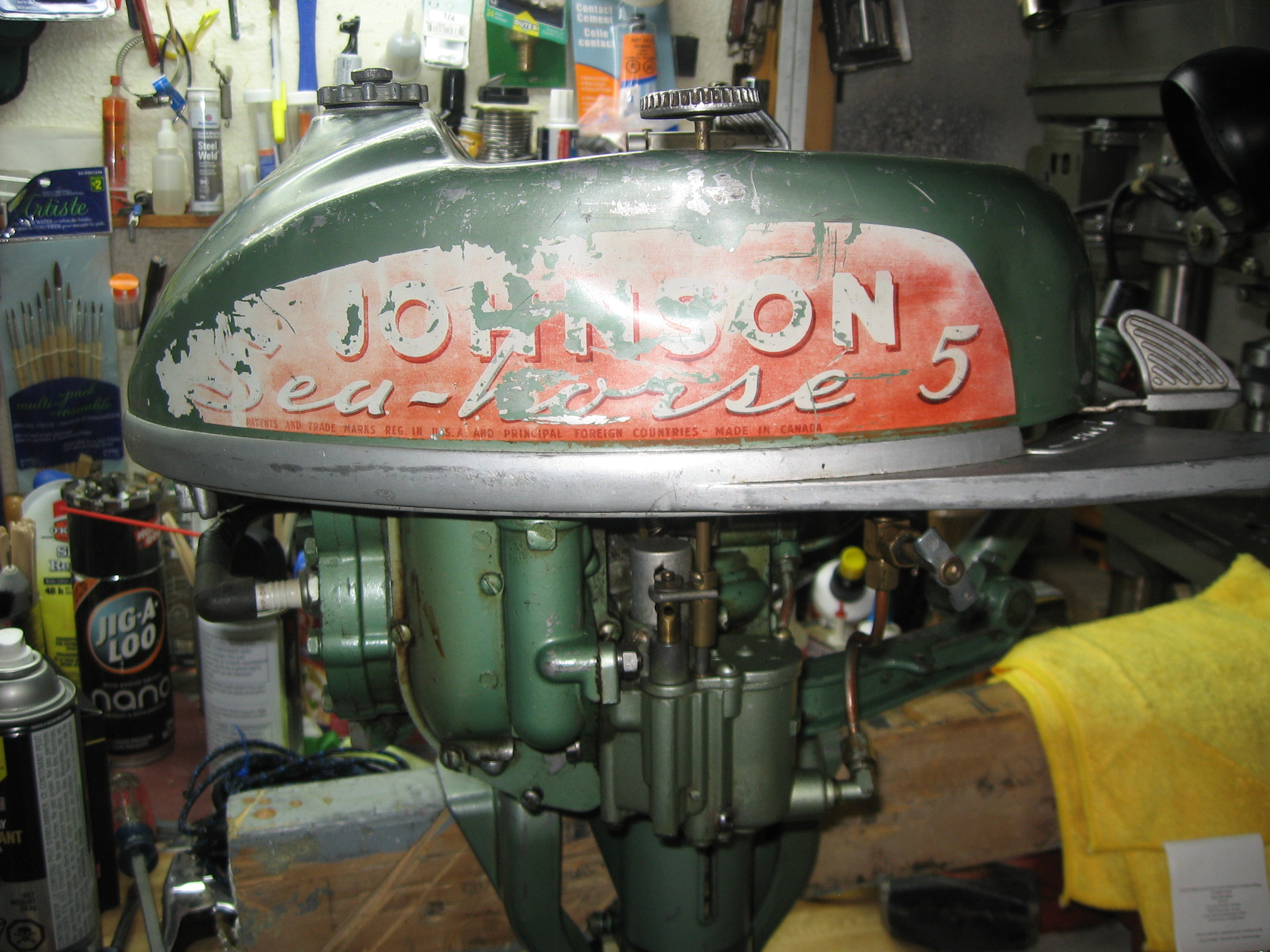

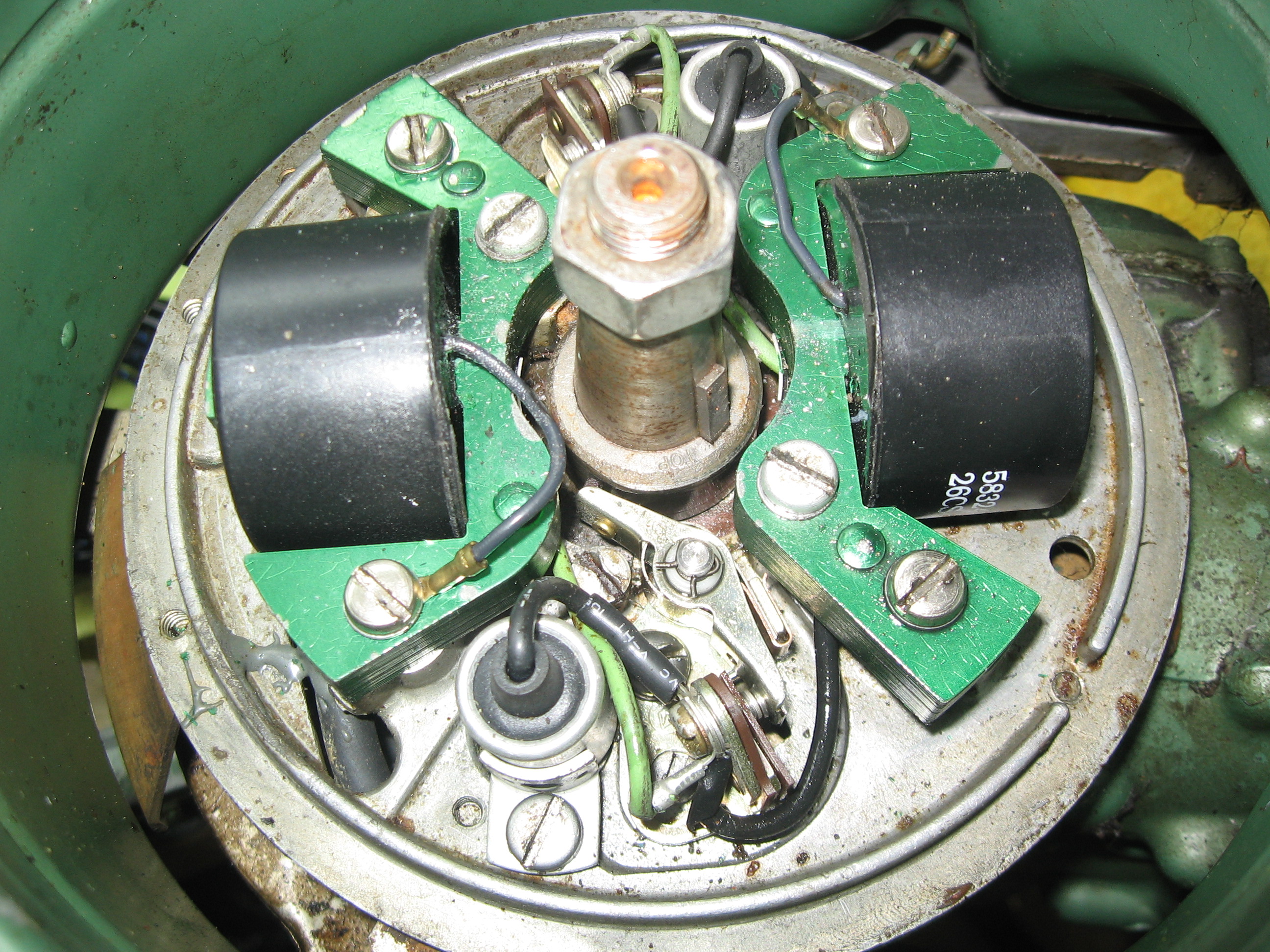

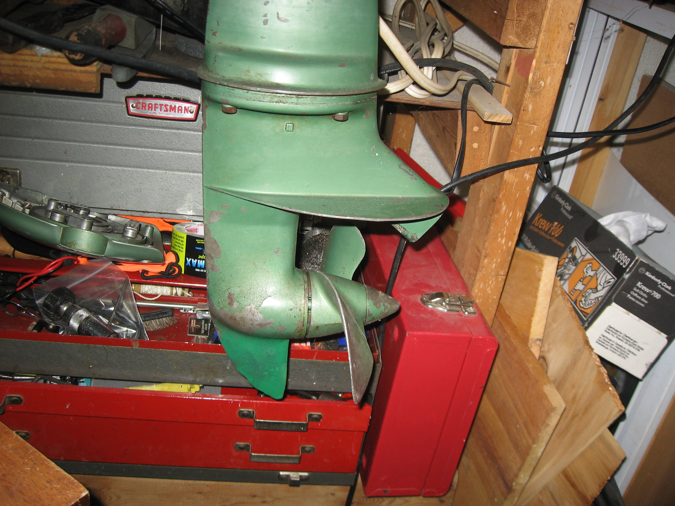

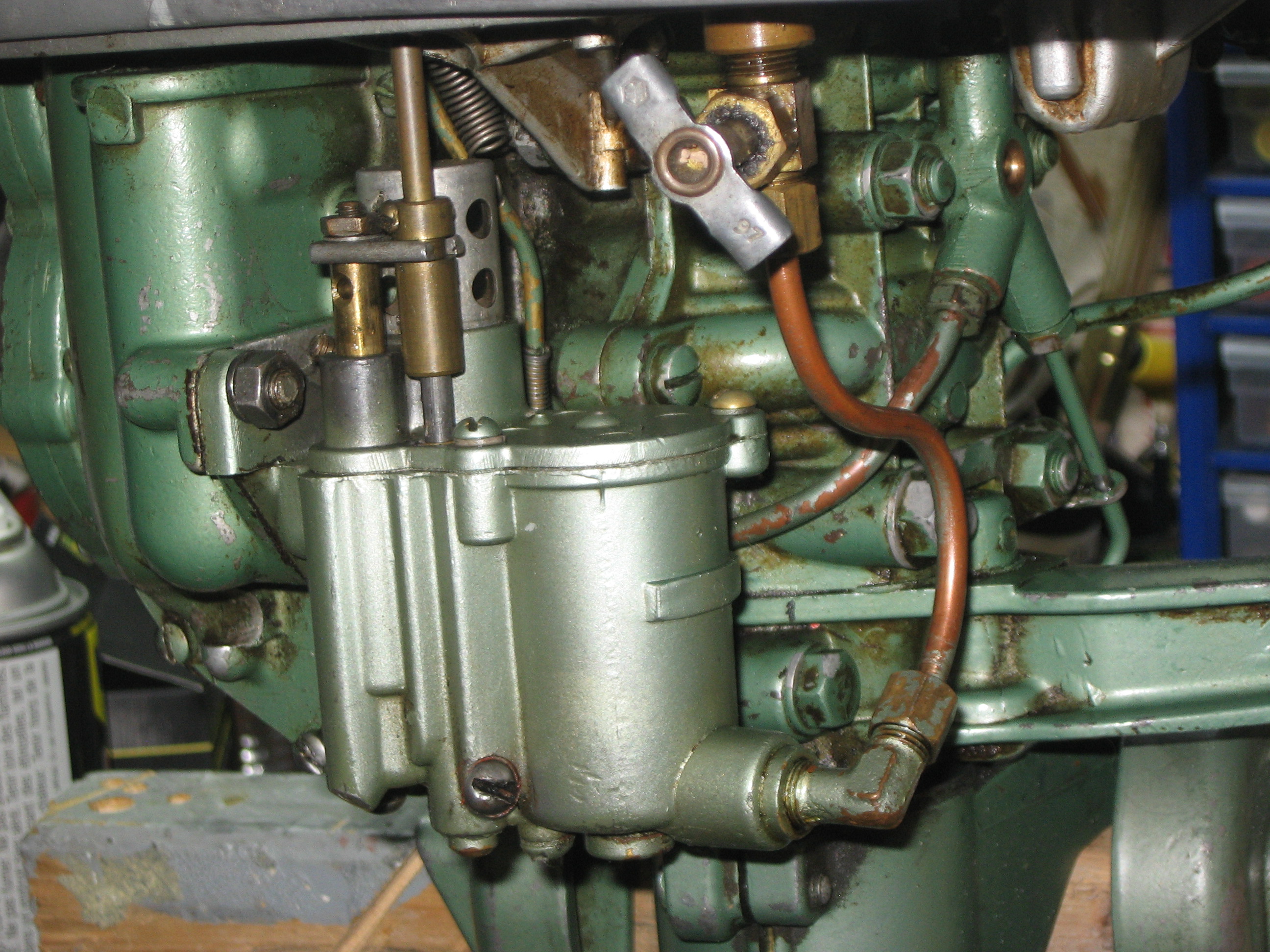

          here are a couple of pics. aside from worm decals, bumps on the tank the rest is kind of pretty good. skeg prop & all
          I’ll clean up the mag plate from scratch, add new plug wires etc…
          I need to pull the impeller and find a replacement I think the rest will be just fine
          #67083
          fisherman6
            Looks good. Be careful of the ground wires on the coils. The one on the left already looks like it has a little flywheel wear from the hub rubbing it. Good luck with your motor. It’s a very clean looking example under the cowl.
            -Ben
            OldJohnnyRude on YouTube
            #67084
              thanks aside from some negligence on the tank (bumps) the owner said it was in running condition and based on the fact the coils got changed it is probably true…
              the coil wires were not tucked away as they should have been but no arm done except some chaffing . maybe.. maybe they had some ignition trouble ..that green wire also looks close enough to the cam to rub… it is to be rerouted anyway
              i need to trace those black wires on the points ??? maybe a kill circuit ?? tbd

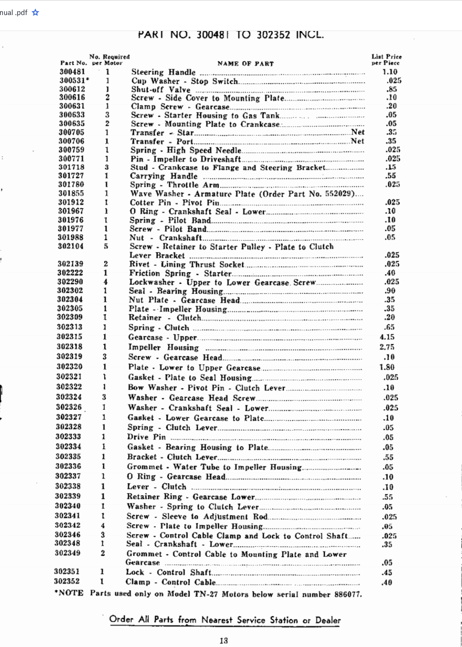

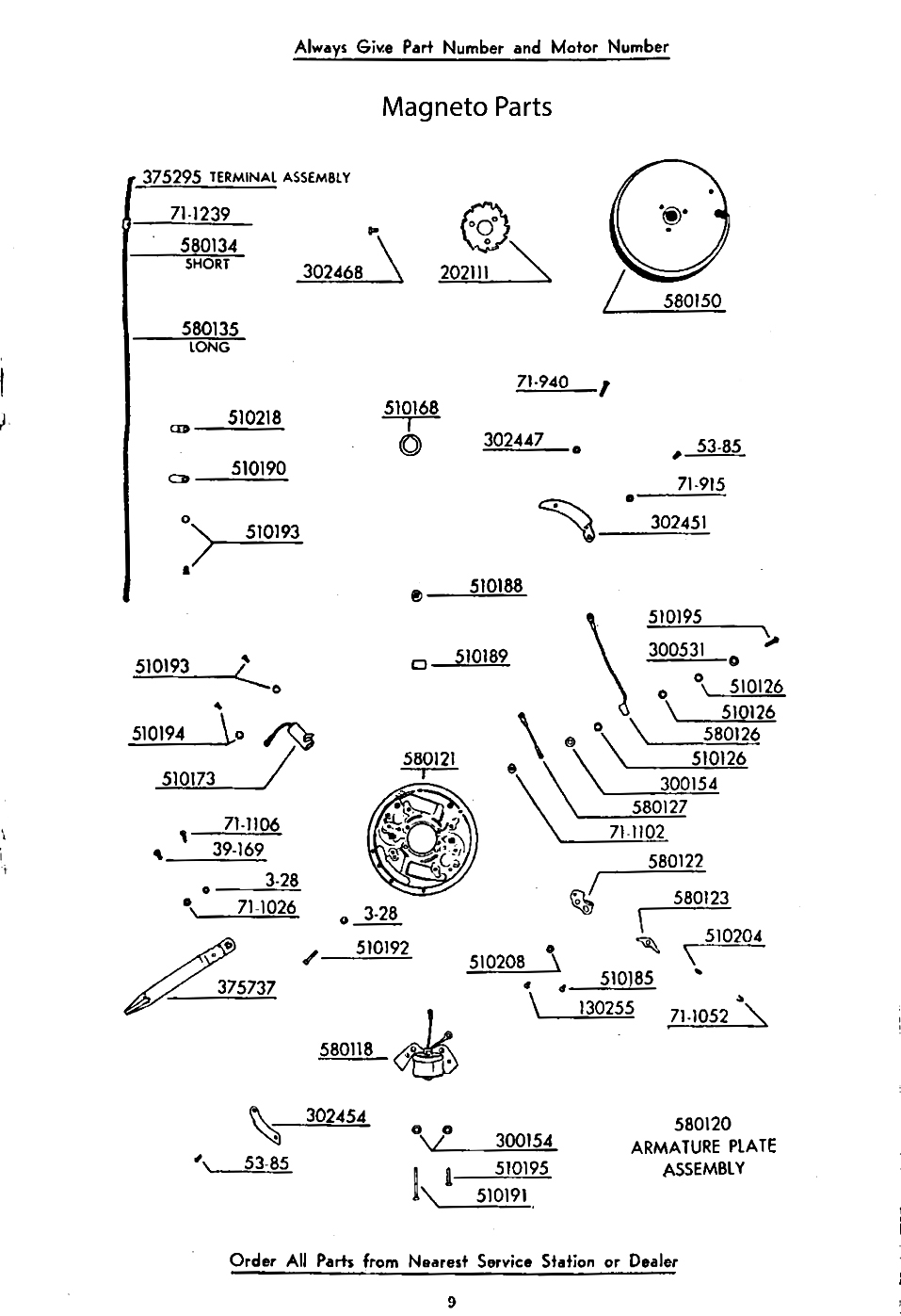

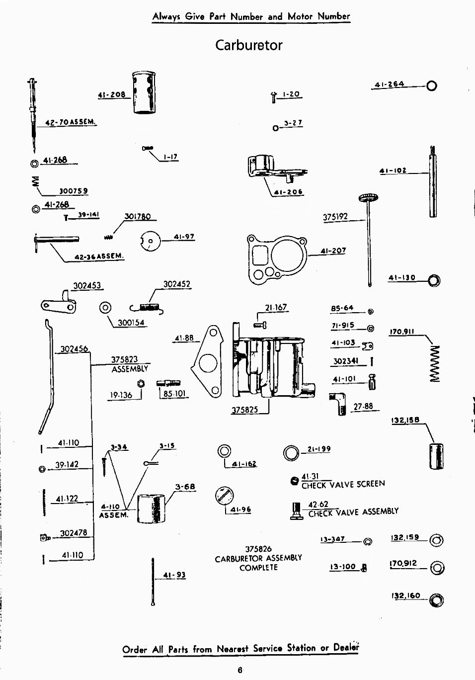

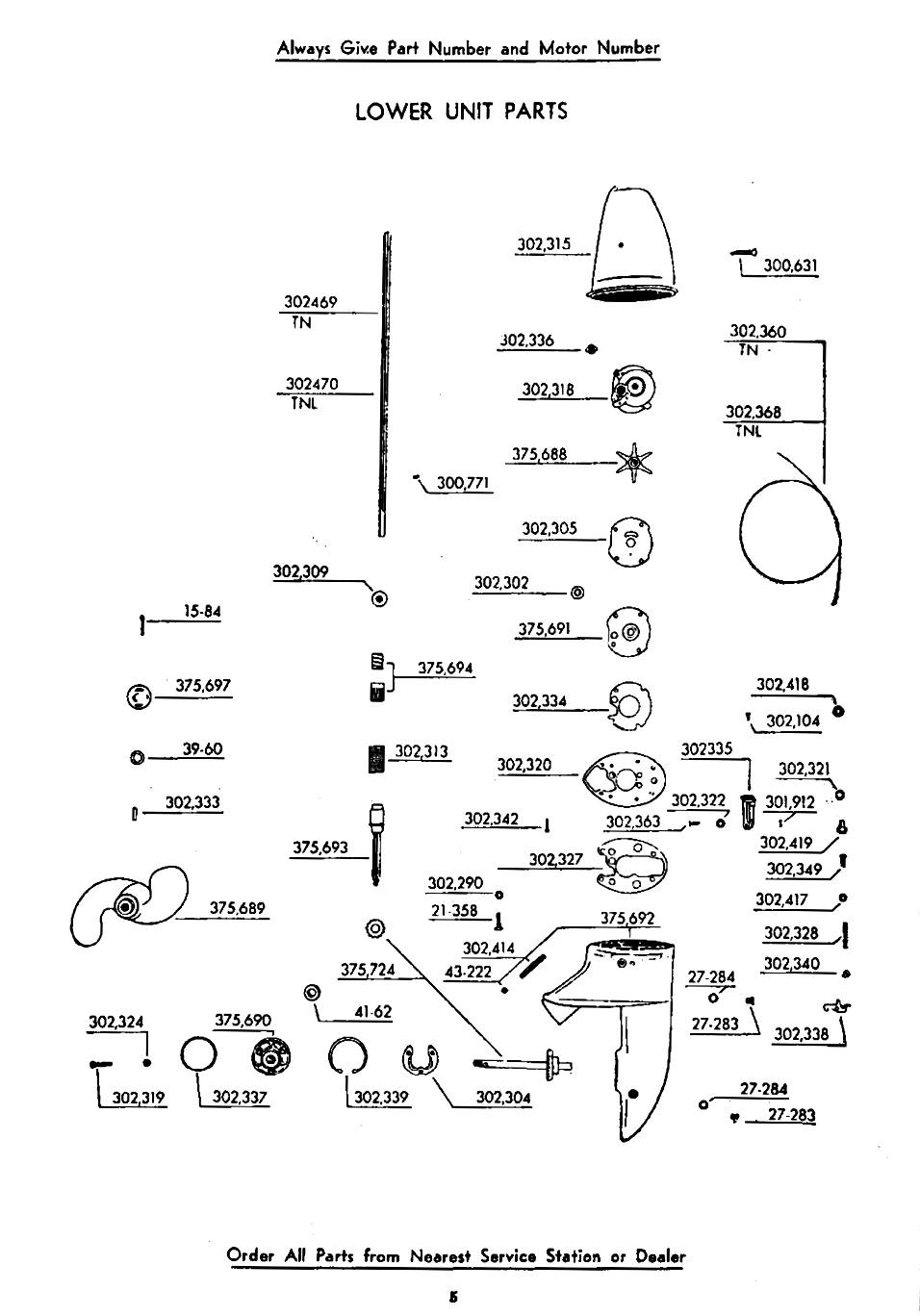

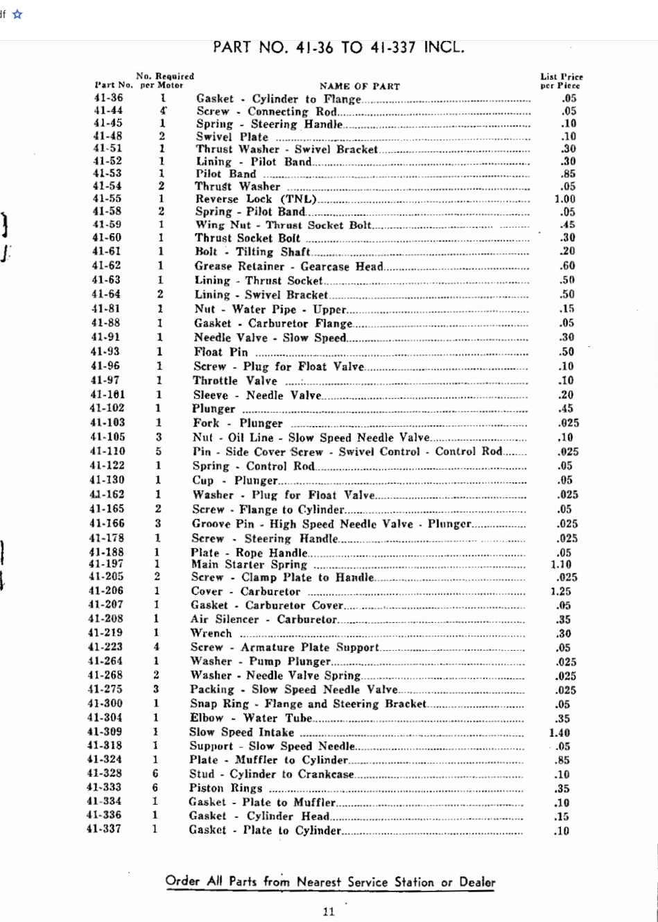

                  Anybody have a parts diagram they like to share ?

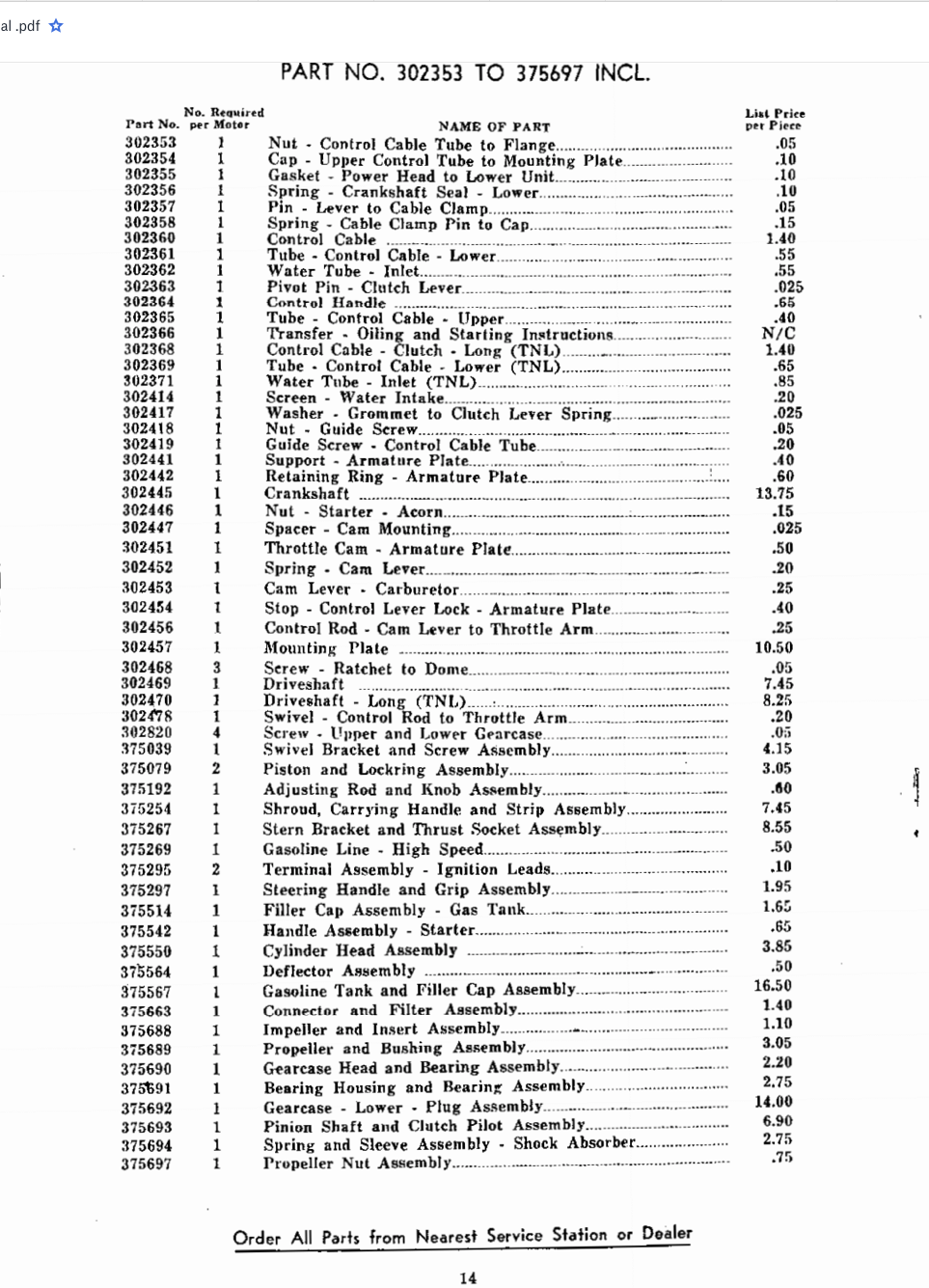

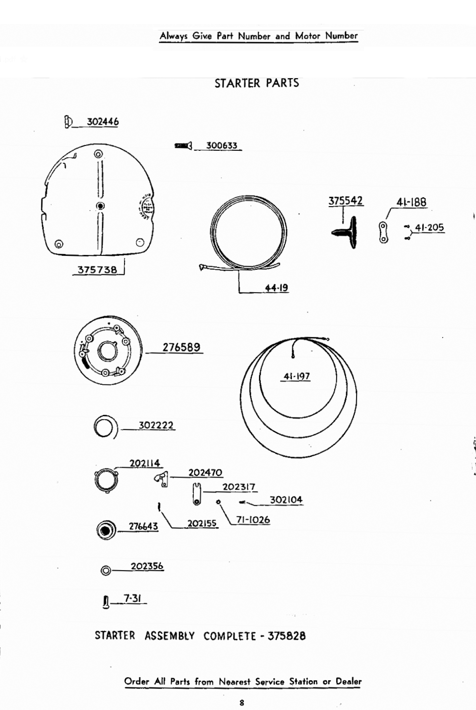

                  #67291
                    Try this . . . πŸ˜€
                    More to come –
                    #67292
                      And the rest of the story . . . πŸ˜€
                      Prices subject to change without notice – – – πŸ˜†
                      #67294
                      hag
                        Thanks Garry!
