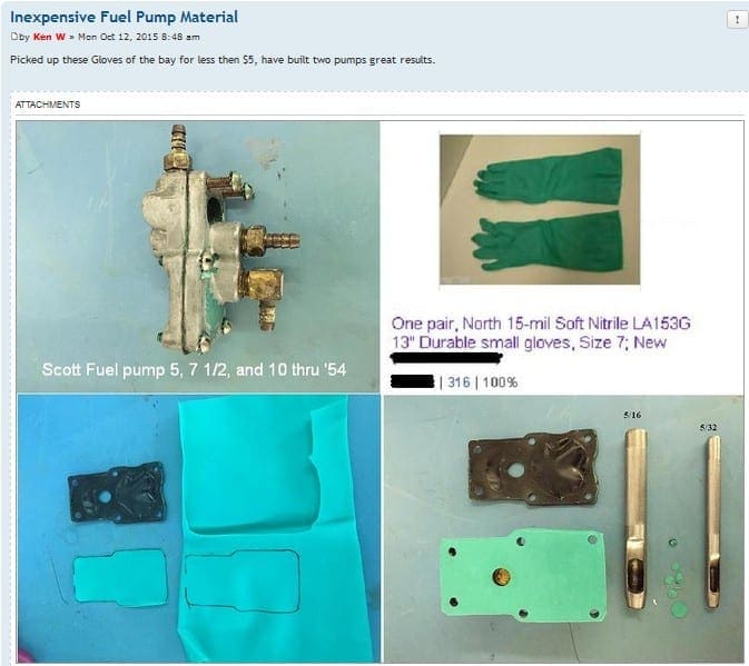

      has anyone ever tried to cut up some nitrile gloves to cut up some diaphragms for the OMC square pumps
      the 2 pump diaphragms look easy enough to reproduce being about 1. 25inch square of nitrile with a few holes
      does it resist ??

        That’s an interesting idea. There are many types of nitrile sheet for sale on the internet. The thin black disposable nitrile gloves probably would be too thin and they don’t seem to be all that fuel resistant anyway. You will need to find the right composition, thickness, and hardness (durometer).
        Buna-N nitrile is used for the pressure tank connector o-rings, and also for the spaghetti seal in the gearcases of the 50’s and 60’s motors, so that might be a good starting point.
        Thickness is easy enough to determine if you have a sample to check.
        Hardness or durometer- comes in numbers like “60A or 70A” hopefully someone with more knowledge can help with this.

          It has been done before, a member of the AOMCI once posted it On ask a member, II don’t remember the details but he said it did work

              Sure you can use gloves. I have used them and I can vouch for them if you have a simple fuel pump with a no-nonsense diaphragm. I bought mine off of ebay; referenced by an older post here. I can’t seem to find that old post right now….but here is a link to the seller:

                  I think this was the original older post mentioned that Ken W first posted a few years back. After seeing that I bought some and used them on the early OMC fuel pumps and they seemed to work fine. I soaked a piece in ethanol gas for more than 6 months and it held up fine. But one of the comments made about those was that they aren’t reinforced like some diaphragm material is and long term might be a problem. Ollie’s is always a good option.
