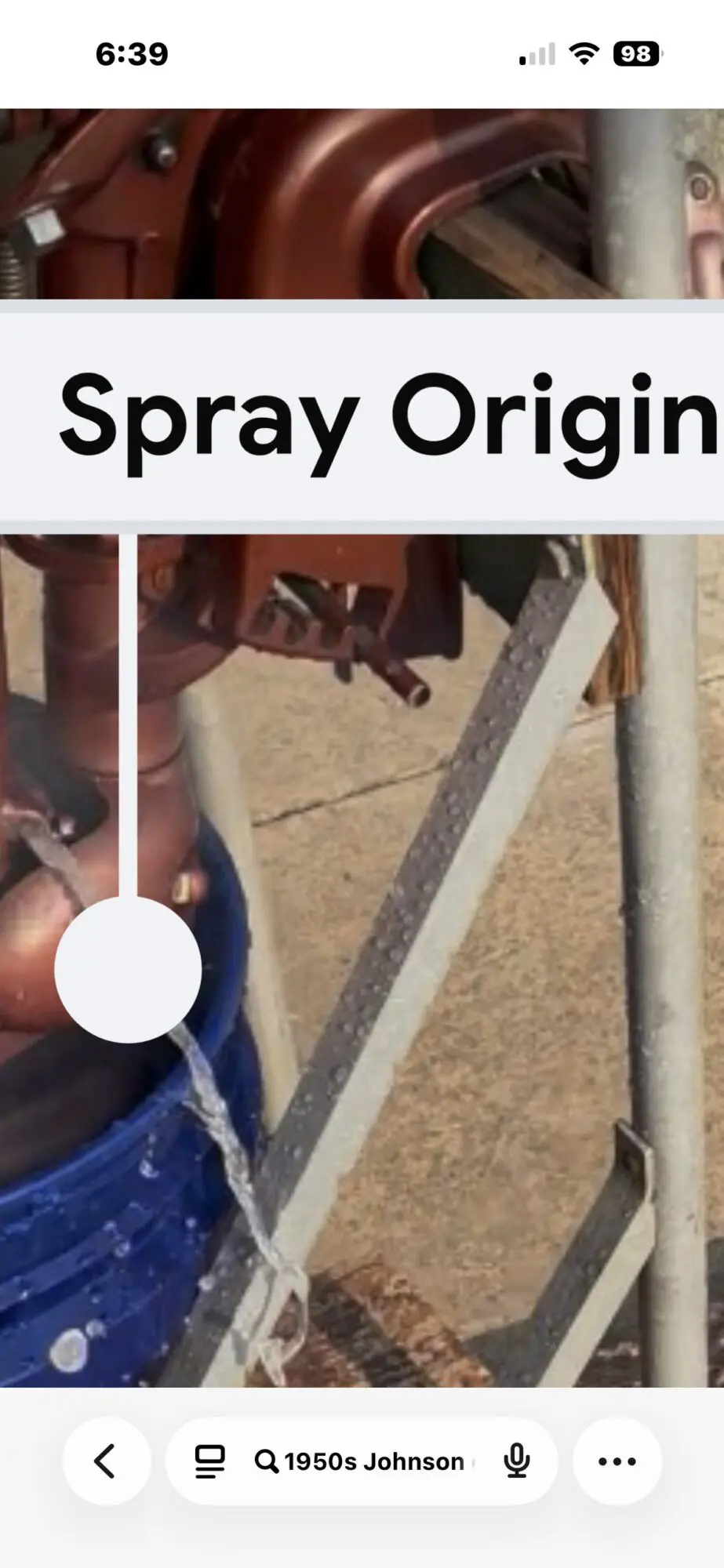

      This is the picture I took, and where the water is coming from is a hole in the side of the lower unit
      IMG_1519

          Yes, water discharging there is normal.   From the stream of water that is discharging, your water pump is doing a good job.

            Thank you for the quick response, this motor has been dormant for 11 years, I just wanted to make sure that the water pump was good.
            I made a good call. The old water pump has taken a set from lack of use.
