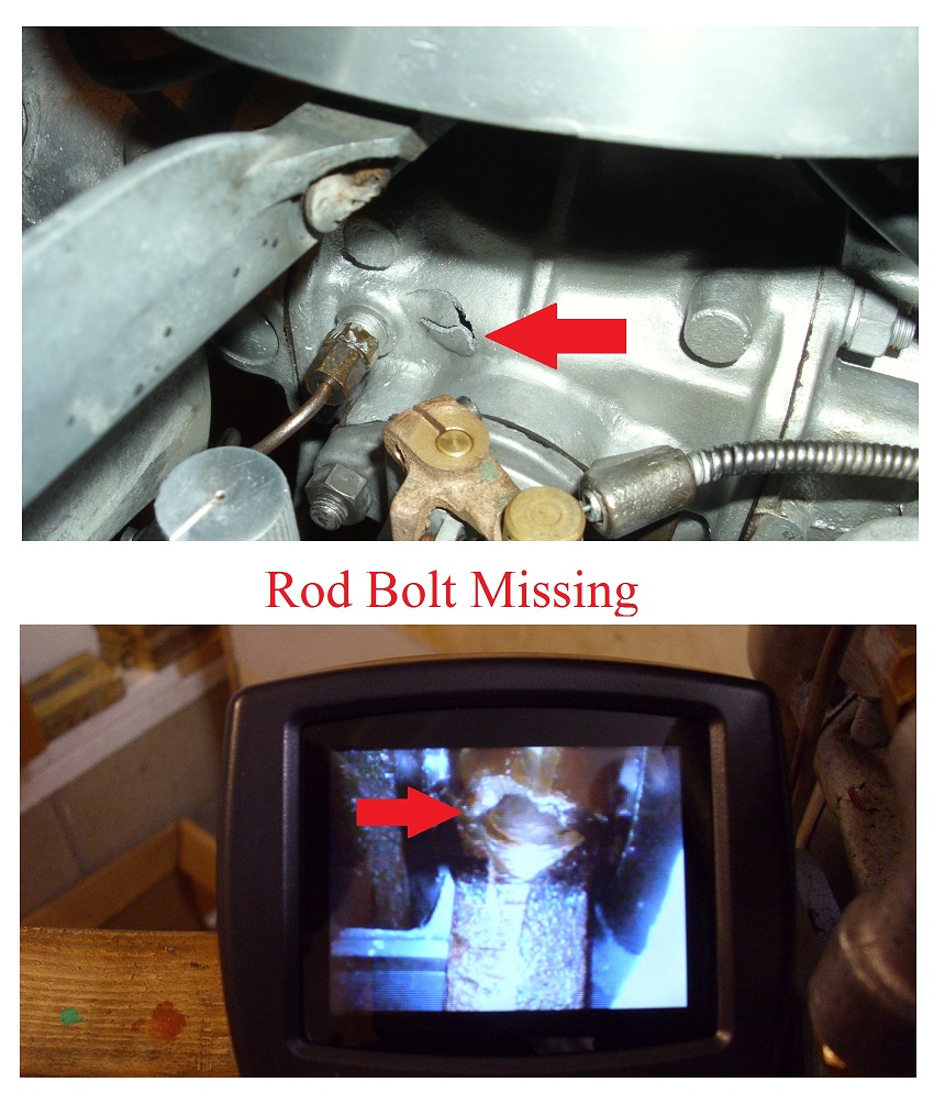

                    #85092
                      Well it is possible that the screws have loosened in a connecting rod cap. If that is true, it won’t be long till the rod sticks through the side of the case, where you can see it.
