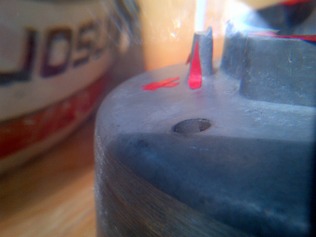

          My ’77 Johnson 2 hp sounded exactly the same at that rpm,that deep chirping.The noise would go away at higher rpm. With no other 2 hp to compare it to, i figured it was its own normal little noise characteristic. I could not get it to run right ,the compression was a bit low. Had it miced by a machinist,the cylinder is worn in the center.
          I did notice there is a scrape /wear mark on the flywheel top as i recall,like something is rubbing. I will try to dig the flywheel out and post a photo of its wear mark.

            quote pugetsoundboater:
            The scraping marks are from the wobbly starter pulley rubbing on the flywheel, which makes terrible noises that sound like internal engine problems.

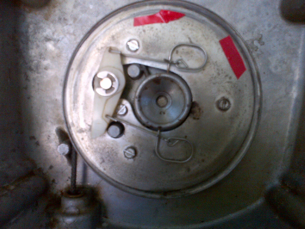

              #58856
              PugetSoundBoater
                Here are some photos of the flywheel scrapping marks ,just like it was put in a lathe.
                I think fleetwin may have the answer for this wear ,a wobbly pulley. The distance from the center of the flywheel to the wear mark is the same distance on the pully from the center to the edge of the pulley. The wear marks are right outside the bits red tape
