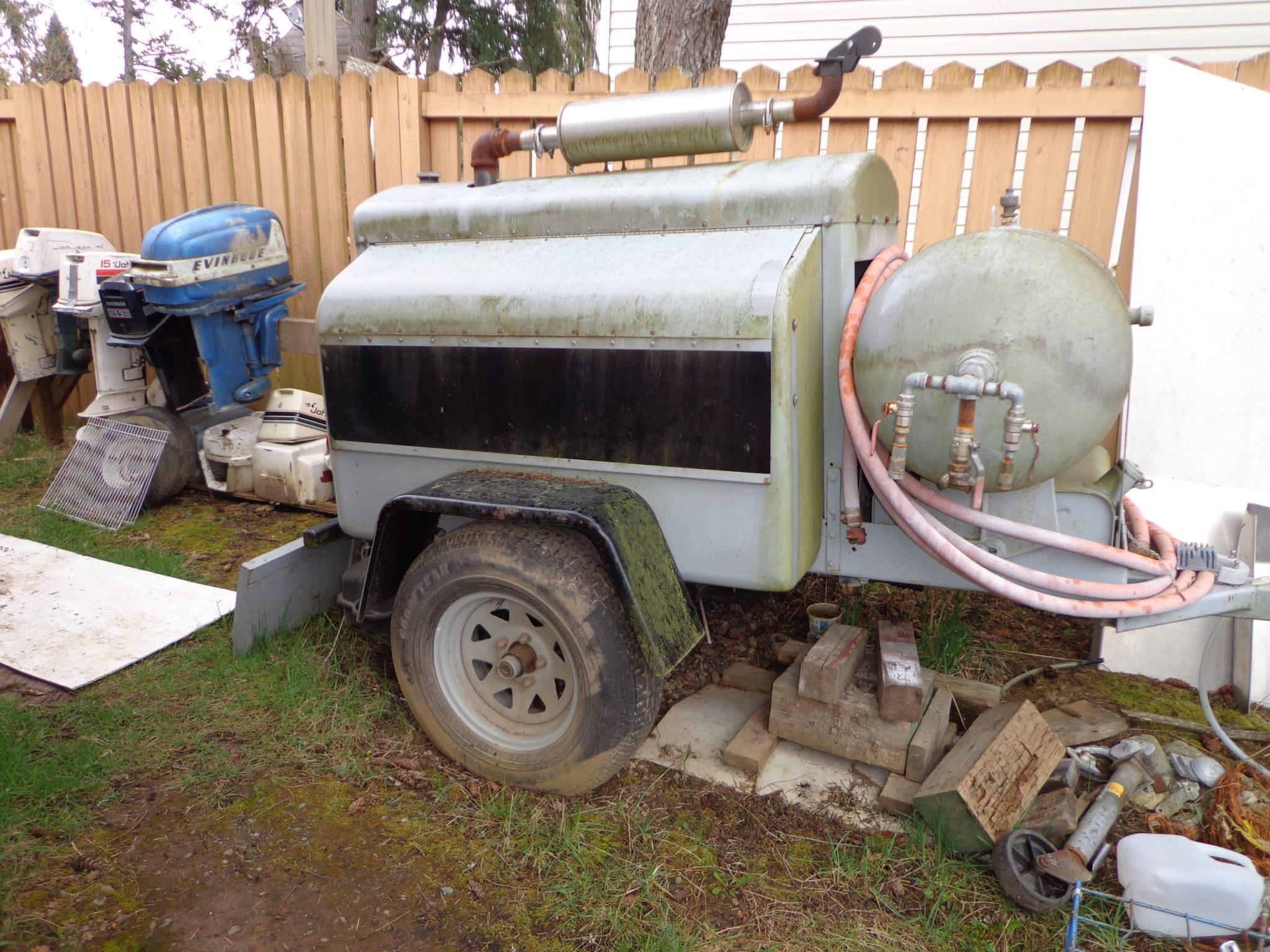

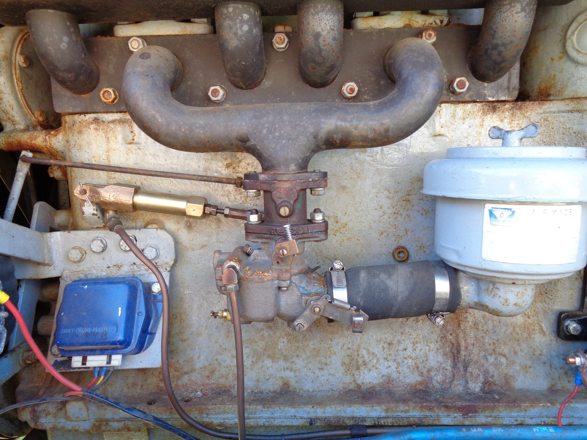

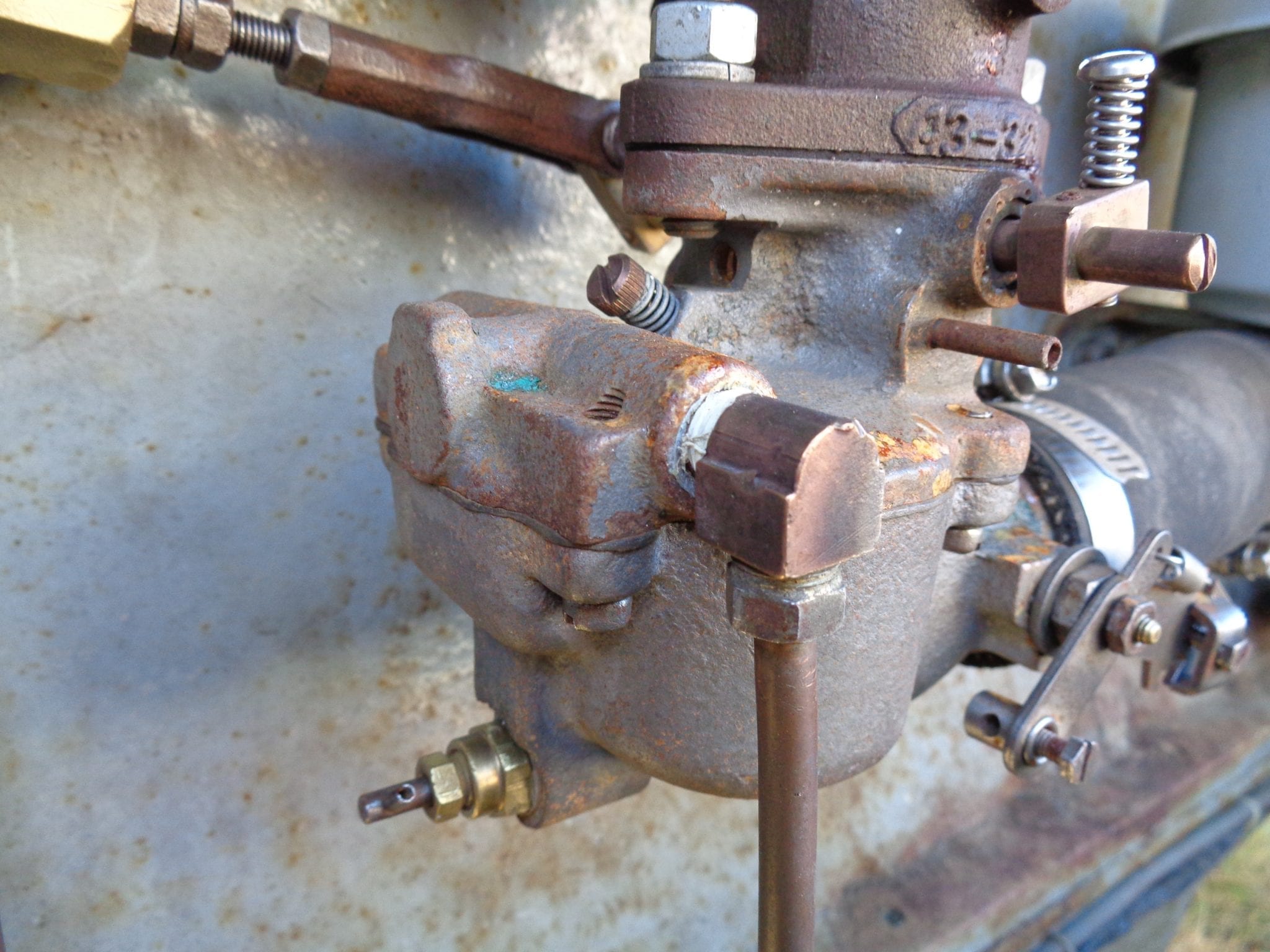

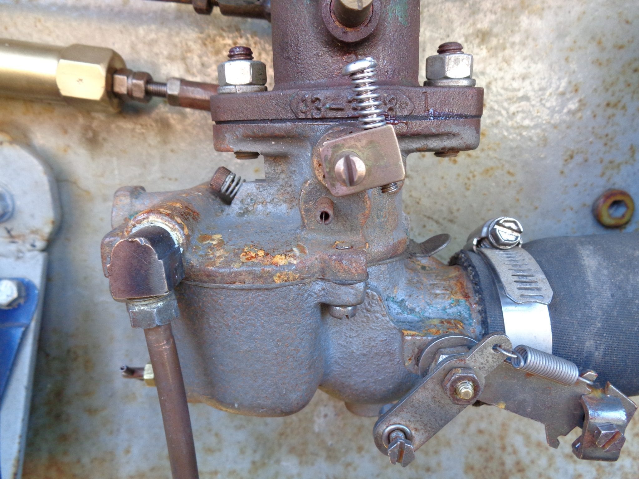

      What a coincidence as I just finished getting my old ’58 LeRoi air compressor running after sitting for a few years and it is based on an Allis-Chalmers design. It also has a Zenith updraft carb but I didn’t take note of how much meat was in it for a thread repair. Both the hi-speed and lo-speed jets on it are adjustable and one faces the front and is under the bowl while the other is on top and comes out on a 45 degree angle.
      If you can wait for a day or two, I can remove it again for inspection but first I have to reinstall the transfer case in my Exploder but in the meantime I’ll post a photo of the carb for comparison. That won’t be for another hour or two.

          Does your carb look anything like this one?
          DSC00325
          DSC00324
          DSC00323

                The carb is very similar to the one that Mumbles posted, except were it looks like an adjustable external main mine is fixed and hiddent behind a plain bolt. On Mumbles you can see a brass colored tee on towards the front side of the carb. Mine is just a fixed bolt in this location which allows access to a fixed jet similar to what you would see in an outboard with a high fixed jet.
                i think I am going to take it to a local machine shop and see what they can do. The crack is on the outside and doesnt seem to go into the threads so see what they can offer on a repair approach.
                Thanks for all the input much appreciated.
