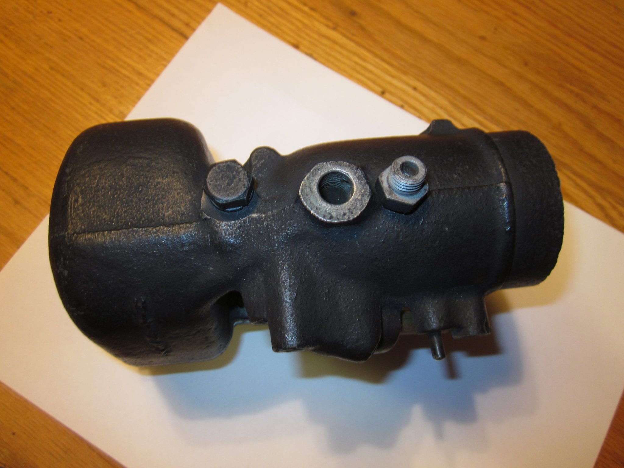

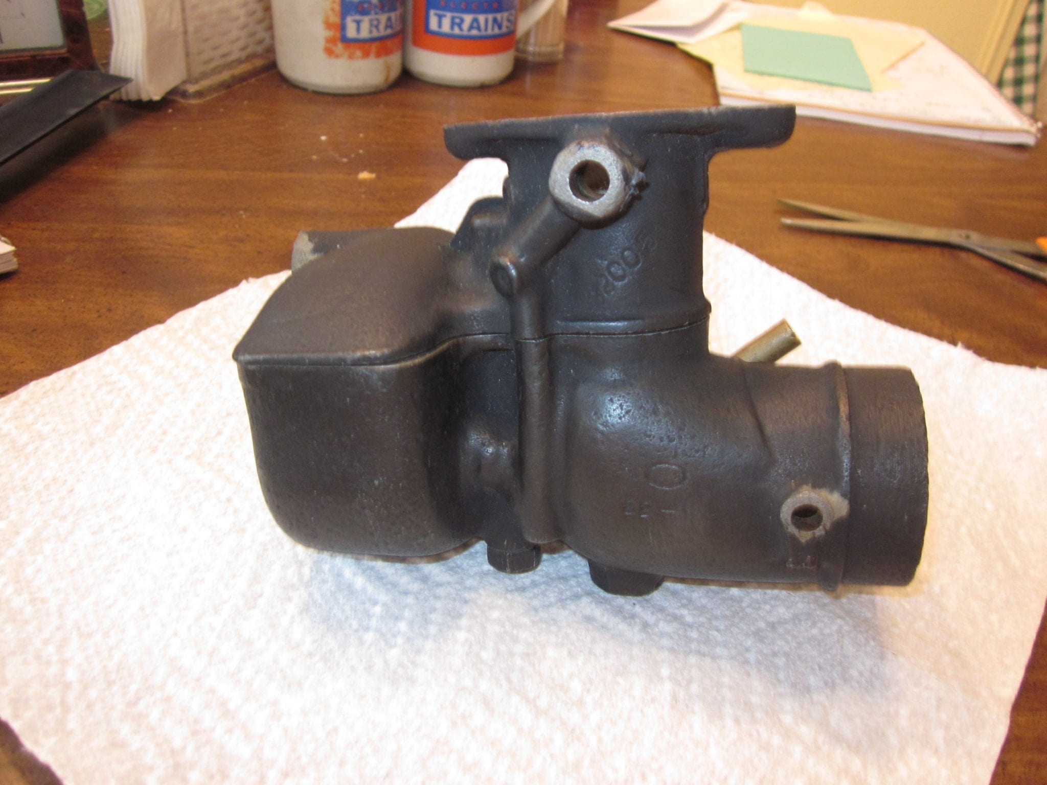

                    Is the carburetor a Zenith similar to one in photos?
                    Is the problem with the plug in the bottom of carburetor shown in photos?
                    Zenith was a French carburetor used on Ford Model A and B and a wide variety of tractors. and other engines. Same basic design with variations to suit application. Model A Ford sites cover variation used on Fords.
                    Thread and crack repair may be possible with a product similar to
                    JB Weld that is more resistant to gasoline/alcohol.
                    IMG_9024
                    IMG_9017
