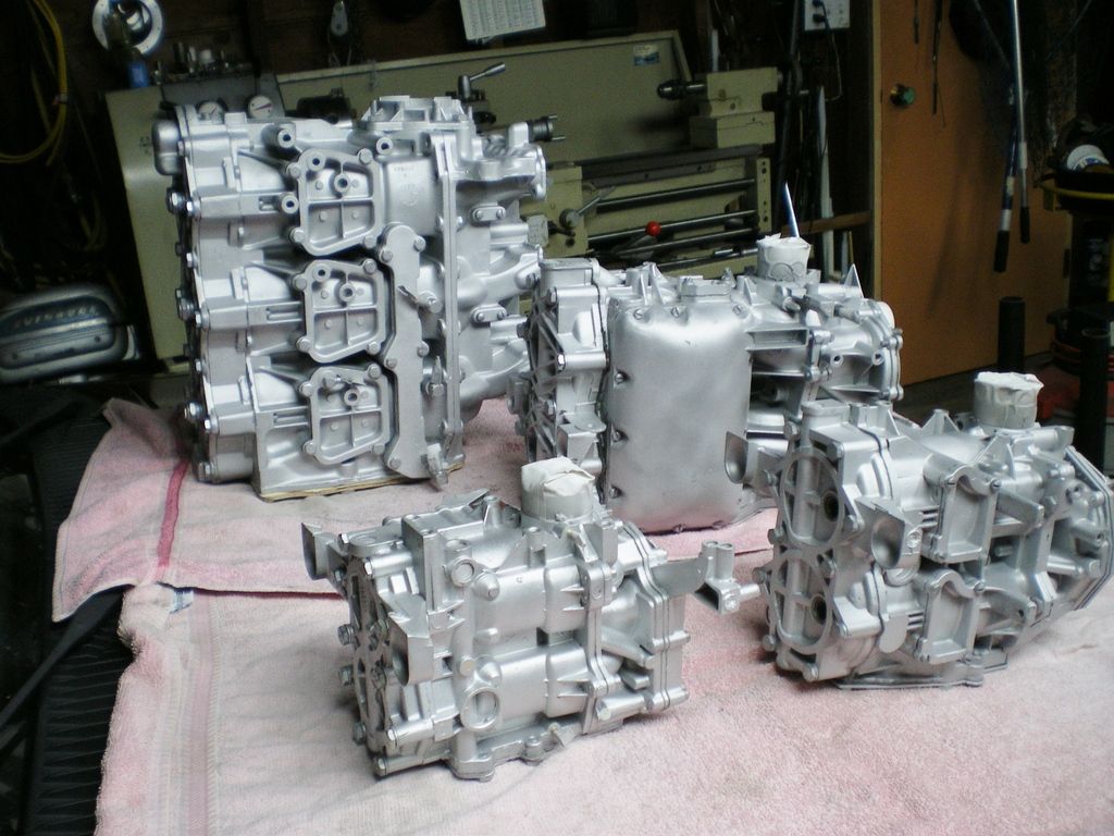

              Yeah Beer, I have to recommend bead blasting to. I do have a cabinet at home like Chris does to but I have to admit, you can’t beat the commercial ones in town for a dollar a minute! You bring in your clean and degreased parts, put on the gloves and hearing protection and let ‘er fly! You can remove a lot of paint in fifteen-twenty minutes with one of these units!
