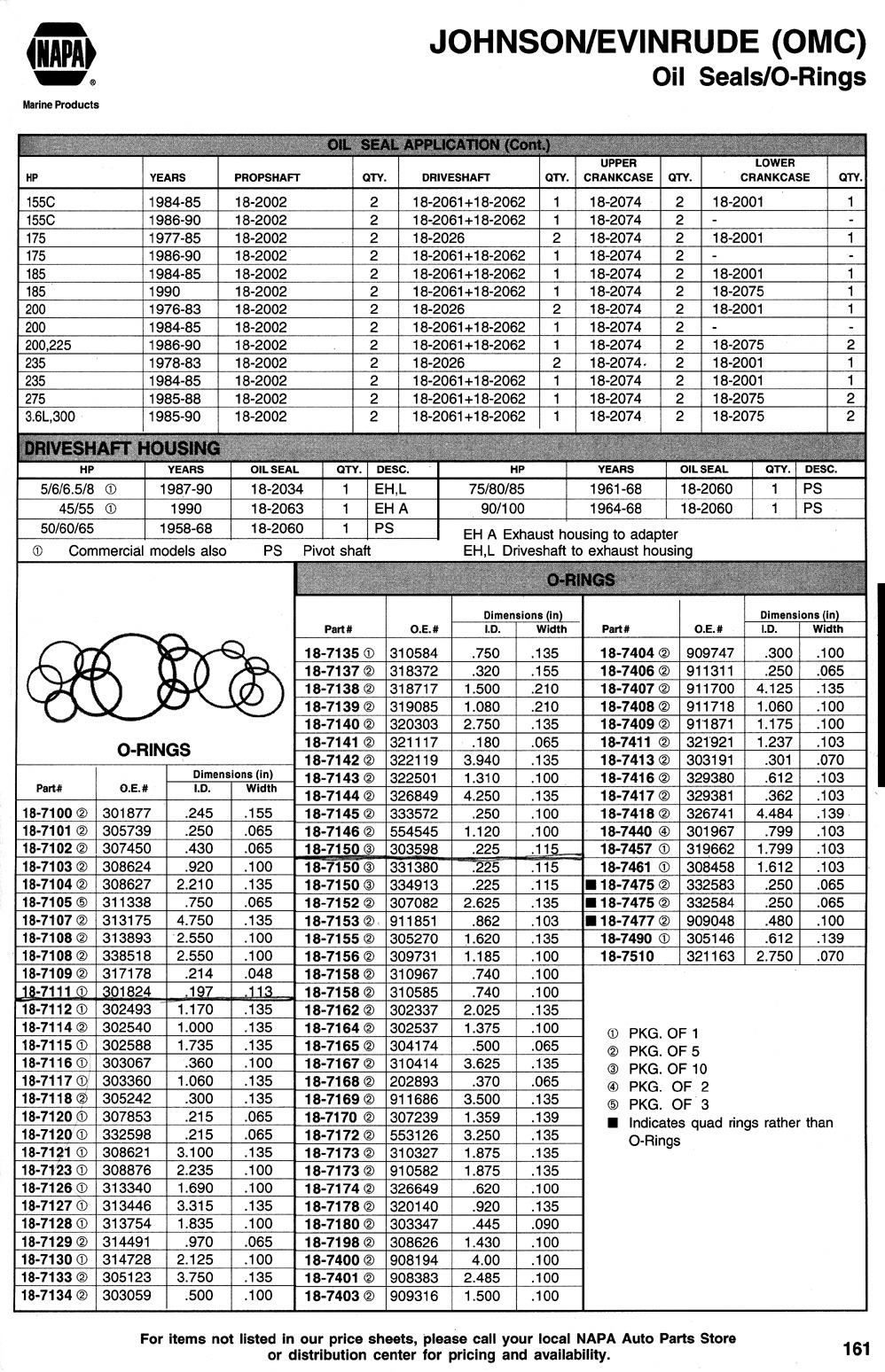

      Is there a common “O” ring number for the upper drive shaft “O” ring used on many of the 50’s OMC outboards. P/N 0303347 prices seem ridiculous.

          oring chart
          Oring-chart-o-ring-

            I bought an o-ring assortment from Harbor Freight and can usually find one that fits.
            #192125
              GLM 81110 matches the size maybe a local seal/bearing shop can order it …. might be cheaper

                  This is what Sierra Marine has . . .
                  #192151
                    I’ve used these size charts by finding the appropriate OEM number, verifying the correct dimensions as shown in the chart, then finding the matching size at my local Ace Hardware store where they have drawers full of O-rings.
