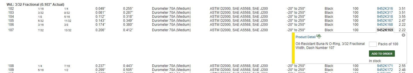

                      Looking for the shift rod O-ring. It is an odd size measured in 1/128 increments. Answering this from work, so I don’t have the numerator .Rehber is the only place I have found some. I think I will just order a minimal number and see what happens. Would be nice to have source that doesn’t charge an arm and a leg
                      #228078
                      Evinrude 25
                        The shift rod O-ring OD is 0.245. #107 O-Ring from Mc_mastercarr the OD is 0.206.
