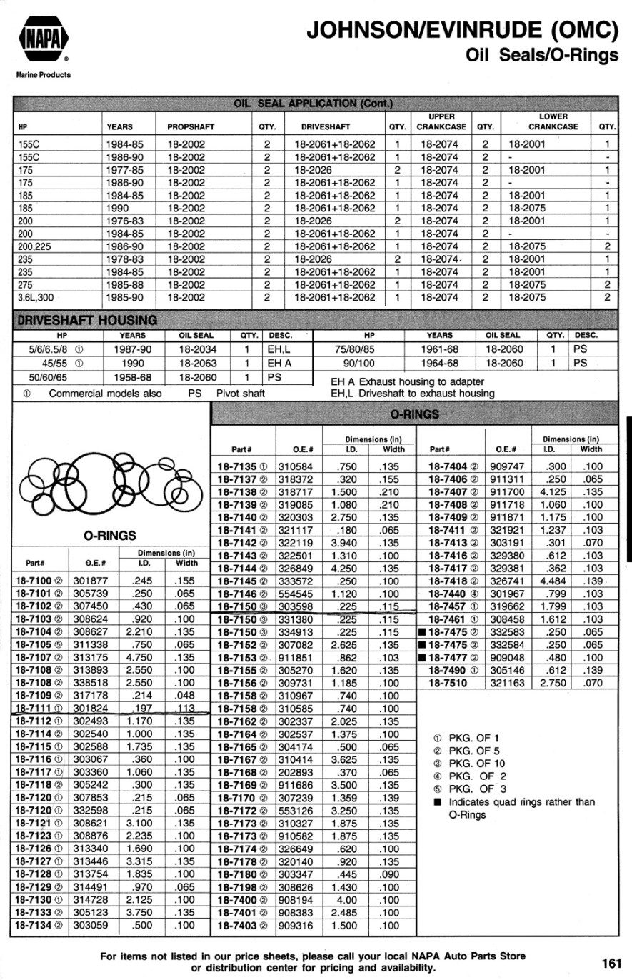

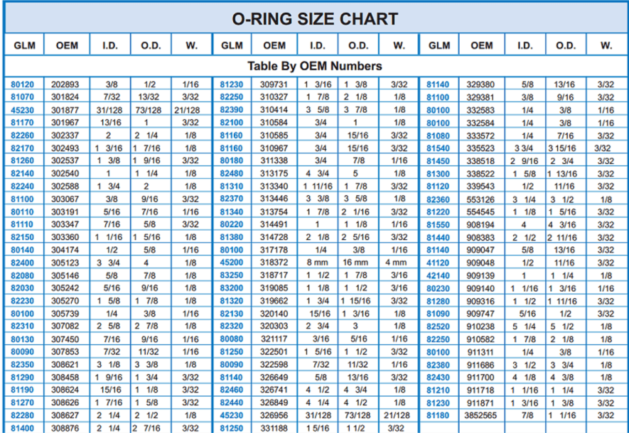

          I’m with Dale on this. I can usually find a correct O-ring at my local Ace Hardware that carries a huge assortment of pieces. Here’s a couple reference tables I often use to find the corret size. If you have the original OMC part number, you can find it here and either buy a Sierra or GLM equivalent O-ring or use the listed dimensions to find one at a hardware store.
          O-ring-Size-Chart-Sierra
          O-ring-Size-Chart-GLM

            O-rings are commercially sold as “dash” numbers. With perhaps an exception or two, OMC used standard sizes. 70 Durometer, Buna Nitrile. Cost= pennies each

                    I used the size chart listed above
