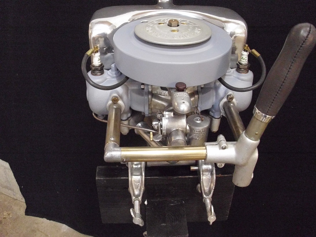

February 7, 2018 at 5:13 pm #70762February 7, 2018 at 5:26 pm #70763February 7, 2018 at 8:42 pm #70775I used light machinery grey on my oa-65. I only painted the jugs. I thought it turned out a bit too light. I’ll get a pic tonight.

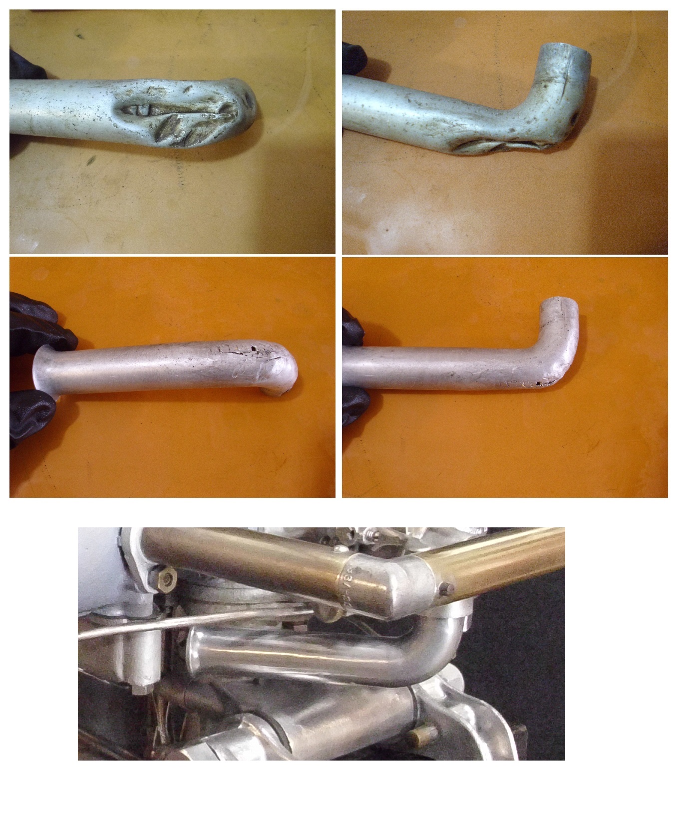

February 7, 2018 at 11:12 pm #70781quote twostroke:I need that carb hot air tube!
The reason you need one is when you
tilt the motor forward it gets crushed if
the power head it turned to the left or right.
This is the best I could do with the one
I had. Art Decalb sells cast ones so I
tried one. They are pretty crude when
you get one but clean up pretty well.
Not original but better than nothing.A "Boathouse Repair" is one thats done without having tools or the skills to do it properly.
