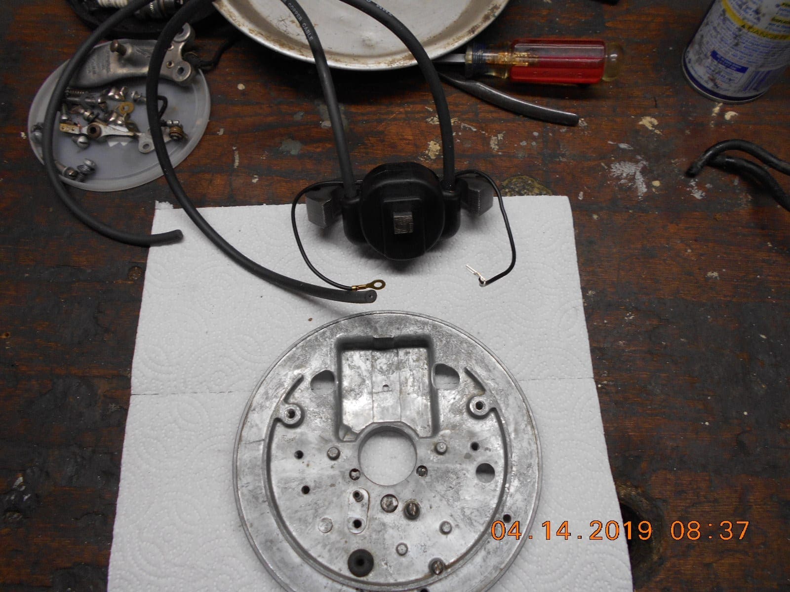

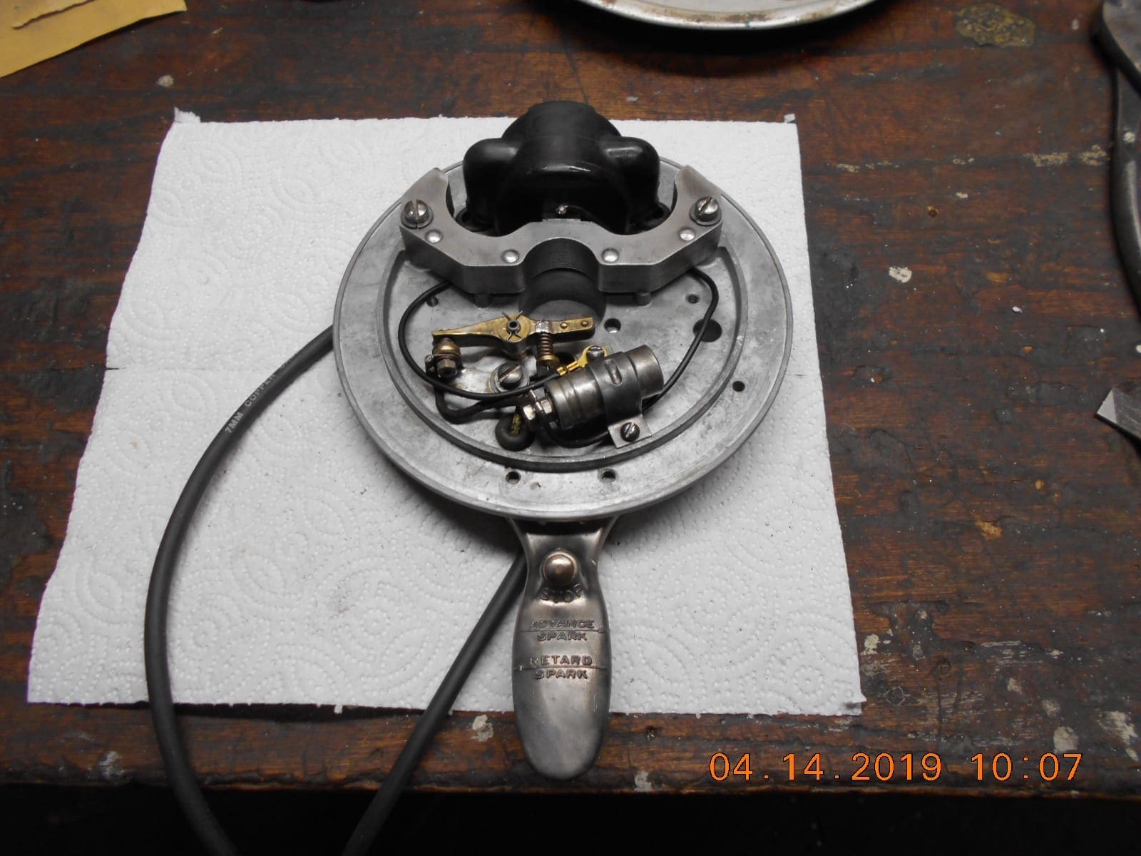

      I finished up installing the pony motor coil on
      the 72A Eismann magneto for the OB35A Neptune 4 hp.
      It appears to be a success. I didn’t have to butcher
      up the mag plate as much as I feared, and had
      not using the big rat tail file been so much fun,
      I could have enlarged the hole less, and made
      a better fit for my over sized grommets.
      For now, I reused the Wico style condenser with
      the threaded end for the primary coil, kill wire,
      and points connections. It tested at .32 mfd’s.
      Anyone know what the John Deere Pony Coil
      condensers are rated at?
      Moral of the story, if you try the B&S coil conversion, I hope you
      have better luck then me. I’ll be using the pony motor coils
      instead. Besides, they’re much easier to find and relatively
      affordable.
      Tried uploading a video 3 times to YouTube, but it never finishes processing,
      and the narrative is nothing but static, so you might want to turn your
      sound off!
      It does “spark” okay pulling it over by hand, but that’s problematic
      doing while filming, unless you have three hands, hence the electric drill, lol.
      https://youtu.be/aBIRgwg_Qrw
      DSCN7734
      DSCN7739
