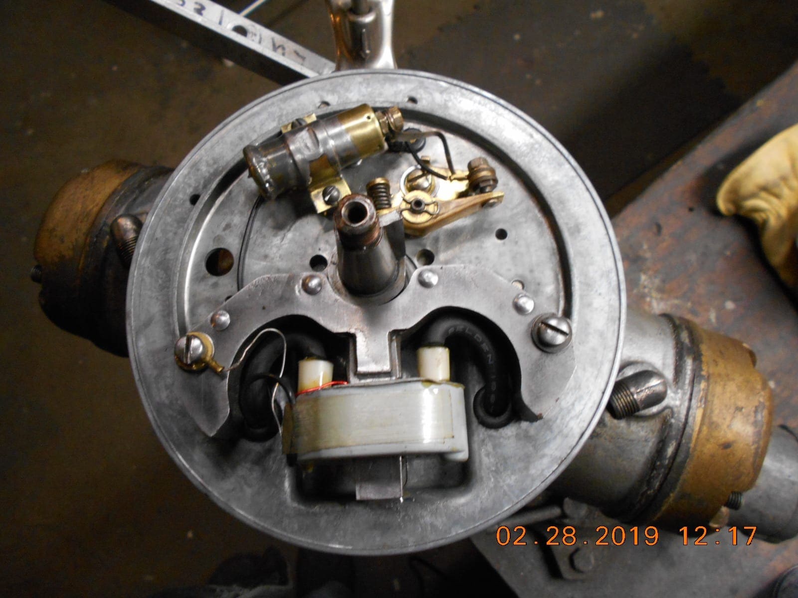

      Now that the little Neptune (1.7 hp) is running, it’s time to ponder upon it’s big brother, the opposed
      twin 6 hp, once again. My attempts to convert the magneto to a Briggs and Stratton
      coil failed miserably, so I bought a John Deere pony motor coil for “plan B”.
      I would have to butcher the mag plate to even try this coil, and also whittle the lamination
      down even more to fit the JD coil. If I had a spare mag plate I’d wouldn’t mind butchering one.
      I’m thinking about plan “C”, just to see if this motor would run and be worthy of a new
      $150 Maytag coil. šŸ™
      Plan “C” would be some form of battery ignition.
      I have a little 6 v battery for the Wisconsin outboard.
      Would the Briggs and Stratton coil survive a 6 volt input to the primary?
      Curious, how much voltage does the Stevens tester put out to the primary when testing a coil?
      Thought about an automotive type coil, but that’s problematic being the Neptune is
      a twin cylinder.
      Thoughts on a workable battery ignition welcomed, so I can test run this outboard in my lifetime!
      Thanks.

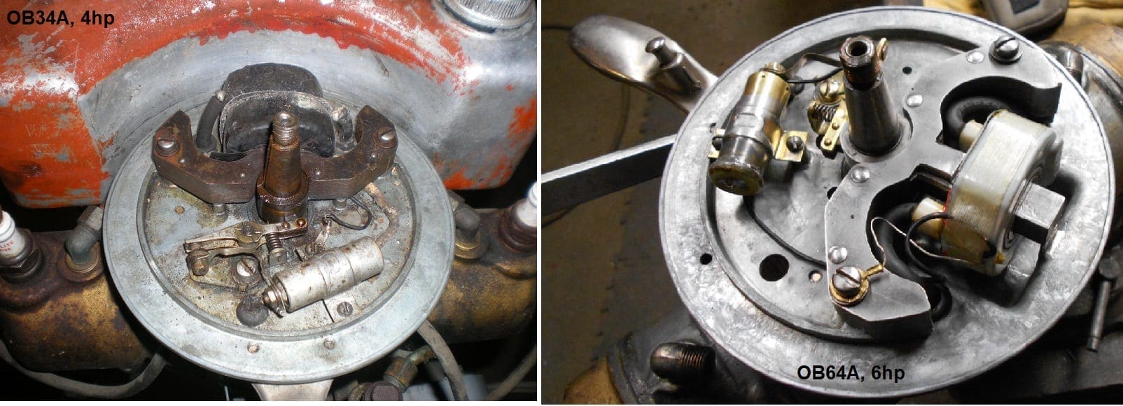

                Could you use a complete mag from a 4 hp? Given of course that the mag would be good…and that the flywheel would work…
                Richard, Excellent idea on the 4 hp mag plates.
                I have two, and it looks like they have the same (troublesome)
                coils. Not sure if the whole mag plate is interchangeable, and if so,
                what flywheel would fit. I’d have to tear apart a running motor
                to find out, and hopefully it would still be a running motor when
                the experiment is over. šŸ™‚
                Magneto-comparrison

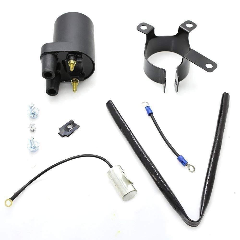

                      On the idea of “battery ignition”, I found these two coils that would omit splicing a “Y”
                      in the spark plug wires on an automotive type coil.
                      One is for an Onan Opposed twin, the other 2005 era GM coil packs,
                      which one fellow adapted to his twin opposed lawn tractor.
                      I wonder how long running these coils before the battery ran out of “juice”?
                      Onan-Coil-twin-opposed
                      GM-DR39X-coil
                      #173197
                        After shoveling, snowblowing, and plowing 10″ of wet heavy snow this morning,
                        I told myself I was going to stay inside the rest of the day (or month), but
                        boredom and curiosity got to me, so I went out to the garage to look
                        at the 4 hp OB35A 4 hp Magneto. Compared magneto diameters between
                        the 4 hp and 6 hp OB64A that needs a coil, and they were the same OD.
                        Off to a good start, so I tried exchanging flywheel nuts. 6 hp nut was too loose
                        on the 4 hp crank….. and of course, the 4 hp nut would not go on the 6 hp.
                        Figured this was going to be a “deal breaker”, and it would have different crankshaft
                        taper and or diameter, but not much to loose at this point, so I pulled the flywheel on the
                        4 hp and slid it on the 6 hp crankshaft…. it fits!
                        Then removed the mag plate off the 4hp and it fit right on the 6 hp crankcase boss,
                        no problem. Both mag plates are stamped Model 72A. The 6 hp flywheel even appears
                        that it will work with the 4 hp mag underneath.
                        The 4 hp Eisemann coil looked good (but I’ve never had this 4 hp running or worked on it yet)
                        so I checked it with the Ohm meter. Reading 7.6 K across the secondaries, and .2 K on the
                        primary, so I think it’s worth a “go”, but it needs new plug wires for sure.
