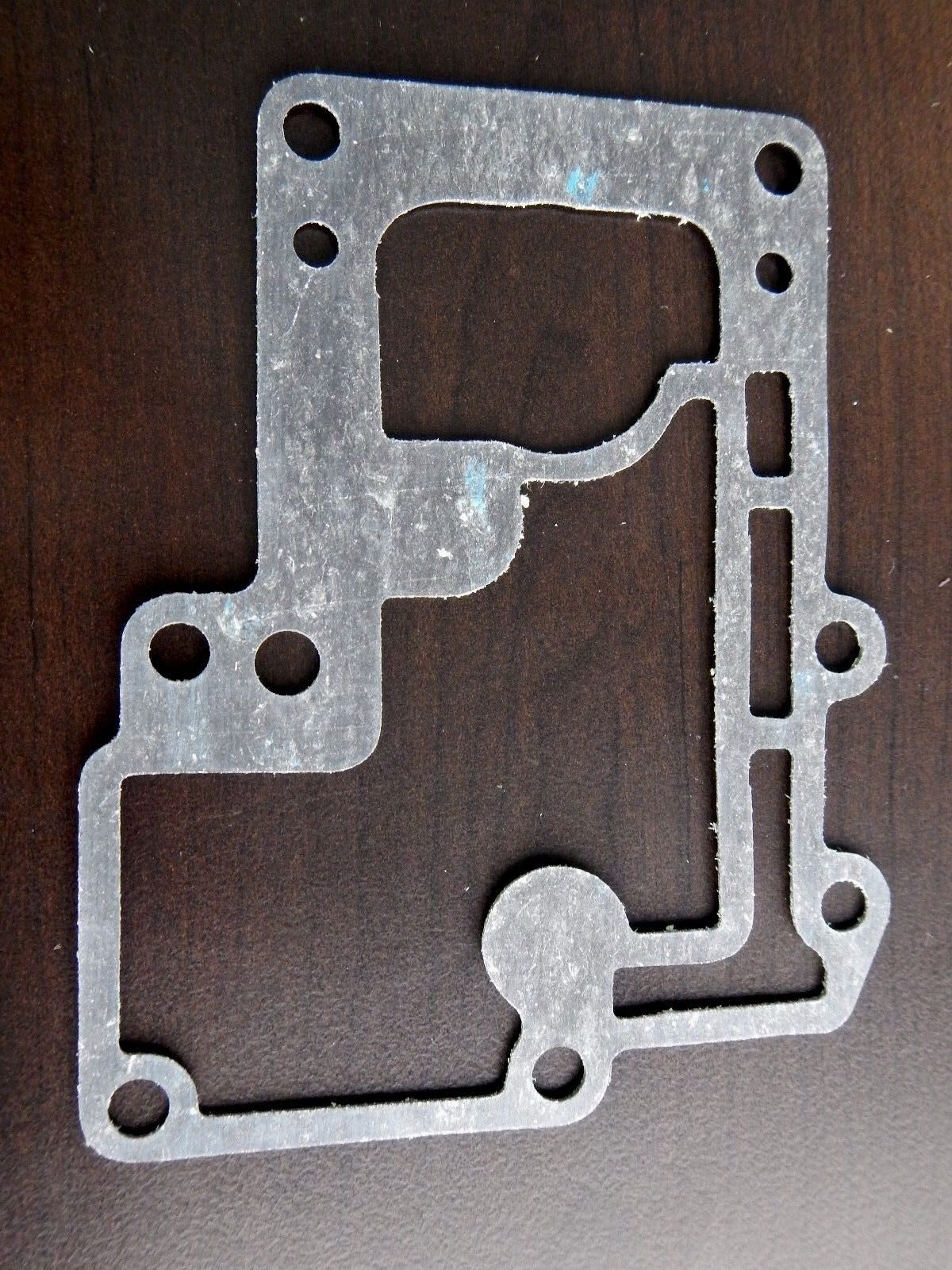

      close look  at cd-10 base  with lots of carbon deposits …
      while checking the impeller had a chance to do some clean up 🙂
      base gasket replaced with a 6hp gasket which needed a small touch-up with a blade  and   became a  CD-10 5.5 hp base gasket   🙂
      overall the engine is in great shape

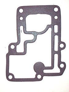

          You can convert a 313065 into a 303467 gasket but a 304314 wont work.
          Base-Gasket-313065
          304314-Base-Gasket
          303467-Base-Gasket

            yes coils were orignal .. now replaced   with new wires.  getting strong sparks
            old and new modified gasket patterns were overlapped   and matched
            #253123
              a 6R72D    #313065   base gasket    snipped   into a    303467   for a  CD-10  🙂
