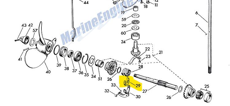

’57 Golden Javelin had a seal leak at the prop shaft (actually where the o-ring in the retainer housing meets the lower gearcase half).
Dropped the lower, drained it, put it in my jig, opened it up. Got a new seal kit & a new tube of 847. Cleaned everything, scraped all old sealant…ready for work! Put in the new spaghetti seal, new o-ring on the retainer housing, smidge of 847 on the o-ring, installed everything, set the lower case half & buttoned it up tight. Everything went together perfectly. I figured I’d let it set up overnight before I did a pressure test.
Out to the shop the next morning to do a quick 2PSI test in a bucket of water, and what do I see laying in a parts tray on my bench???
….the clutch-dog cradle. I never put it in the shifter yoke! %$#*&% *&%$^^ *&*%$#@!!, and all that.
