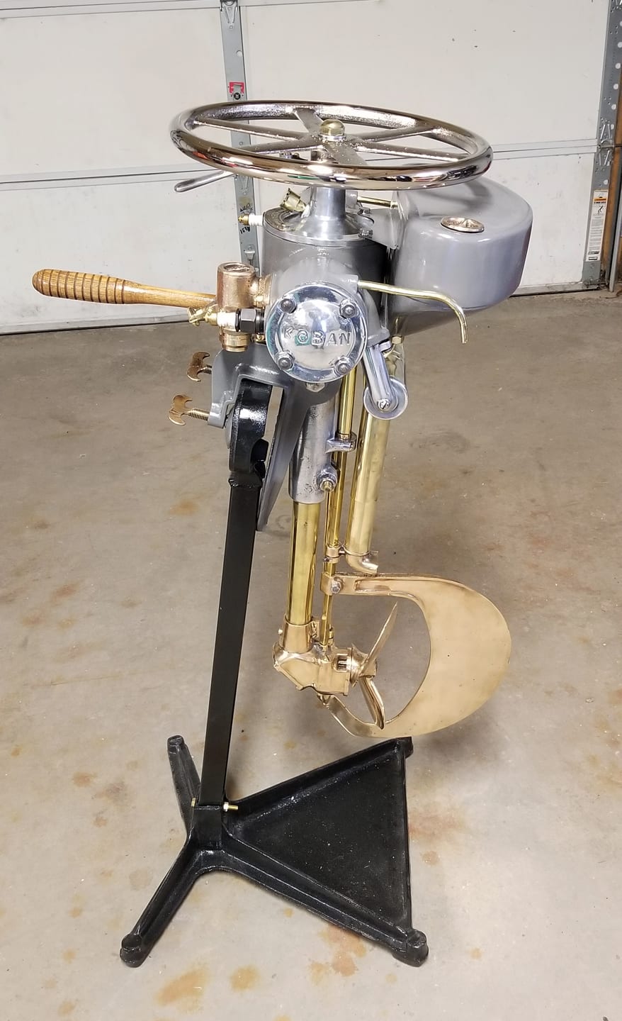

      Finished my working restoration of my 1916 Koban. Intend to try running at Tomahawk. What would be the best oil to use for the mix and what ratio? I have never run a Koban before. Restored it to be a “runner”, new gaskets, corn head grease on water pump gears, etc.

        Well, I couldn’t tell you what the oil mix is, but I can tell you that is one of the most OUTSTANDING antique restoration projects I’ve seen! I would be afraid to use it! Congrats on a magnificent job.

          It’s beautiful!!!!!

          BROOK E. NEWCOMB
            Excellent job looks Great!
            I have a 1915 Koban 1/2 pt per gallon has served it well.

              I think I was once told they like a heavy mix, like 8:1, as they have iron pistons running in iron cylinders. Not sure.

                Nice to see another one with underwater exhaust!
                I have a 1918 with underwater exhaust an option
                That you rarely see.

                  Beautiful motor. You can run it with the fuel/oil mix as Brook suggested.
                  I myself prefer to run these at 8:1, but that’s just my personal preference/prejudice.

                    You will find that you’ll need an extra large amount of space to turn the boat when underway, and even then, it may not turn where you want it to go. When the rudder is turned, the prop wash bypasses and goes straight out making it difficult to turn. Wasn’t a real efficient design, but the motors run well! Beautiful restoration!
