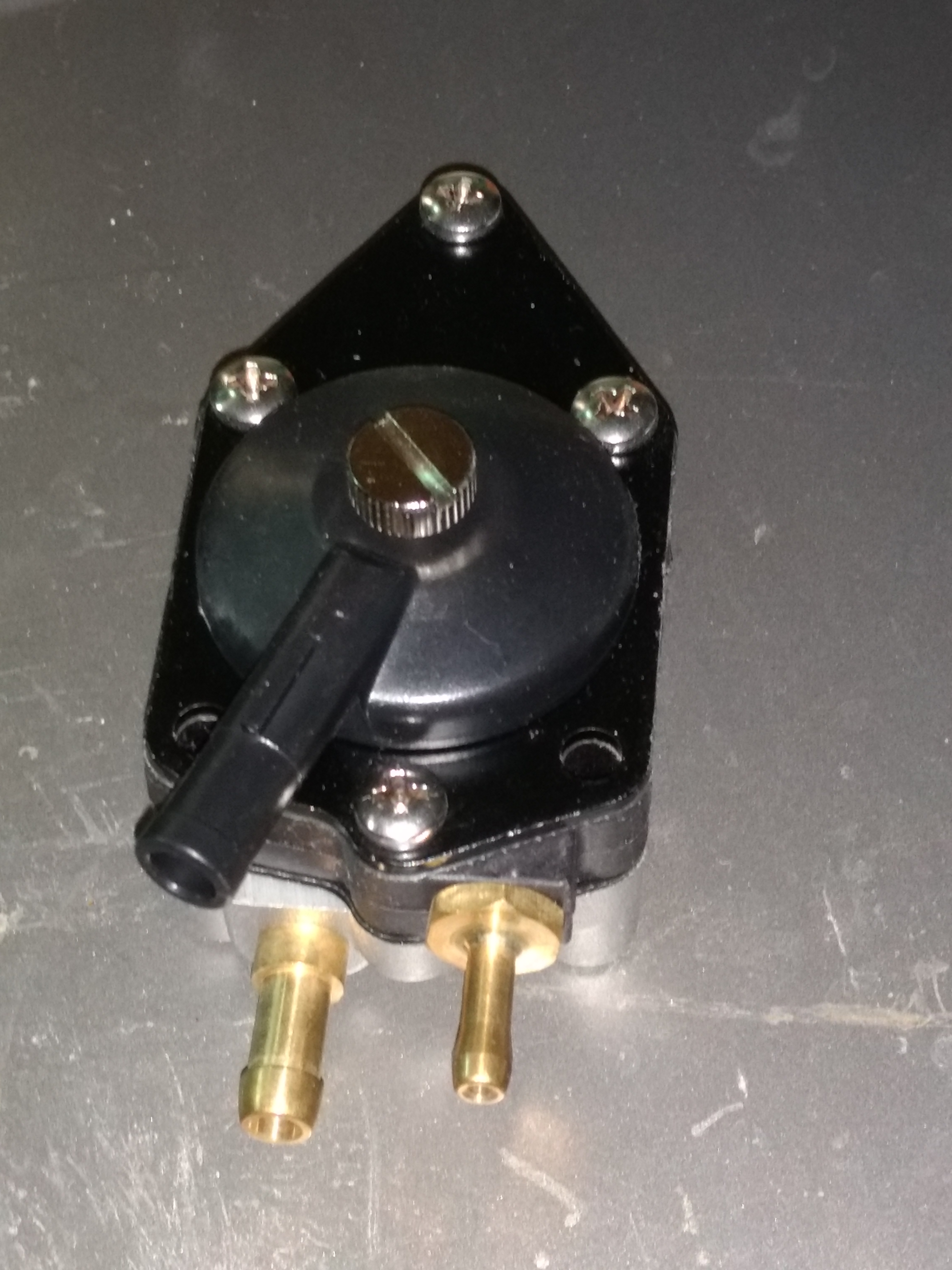

      Trying to tune out a 1956 Johnson 10 hp Qd-17 that has been converted to a fuel pump. I’m seeing bubbles in the fuel line from pump to carb I let, which I know is an issue, but my question is can the bubbles cause the engine to oil foul the plugs?

                Is that an aftermarket fuel pump you have there? FYI, I’ve had several fishing motors come thru my shop that have had one of the ”cheap” Ebay, Amazon, etc. fuel pumps installed on them. On the ones I’ve seen, they all leaked at the seams. I tried an OMC fuel pump kit, but no go.. the gaskets and diaphragms won’t fit. I also noticed the check valves are junk. I think your better off buying a NOS fuel pump off Ebay.. that’s what I’ve been doing. I’ve found some pretty cheap. I had a V6 come in the other day, (with dual fuel pumps) and that one lasted about 2 years before it crapped out. I had to replace them with NOS OMC ones. I myself, was curious if these cheap pumps were worth anything… my conclusion is, no!

                  Thanks for the response, Jerry. Yes, it is an eBay purchased pump. It’s brand new and wasn’t cheap so I was not expecting to have issues like that from it. The thought crossed my mind to try a automotive electric pump controlled by a inductive relay on a spark plug wire. Ever seen anything like that? I know it won’t fix the check valve issue, but wonder if a coating of silicon sealant around the seams of the pump would help.

                    If it is seeping fuel mix the silicon won’t stick. Surfaces must be clean and dry, no trace of oil. . . 😉
