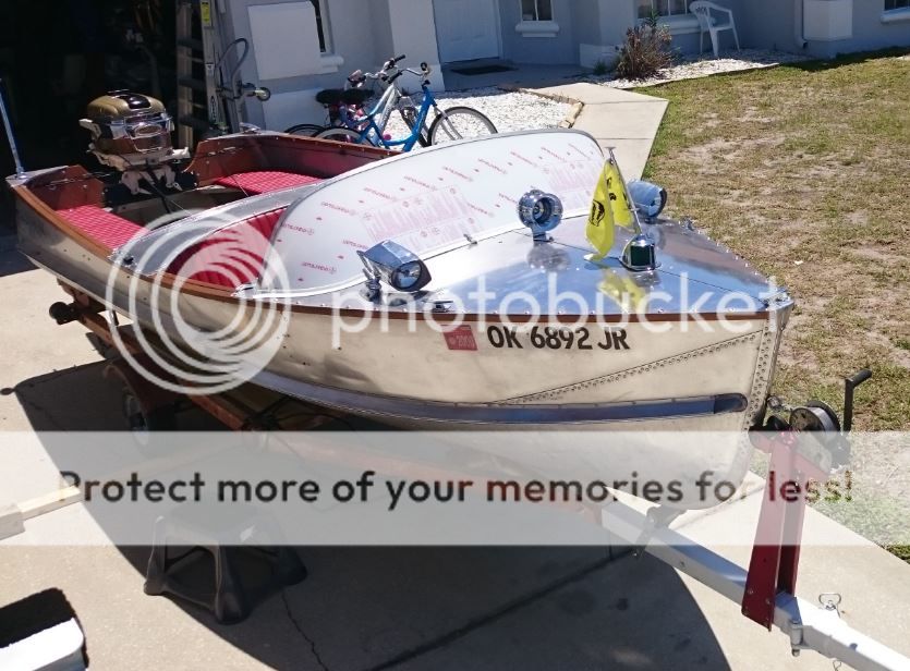

                Thought I’d throw some pics of my project you helped me with:

                #58532
                  That’s NICE ❗ ❗ ❗
                  #58533
                  amuller
                    Beautiful!
                    #58536
                    lindy46
                      Looks great. Pretty motor!
                      #58543
                      marksoldcresty
                        It’s the family boat. Dad bought back in ’58. It hasn’t run in 18 years. Sat out on the farm under a tarp. I learned to ski behind it in the 60’s. Question, where can I buy an oil recovery system/kit? Also, scratching my head where I’d hook it up to the crankcase drain on the power head. BTW, I took the ’58 Johnson 50 horse off of it. Promised him I’d try the boat with something lighter. He put the 50 on it to ski two adults at a time. Problem was it made the boat stern heavy and prone to swamping the rear of it when backing up.
                        ~mark
