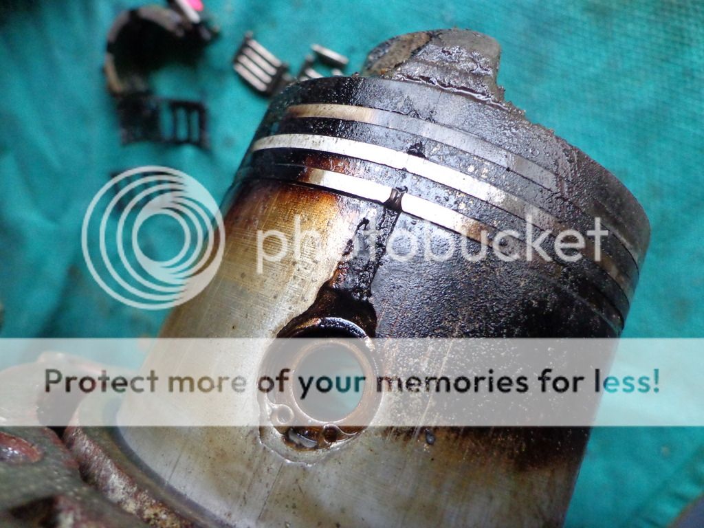

While tearing this 40 horse Evinrude Lark down, I noticed some signs of blowby on one piston. I knew right away this wasn’t going to be a good day.
After getting the pistons out of their holes, the cause became a bit more obvious.
Where’s the missing circlip?

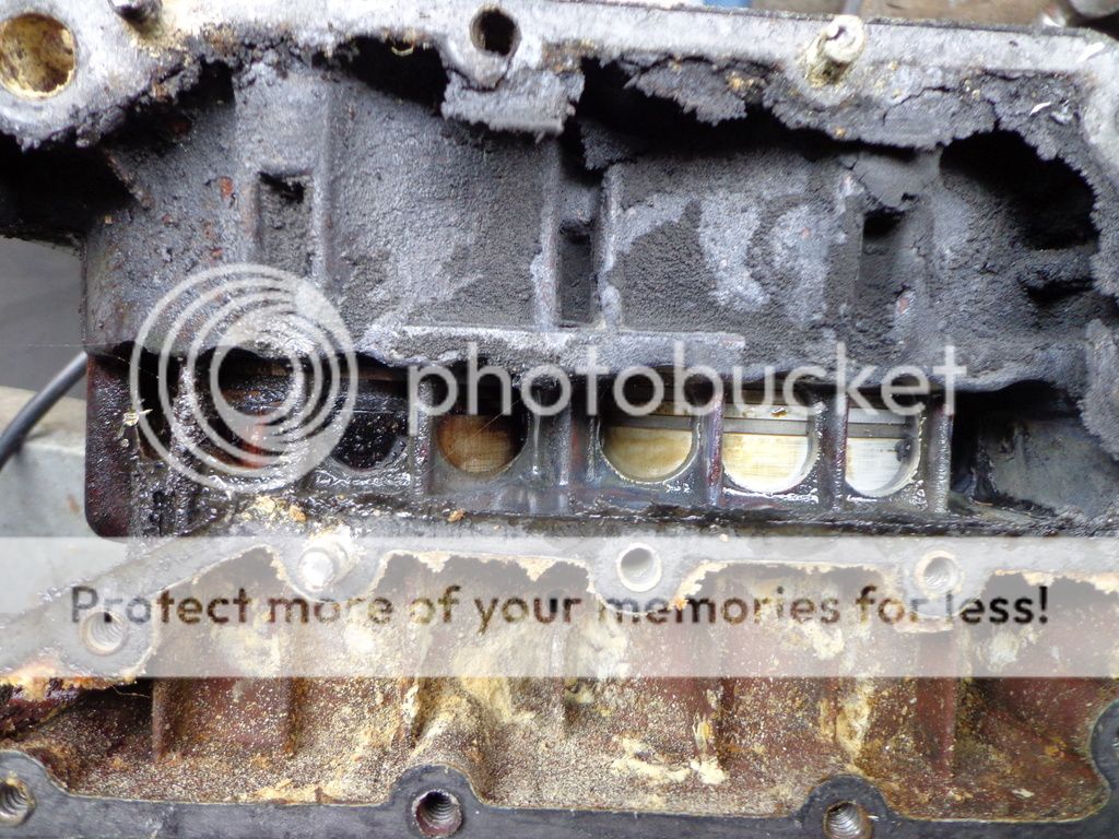

It’s not here.

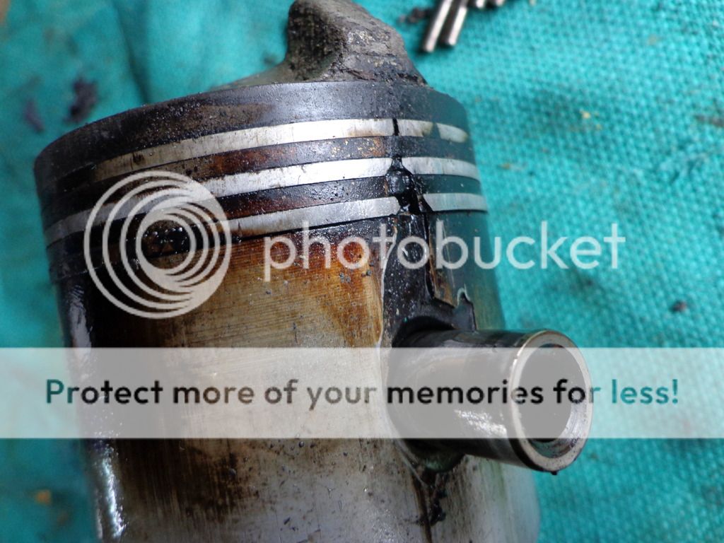

And I don’t see any sign of it here either. 😕
March 5, 2017 at 7:00 am #53849That is a real mess. Maybe the c clip got busted up and went out the exhaust ports,or ground up to till there was nothing left.

March 5, 2017 at 2:08 pm #53862I have a 1955 RD that had the same problem. The motor looked like it hadn’t seen many hours of use. So little, that I wonder if I left the factor missing one clip. It was still cranking over with the wrist pin having cut a groove almost right through the cylinder sleeve.
