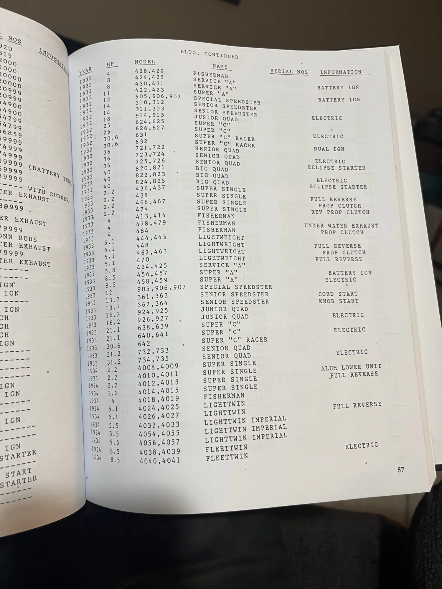

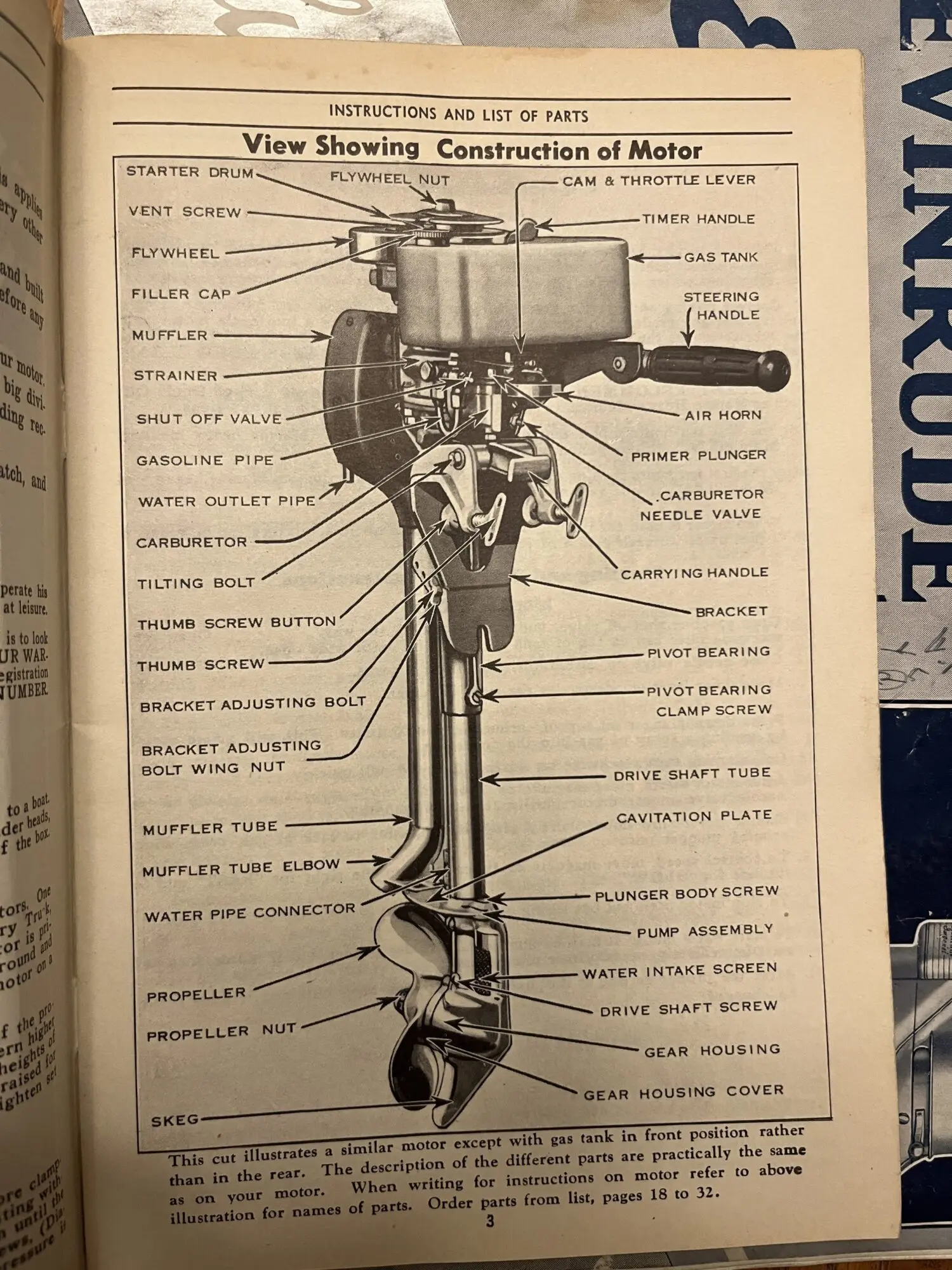

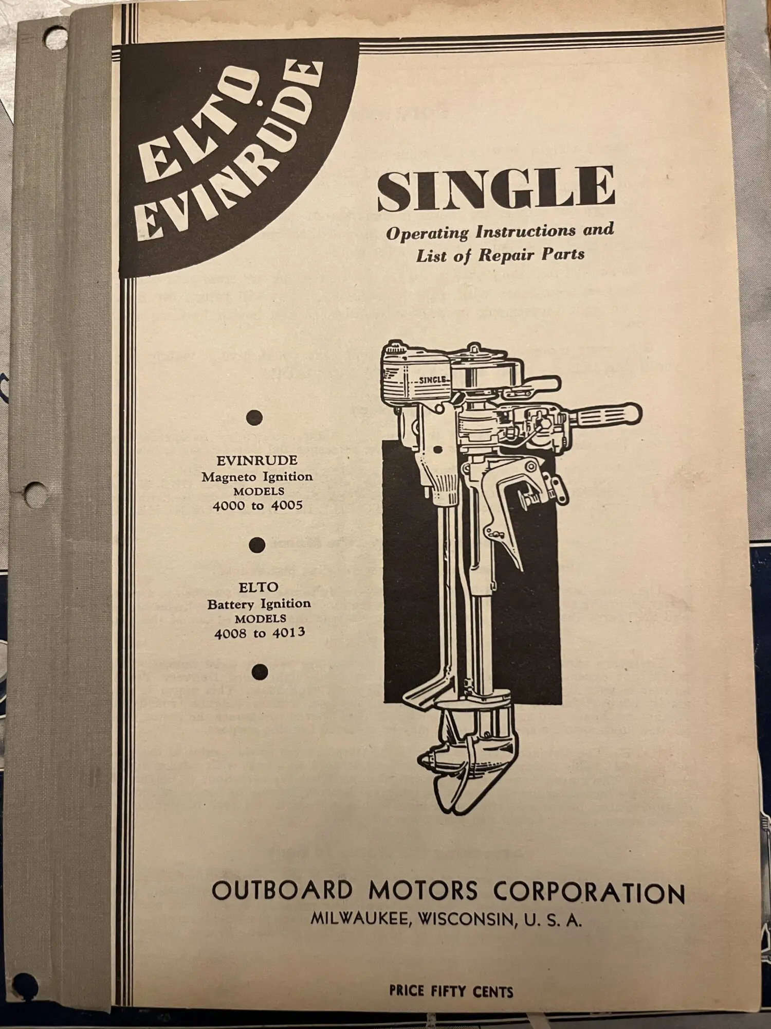

          I will post what information I have.IMG_9103
