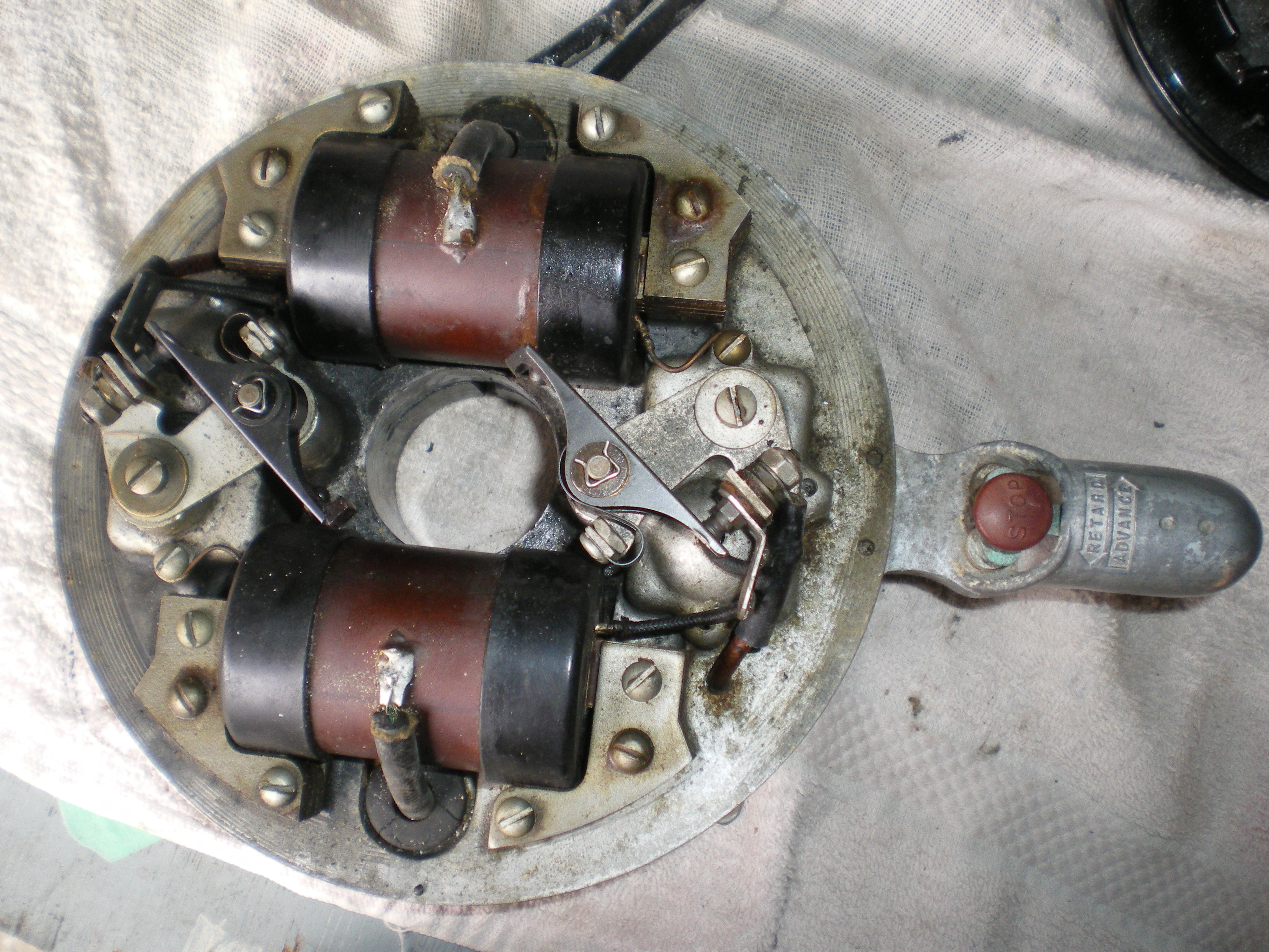

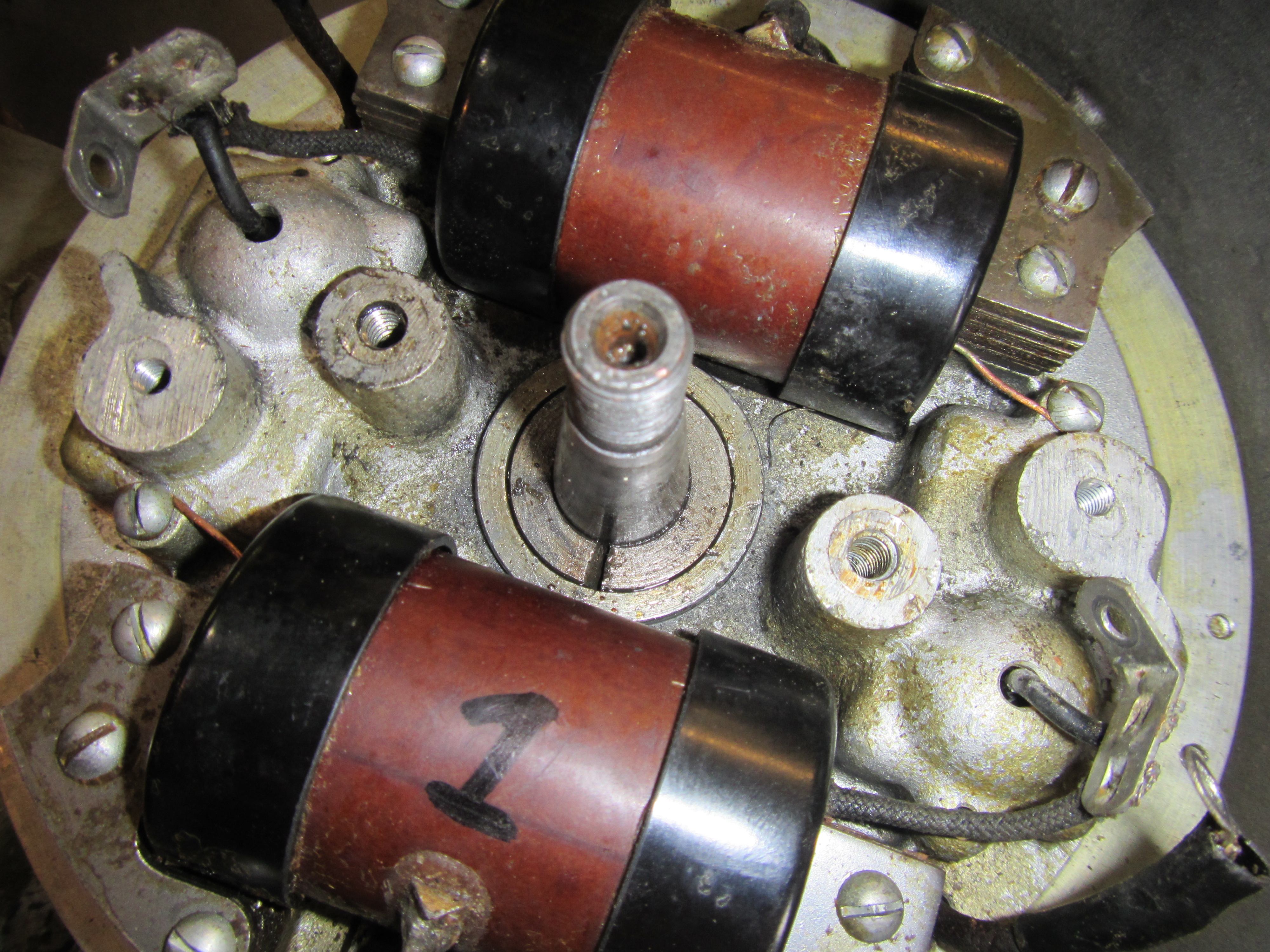

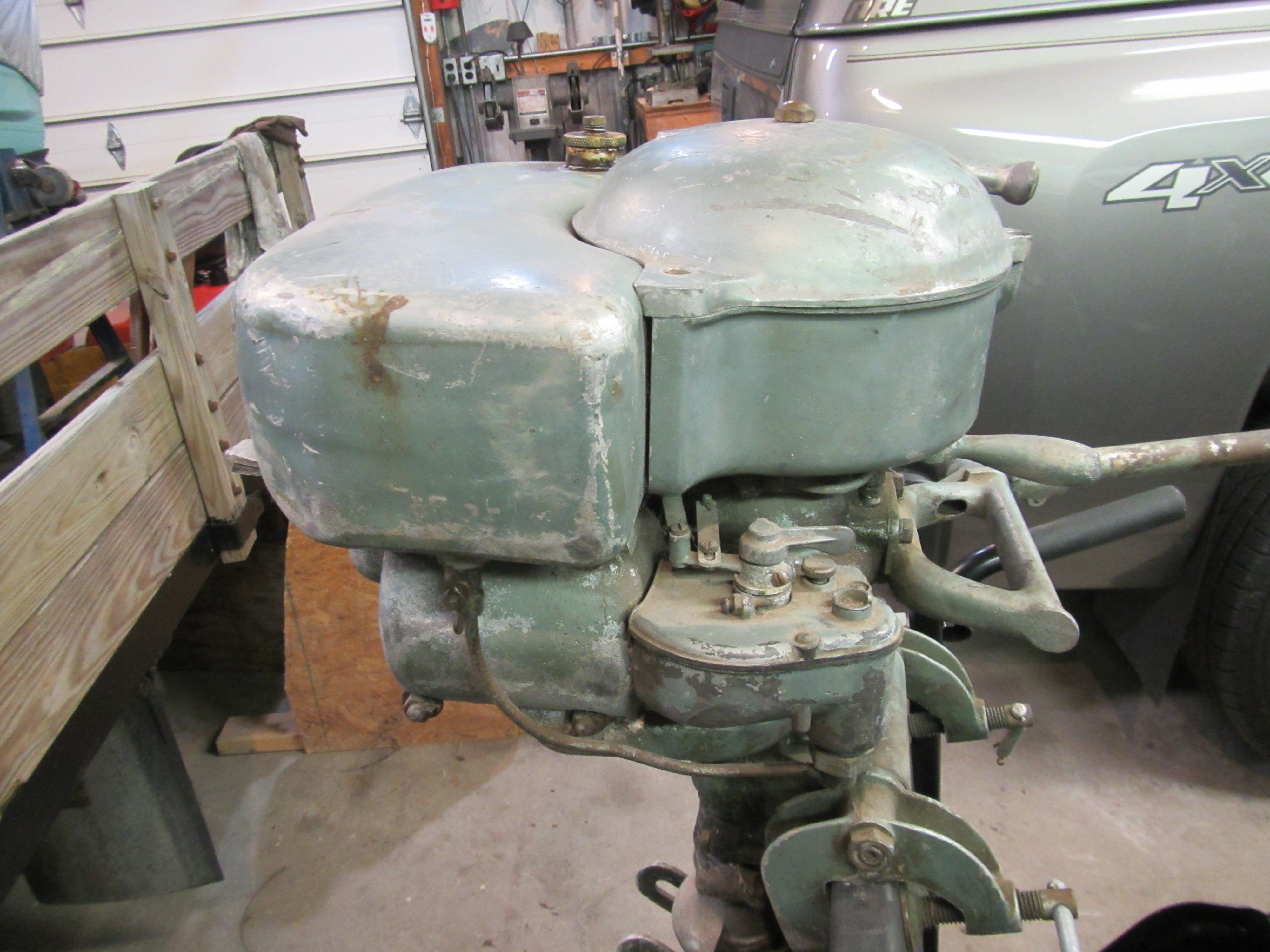

Hi guys, what can you tell me about a KD15 Johnson. I just picked one up and I am lost but I am learning! This motor is complete and needs a bunch of cleaning. Peter Hunn’s outboard bible tells me it’s a 1941 model. Must be one of the first vertical twins that Johnson built. Maybe a precursor to the QD series? Rewind is now working after much fusing with those wave washers. I have no spark. Getting the flywheel off was a bugger. I found three of those 1/4x 24 threaded bolts! I read about them in another tread. I used the original rewind cog bolts to get a pry on the flywheel and managed to get it off. Strange condensers, strange rotary valve system. Is there a seal in the middle of the cylinders? How does this motor maintain crankshaft pressure? Gonna test the coils tomorrow. Any info or insight on this puppy will be appreciated.

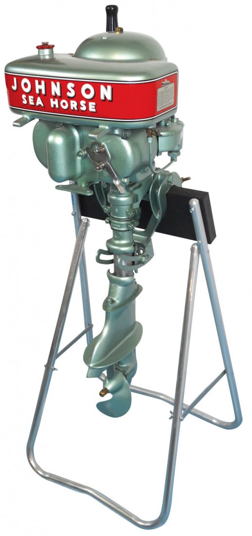

April 21, 2017 at 3:16 am #56456April 21, 2017 at 4:03 am #56458http://boatinfo.no/lib/johnson/manuals/ … on.html#/0
the book of knowledge page 97 covers a bit on carburation of KD’s ….other sections not to rich with info

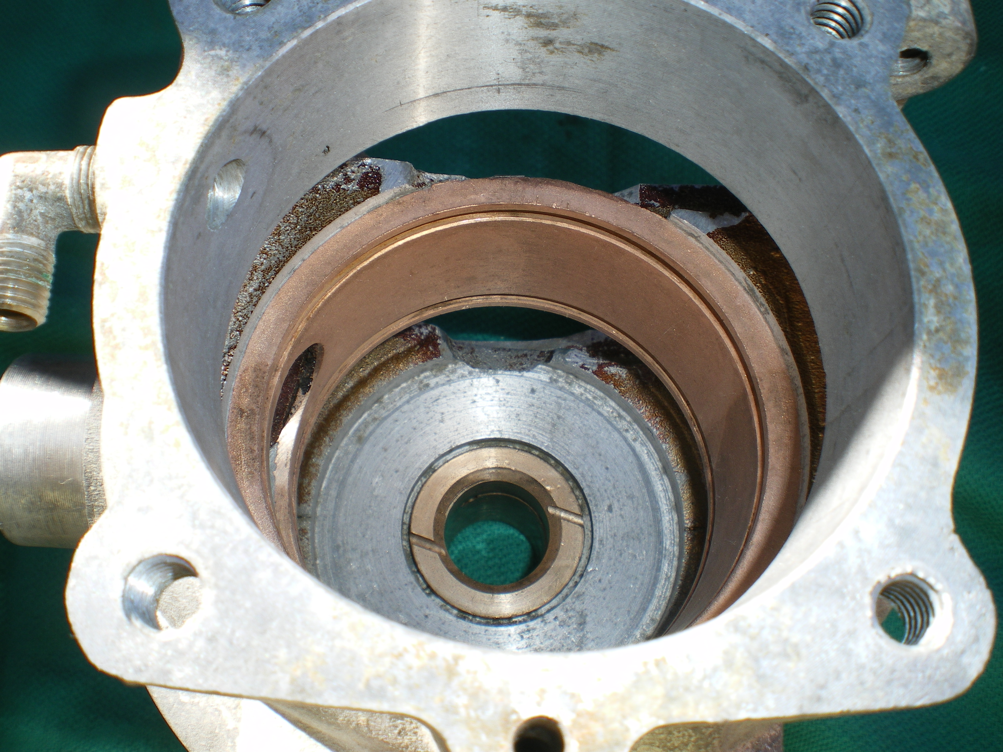

April 21, 2017 at 4:43 am #56460I think the honor of being the first alternate firing Johnson would have to go to the 1930 A-50 and K models. They’d been around a few years before your motor was built and yes, your 71 lb. 9.8 horsepower KD-15 motor was the forerunner to the QD series and calls for an 8:1 fuel mix using 40W oil. AeroShell Oil 80 or AeroShell W80 aviation oils are both SAE 40 W oils. Two rings on the large rotary valve seal the crankcase. The original square condensers were rated at .22 uF and the Champion 5MJ plugs are set a .030" and the points at .020". The magneto is kind of unique with a separate coil for each cylinder. You say you pried the flywheel off? It would be better to use a puller to avoid risking any damage to the flywheel.
April 21, 2017 at 10:51 am #56464Yup that is the baby! Mine does not have that kill button. It has two metal tabs that look like they contact the housing when the go lever is moved all the way to the left. What is going on with the exhaust damper? A leaver from the carb controls, opens a metal washer on the underside of the exhaust duct. Maybe exhaust relief? Your motor has a cutout on the muffler. Mine has a bolted on cover. Were these motors racers? Plenty thick oil ratio, maybe trying to seal the crankcase? This motor is a learning experience for me. I made an offer and it followed me home!
thanks daleApril 21, 2017 at 10:54 am #56465April 21, 2017 at 2:25 pm #56473The racing model had roller bearings on the crankshaft and top, bottom seals, side draft carburetor and a slimmer gearcase with a higher gear ratio. Also an open exhaust and higher compression ratio with two ring pistons. . . 😀
