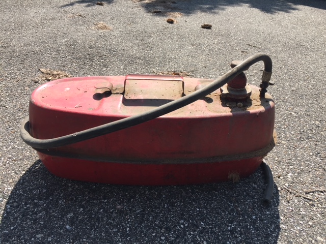

      Any idea what this is/what it came with? A buddy found it cleaning out his dad’s garage and gave it to me. Pressure pump is built into the cap…..
      Thanks!
      Jim
      #80320
      rco
        I don’t think it’s a pressure tank. I got one similar with a Mercury super 5 that has a fuel cap with a hose barb to fill the onboard tank when you pump the plunger. Not sure if this was a factory accessory or aftermarket.
        #80330
          Not an Evinrude or Elto part . . .
          #80332
          kerry
            Not sure if its factory or homemade, but maybe an early alternative to the primer bulb? Someone didn’t want to copy the primer bulb technology yet? Obviously a blend of old (pressure tank) and newer (single line) technology.
            #80335
              mercury had them for the green tank race motors ( gravity feed tanks and carb) . they used them in marathon races to fill on the move. motor hd a special tank cap that the hose was hooked to. it was factory. late 40’s early 50’s.
              #80365
                I know about the factory caps but are you saying that’s a Mercury tank, too?
                #80368
                jerry-ahrens
                  That looks like a champion tank maybe? With that pump, it looks like it was used to refuel a square tank motor while on the fly. If you watch those old racing video’s you can see those guys pumping a handle to keep the motor refueled during a race. Garry could that be right?
                  #80375
                    Mercury Marathon tank
                    #80377
                    1-old-outboard
                      Yes I’m sure Dave has it. Mercury Marathon tank for refueling the green tank on a long run. Seems to me I have a cap for that very purpose. I think Joe Poole told me about them.
                      #80416
                        yes merc tank. I have one.
