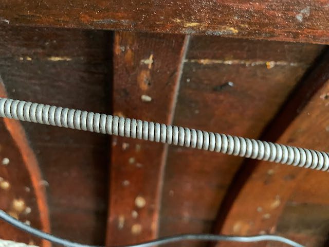

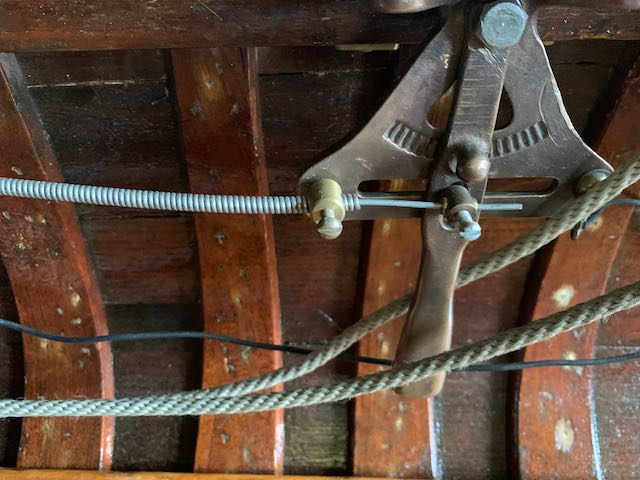

      Anybody know where I can find some shift cable like this?

        This place sells the inner and outer cable by the foot.

          It depends on how long the cable needs to be.Up to 5 or 6 feet long you can buy choke or throttle control cable at auto or lawn mower parts stores.For longer cables I use bicycle brake or shift cable which is available cut to length at some bike shops.

            A lawn mower/small engine shop will sell both the cable and the sheath/conduit  by the foot.  There are also tools that make it easier to get the “Z” bends etc should your application require that.

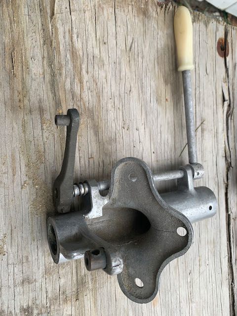

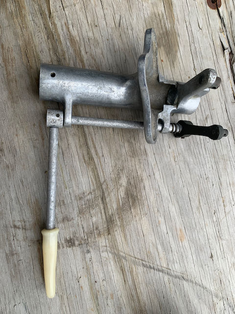

              Thanks for the resources, fellas!  I was hoping to use this with a Kainer steering wheel bracket that has a throttle lever fr remote steering on my 1939 Old Town Sea Model.

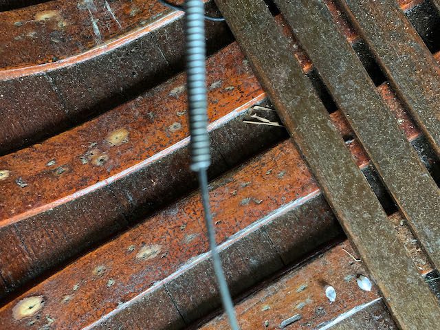

              I need to run abut 15 feet.  A friend suggests that this cable works better in short, straight runs.  He thinks it will bind at bends.

                      Can you adapt cable from a generic “push pull” control system like those used on 50s-60s OMC outboards?
                      #260564
                      George Emmanuel
                        You can, but, those cables you refer to have a large s.s. wire that’s hardly flexible, because the systems they were used on took a lot more umph to move the shift and throttle. So, I would not suggest it at all.  The other concern is, the carb on the early Evinrudes (Tillotson) are super fragile! You do NOT want to place any significant stress on them as they will crumble. The throttle lever (arm)  moves easily, so a thick wire is not necessary. The throttle quadrant on the Tillotson has a clamp to clamp the bowden cable and the throttle arm has a barrel screw. Make sure that barrel screw rotates freely on the throttle arm and the little ratchet spring-loaded pin is free and doesn’t bind up in the quadrant.
