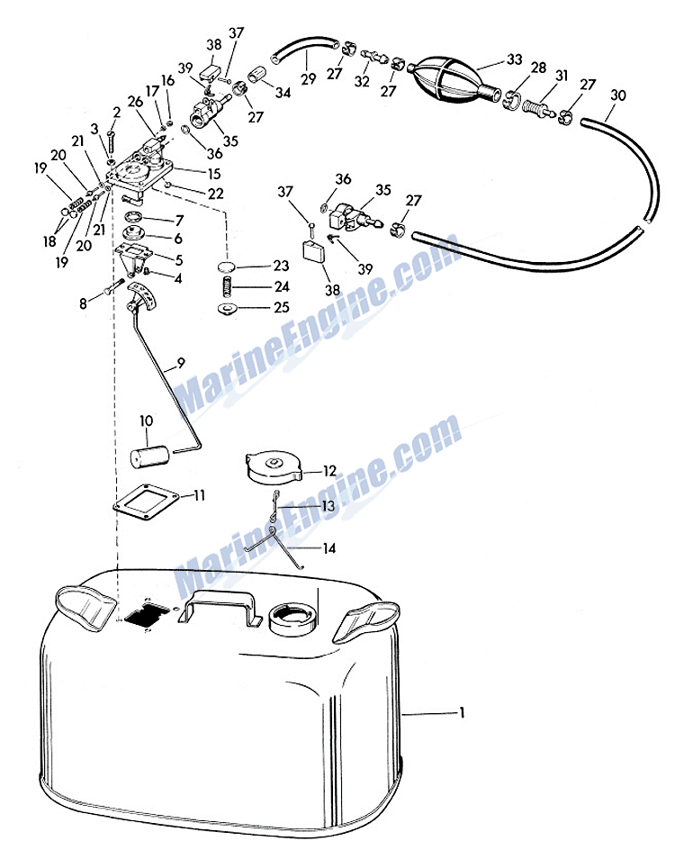

      I have 1960s style Evinrude 6-gallon fuel tank that came with a ’62 Evinrude Fisherman 5.5 hp motor. No fuel line was included so I bought a new fuel line with modern connectors.
      The old fuel tank connector and the old motor connector will not fit the new fuel line connectors unless I drill extra holes in the fuel line connectors. This is a single-line system.
      I have a photo of all three, but the AOMCI program tells me it is too big to upload. (15.2 KB) The fuel line connector is #35 in the diagram.  The tank connector is #5.
      I have been searching for connectors that fit but I haven’t found any yet. Is this a common problem?

        odd because post-60 J&  went single connector  and unless I am wrong  they have not changed
        did you purchase the proper hose type … ie: J&E   connectors       and not a look -a- like

          ?Drill extra holes??? How so??  You didn’t by any chance buy a Yamaha hose, did you?

            I don’t see a #5 tank connector.
            #271221
                he must mean 35

                  I pulled an image off the interweb. These are basically what the male and female should look like on a 1962.

                        The tank connector looks like this. The fuel line is a single line, NOT a dual pressurized line. I can fit a new-style fuel line connector onto this fitting if I use a Dremel tool to grind away some of the plastic, so it doesn’t hit that lower stud. Also, I contacted Doug Brooke at VintageOutboard.com and he says he has fuel line fittings that will work for me.
                        Search: 1 result found for “8056” – VintageOutboard.com
                        I ordered two and I’ll see how they fit when they get here.
