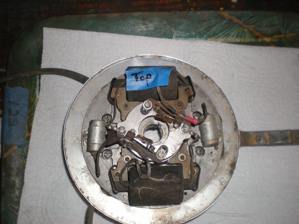

          #199311
          Ralph Simmons
            here is photo of my plate after i had to re do it completely
            was on my oliver 1956 5 1/2hp.
            in my photo i labeled it to help with getting it set up
            front of motor / coils
            i am not sure where coils go to which spark plug
            as there no plug wires went i got
            hope you can help here
            thank you ralph
            #199313
              The coil on the top side of (Port side) your photo should go to the upper cylinder.
