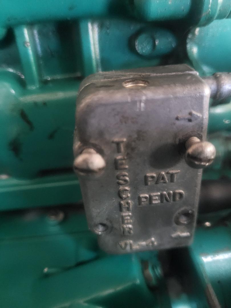

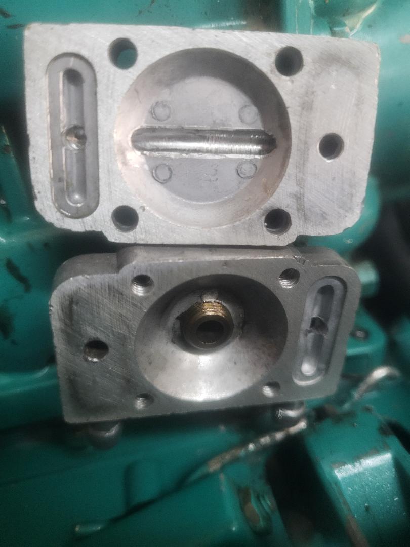

      Motor runs good but the fuel pump isn’t pumping. I replaced the diaphragm (which was rock hard and cracked) and cleaned the pump. I replaced it and still it will not pump. It occasionally spits a little but that is it. It IS getting pulses from the power head. Are there replacement pumps for these? Kits? Or is there something I am doing wrong?
      Your help would be appreciated. Thank you
      Bill

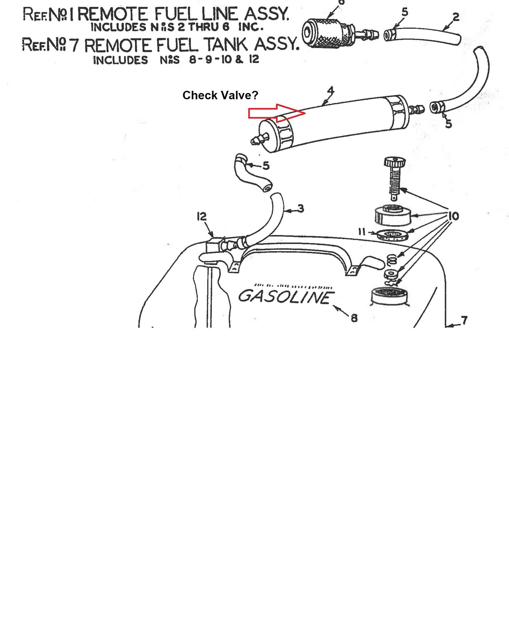

        That sure looks simple; eh?  Not even any check-valves? Perhaps there is a separate check-valve in the line or tank?
        Perhaps trying to “prime” it a bit would help?
        Hopefully someone with experience on these will have some remedy.  Otherwise it looks very similar in overall size and fitment to one of the modern Mikuni pumps.
        Note in the text of Discount Marine’s sale page for this rebuild kit where he mentions that a check-valve has been added?

          Bill, I think Chuck is correct about the check valve. I believe it was originally
          in the Oliver hose. I didn’t have an Oliver tank, and I didn’t know this
          about the check valve seven years ago when I fixed mine up,
          I also put a new diaphragm in the original fuel pump, but couldn’t
          not get it to work either.
          I then tried a gravity tank, and got the motor running fine.
          I thought I might have had low crankcase pressure, so back on the rack it
          went for six years. Finally decided to have another look, and ended up
          putting on a B&S pump (with check valves built in) and it ran great.
          UPDATE, in looking further at my Notes, I didn’t get the B&S pump to
          work either, until I replaced a bad o-ring in the reed block, and
          changed out the Sears gas hose quick coupler that I suspected of
          sucking air.

              Oliver-hose-assembly
              #284191
                Several years ago I studied the Oliver fuel pump till my brain hurt. Still hurts but I think the check valves are the holes and diaphragm in the slots at the ends. Think outside the box. The diaphragm probably has to be just right in thickness and stiffness. That’s all I remember just now.
                #284192
                JOSEPH BRINCAT
                  Maybe your new diaphragm rubber is too taut over the vacuum cavity such that there is insufficient “stroke” . Can you try preforming a bit of a pocket before assembling? Maybe use the pump housing as a form tool with a small ball shaped “lump”… a little heat too, might help.
                  Joe B
                  #284193
                  huntleybill
                    Thanks Frank, I used diaphragm materiel but I don’t know what thickness the material should be for this application. I don’t think I can use the old one as reference as it is dried out and cracked. I’m going to order the pump Buccaneer suggested and save this one for future experimentation.

                      Frank….maybe reading the text of the patent is what made your head hurt?  Somewhere amongst all that….there might be an explanation of how it works. Maybe..
