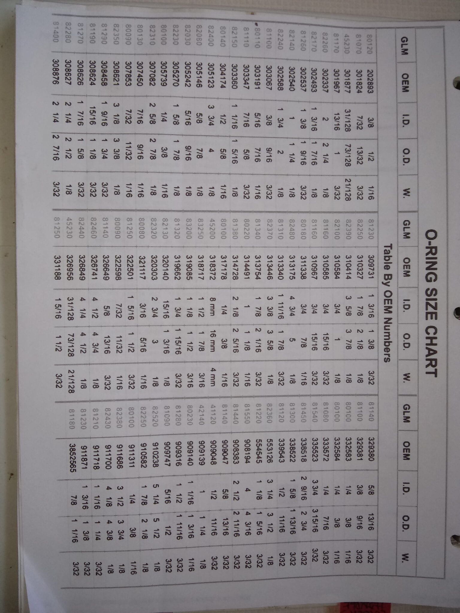

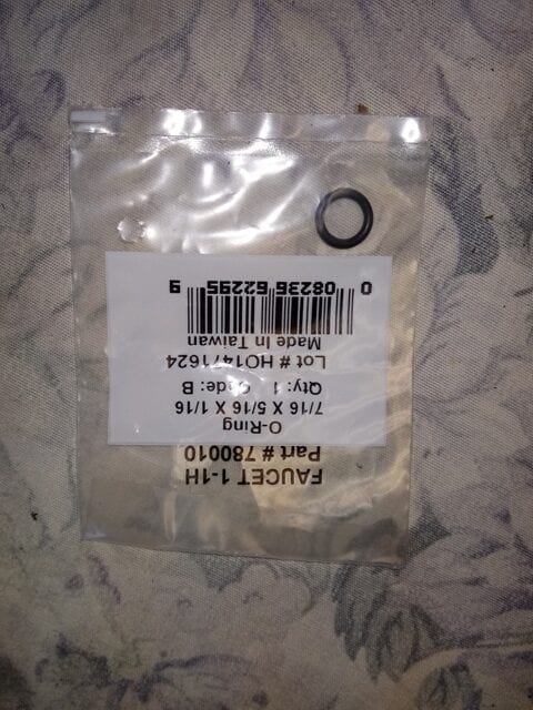

        #235525
        outboardnut
          I buy them at my hardware store
          o-ring-sizes
          20210403_130507
          #235539
