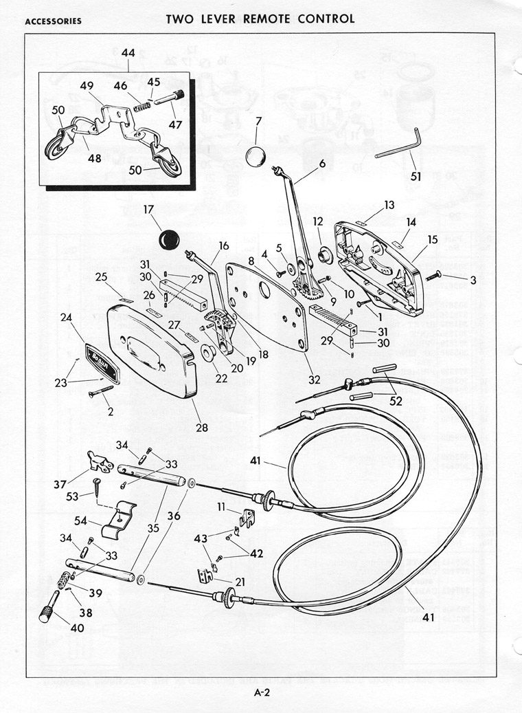

October 9, 2022 at 1:34 pm #267341An (1958) example of the old “fat” cables without plastic adjusting nuts. Locks #11 & #21 are different size.
