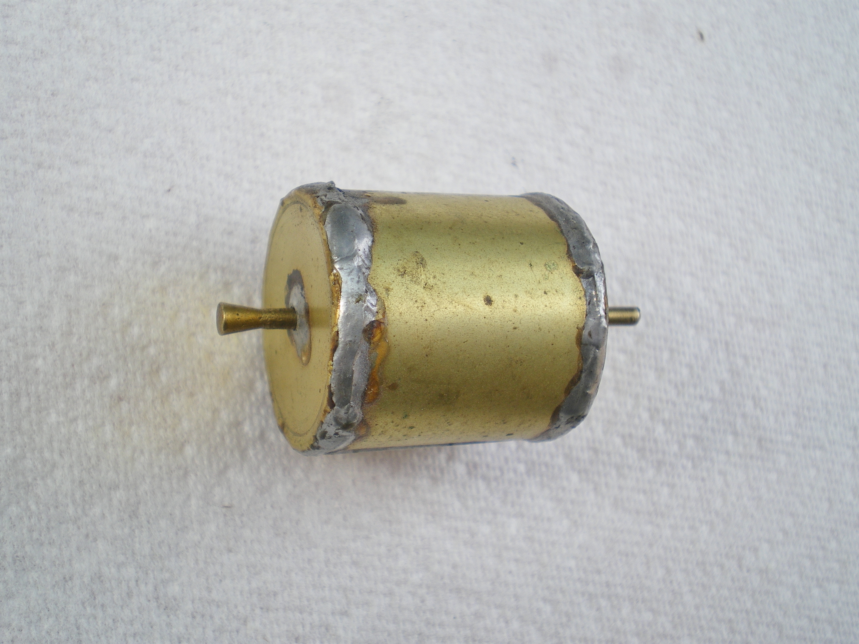

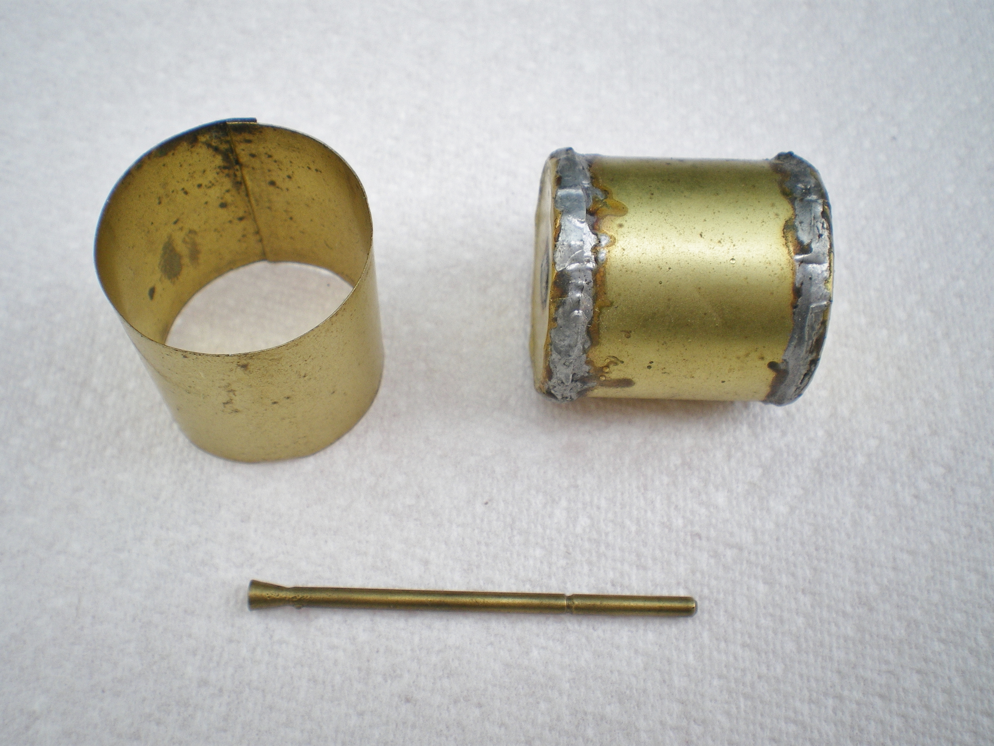

I did try to make a brass float for a TN once but haven’t had a chance to try it out yet. Maybe I should try again as my soldering skills have improved a bit since this attempt was made. ☺

October 11, 2016 at 10:00 pm #45640Mumbles that is interesting and would look good.(not that anyone but me would see it) I would just have to figure out how big to make it for a handitwin so it had the right measurements but not too heavy. Made me think of a float I had in a Tecumseh mower engine. It finally did wear a hole and leak, but I see potential in yours. Also worth noting the Tecumseh replacement was a semi clear hollow white plastic. How are your plastic forming skills? 🙂

October 11, 2016 at 11:07 pm #45646quote Mumbles:The BRP carb kits I use contain a new plastic foam float so I always install it. If the old cork one still looks good, I’ll save it for an emergency but usually they look pretty beaten and weathered.Since OMC/BRP are only in business to make $$$ and plastic or cork floats being much cheaper to produce than a two piece brass float, I think it’s obvious why they went that route.
Mumbles, excellent attempt, my only comment would be your trying to add solder to the float, when you should be trying to "flow" the solder into the joint…BIG difference in weight and appearance. think like trying to solder a water line… they heat the joint, that has been properly prepared and fluxed, then once hot enough they then introduce a small amount of solder and it flows the entire way around the joint.. Hope I described it right, plumber can show you…after all that is their trade… Trying to help…

October 12, 2016 at 5:03 am #45673Mumbles; Richard gave you some good advice. If I may add, wipe off the joint while it’s still hot with your acid brush. It will guarantee a good seal and look nice and smooth.
