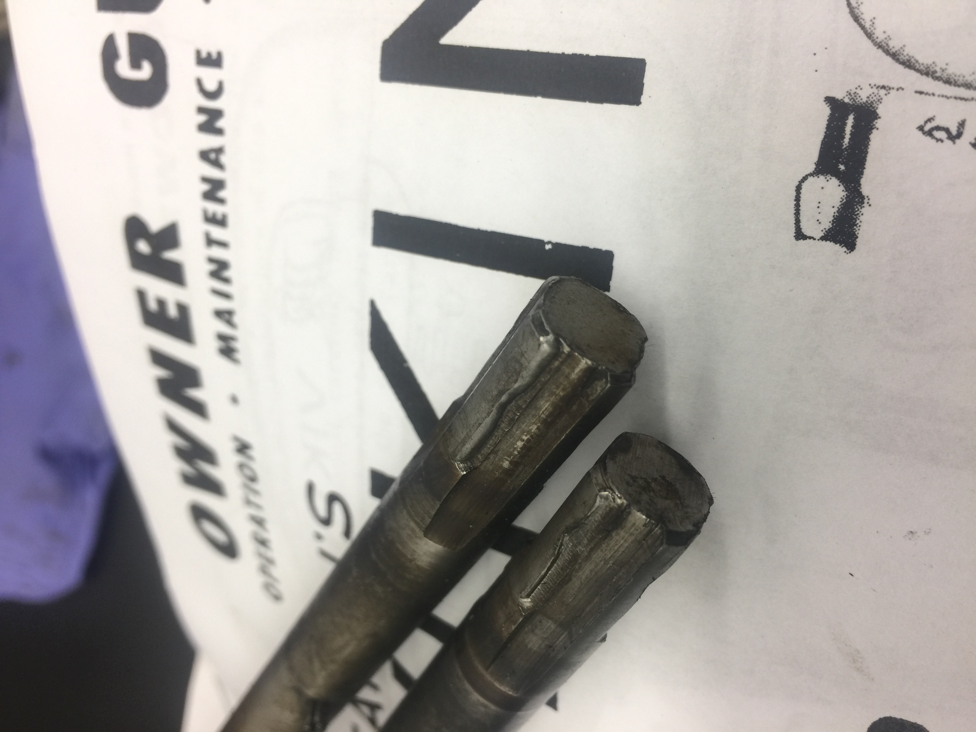

      I am working on a 1957 Viking 5HP (5D14V)….These are the same as any of the Bucaneers and all of the other store brands. I need a driveshaft and crank due to bad splines. I am trying to determine what the potential donor motors might be.

            What you described is exactly what I expected, however; the 303441 part number is a mystery. The early CDs and the Gales use the 376093 driveshaft as you described, with the 5D14X motors being the exception….they call for 303441. 303441 shows up in the 1960 price list with no superseeded number. By 1964, it is not even in the price list (not even showing a replacement number)
            I too though that the Gales had steel shafts. My experience that most of the steel shafts have 550XXX or 552XXX numbers, but maybe this is the case here too. I have a complete motor and a secon that is only the lower section, both are 5D14V and the shafts are both among the worst I have seen. The 4 course slpines at the top are worn away by 1/2 of thier width. I need to clean out the crank, but suspect that it is toast.

                Well,I’m not sure what to think. I had two 5D14V bottom ends and both driveshafts were very worn. I tore down two 5D16B parts motors and the shafts were perfect, as are any of the 5.5 J/E motors that I can remember working on. For some reason, my Canadian parts lists call out a different number for 1957 only. The shafts appear the same and look to be stainless, not mild steel. The motors with the worn shafts did not look any more tired than the ones with the good shafts.
                This one is a mystery to me. Now I just need to find a good crank. The Gales both had crankcase ventilation issues on the lower rod throws 🙁
