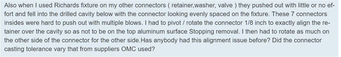

      Also when I used Richards fixture on my other connectors ( retainer,washer, valve ) they pushed out with little or no effort and fell into the drilled cavity below with the connector looking evenly spaced on the fixture. These 7 connectors insides were hard to push out with multiple blows. I had to pivot / rotate the connector 1/8 inch to exactly align the retainer over the cavity so as not to be on the top aluminum surface Stopping removal. I then had to rotate as much on the other side of the connector for the other side.Has anybody had this alignment issue before? Did the connector casting tolerance vary that from suppliers OMC used?

        I’ll let Richard answer for himself, but I designed that fixture he is making. There should be little if any problem with simple visual alignment. No, OMC has not changed the connector spacings. If you want to experiment, try tapping the retainer in just a bit and see how it aligns with the fixture cavity.

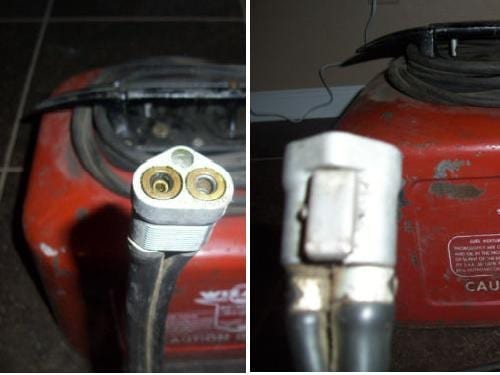

          Connectors
          What you might have are early hard to find Mercury-Wizard dual line connectors, and not Johnson-Evinrude ones.
          Merc-wizard-pressure-Fitting

              If I am reading this right you had success with the tool then had some other fittings that did not work?
              Can you post photos of the fittings that did not work?

                Partially reassembled the difficult connectors and partially pushed in the brass retainer. Aligned and centered the connector on the fixture. All 8 popped out easily while aligned. Cannot understand why they were so hard to disassemble while having to misalign on the fixture during the first disassembly. The removal multisided rod was deformed and slightly bent like a 20 year old iron wood splitting wedge. Am satisfied with the fixture but may need to purchase a new 2.5 – 3 inch rod.
