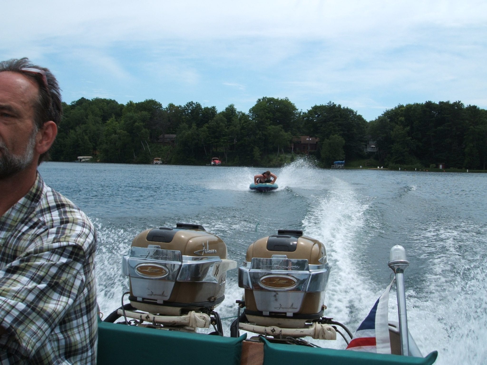

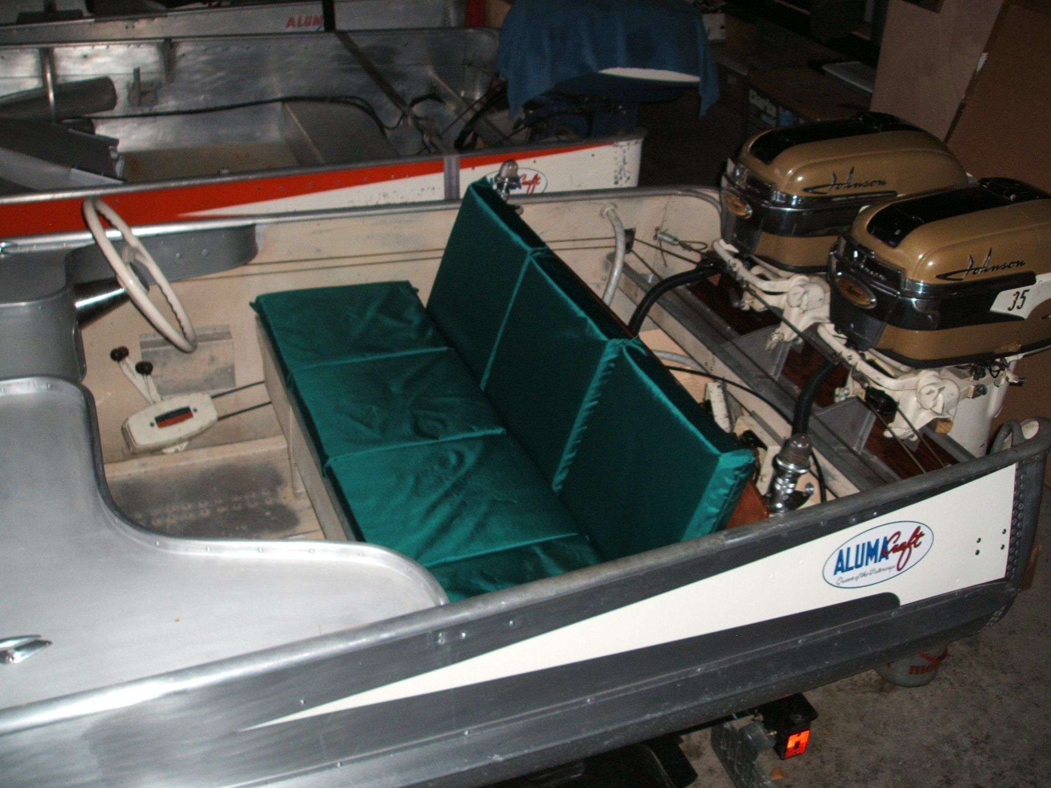

        Maybe this will help.
        2011_0705BoatsFlanneryBob0001
        Alumacraft-Super-CS-031

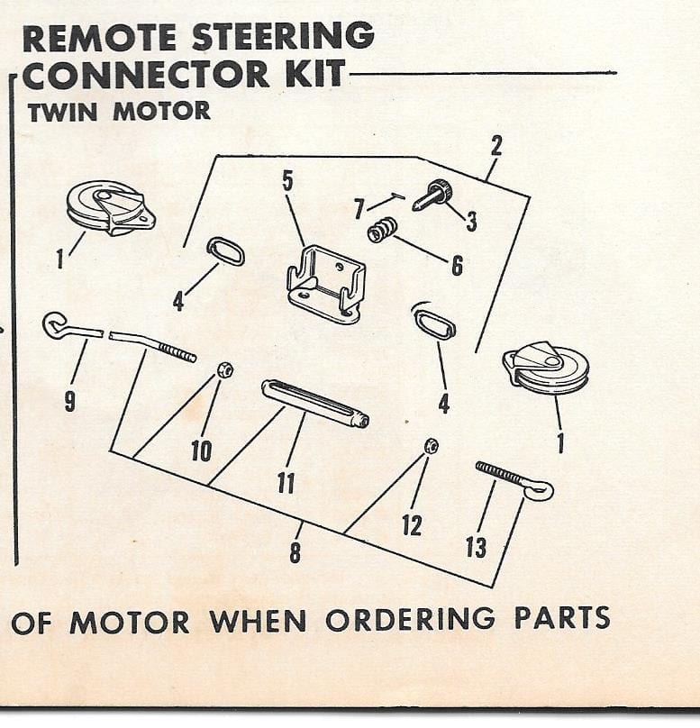

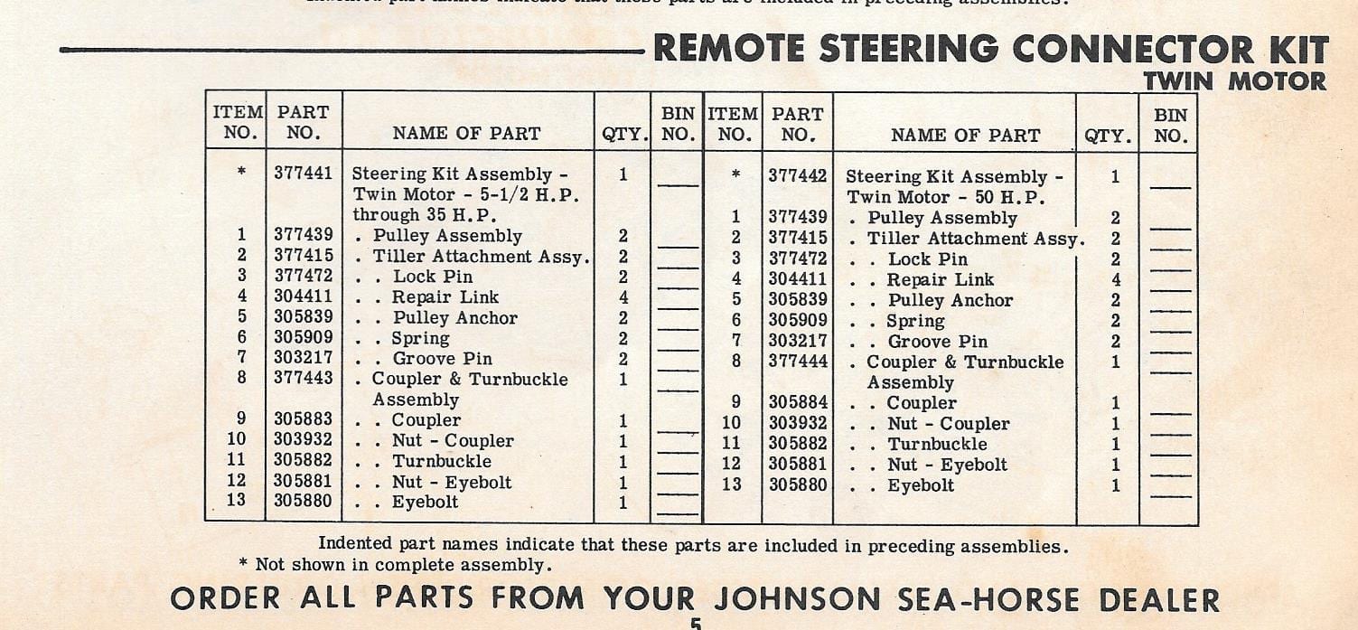

          Here is a kit list from ’58 and a parts breakdown from ’59 if it helps.
          58twinkit
          59twin
          59twinlist
          • This reply was modified 6 years, 5 months ago by Mumbles.
          #203225
            The bend in the omc tie bar is the secret to being able to run with one motor tilted up.

                #203248
                  It’s stainless steel. Diameter, I don’t remember. 5/16″?????

                  kirkp
                    Sweet setup Lloyd. What model Alumacraft is that?

                      LLOYD LAUTNER
                        Alumacraft Super CS. Took me a long time to find those two Original Javelins and fabricate and rig all the details. Running lights, steering, paint, decals,seating, bilge pump, trailer, etc. I had a blast with it here on the lake and at Tomahawk. I have 5 Alumacrafts at my pole Barn. Going to have to sell it and several more. Getting too old to keep up with all of them. Got any leads?
