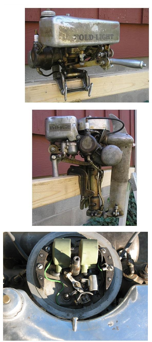

            There are 3 Folding motors manufactured between 1929 & 1934. The 30’s OMC “Foldlight” model, sold as Lockwood, Elto, Sea King, and Evinrude were manufactured from 1930 to 1934 and have a magneto. The failure of the coils is common but the inexpensive OMC style coil can be substituted. Photos attached. In 1929 there is the “Folding Lightweight”, having a battery ignition, and the “Folding Sportwin” also known as the “Folding N”. In the two links below, I explain the differences in the two models. As far as which I would recommend, you can see I’m partial to the Folding Lightweight in the 3rd link.
