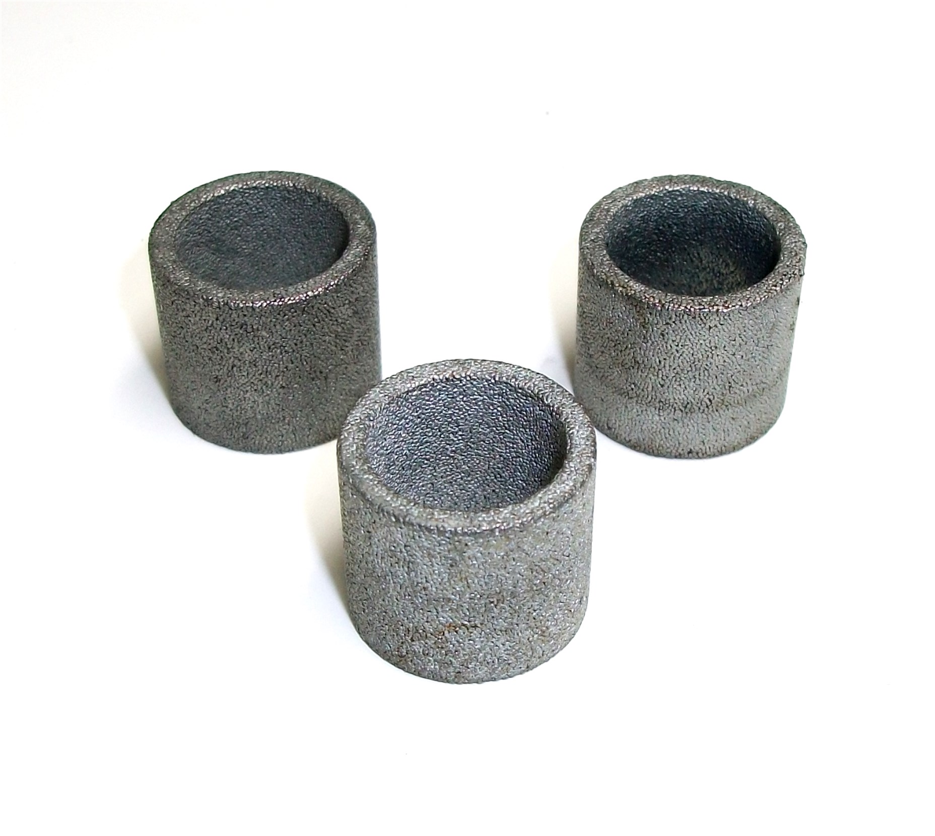

            Is your motor missing the filter or is it clogged? I have had pretty good luck cleaning out the sintered filters using carburetor cleaner and compressed air if it is clogged. I know it looks unoriginal, but you can always run without the filter in the bowl and add a small inline filter before the carburetor too if all you want to do is make sure the fuel is clean. Just thoughts.

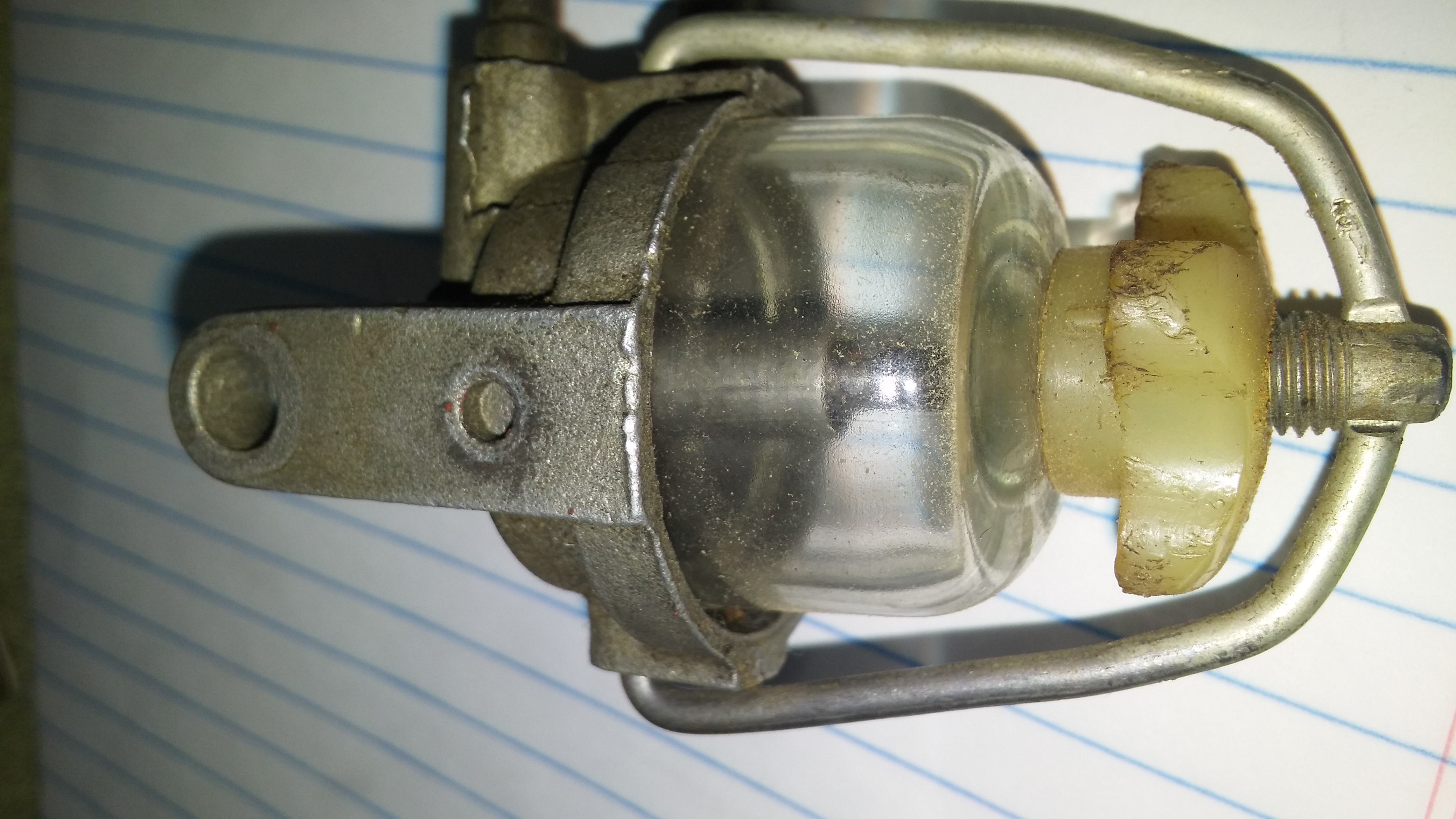

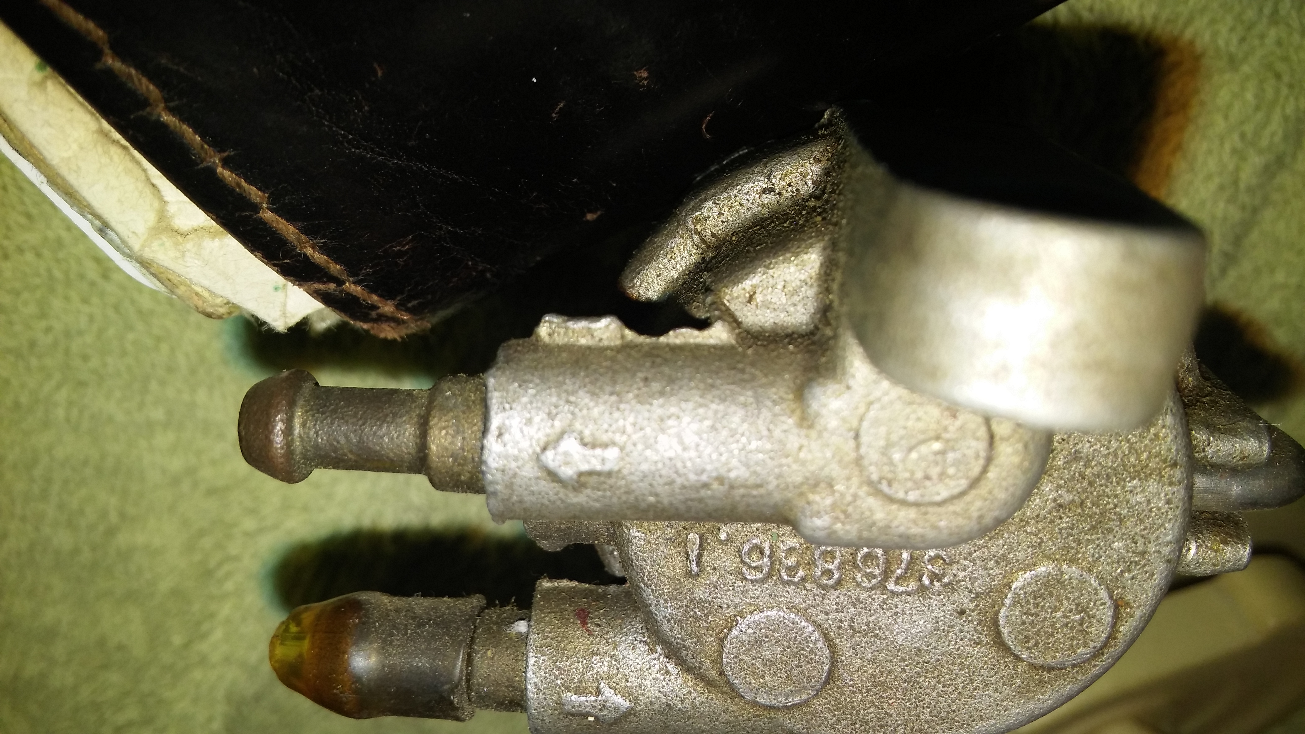

              what is the size of the bowl I have a NOS 303121 sediment bowl with the gasket that lists for $48 but I will sell it for $24. Also have a used sediment bowl but not sure what it is for. Give me the diameter and height of yours and I will see if it will work. Attached are pics of the used one. Complete assembly asking $20

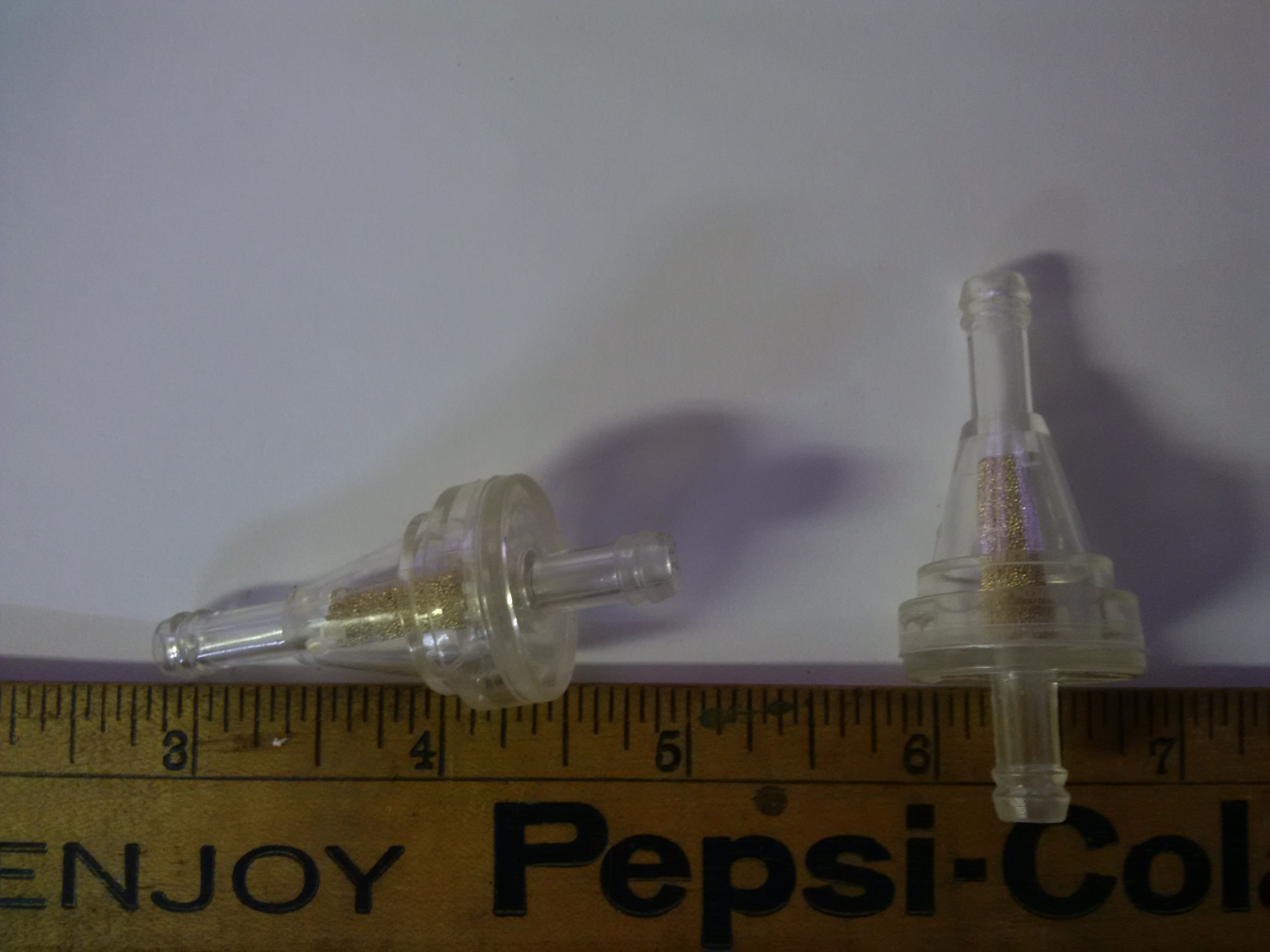

                    Ordered about a month ago and just received 10 of these in the mail today. About 50 cents each with free shipping to Canada. Haven’t tried them yet but they look ok . Nice and compact so you should be able to find a spot under the cowl to splice them in the fuel line going to the carb, and eliminate the filter in the bowl altogether.

                      I’ve used these Sierra filters – I know they fit in the sediment bowls on 30 – 35 – and 40 HP OMCs from the 1950s and 1960s and look like the originals. I don’t know if they fit that 7-1/2 you mentioned on the bottom of the carb. Also Sierra 18-2889 is the sediment bowl gasket for these bigger motors.
