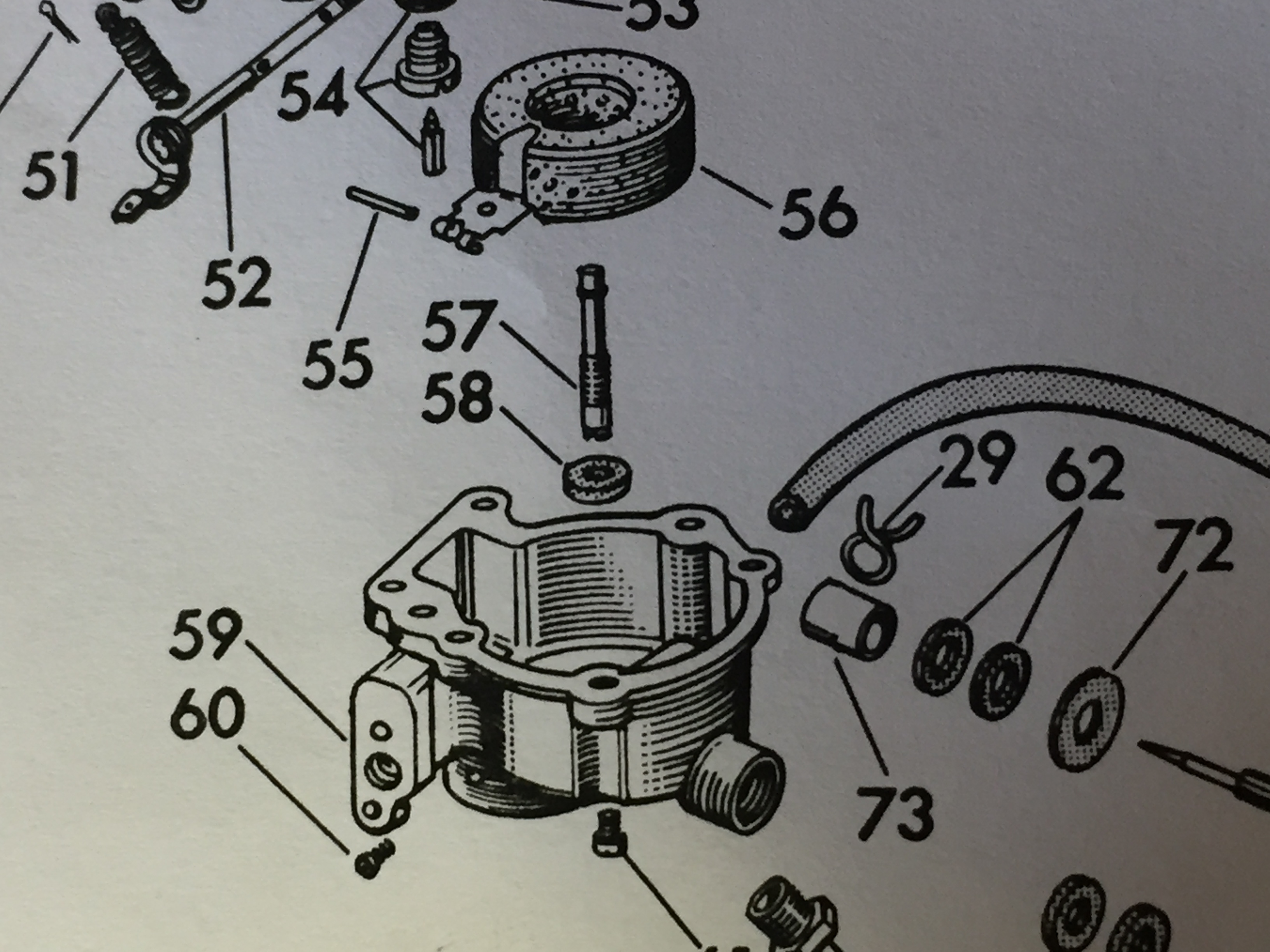

      I have a good o-ring replacement for the RD and Bigtwin models (McMaster-Carr 70 BUNA size 201). But I don’t have a replacement o-ring for the other models. Here’s what I have gathered about the jw through FD models:
      JW through QD models was #302984 but has superseded to #344037.
      FD was 304940 but has also superseded to #344037.
      So if all these models now use the same OMC number, isn’t it safe to assume a relacement o-ring would work for all these models? Does anybody have a good lead for a replacement o-ring? What do you guys replace them with? I see the superseded part is still available but I’d rather buy a bag of 100 from McMaster-Carr, etc than pay $5 every time i need one.

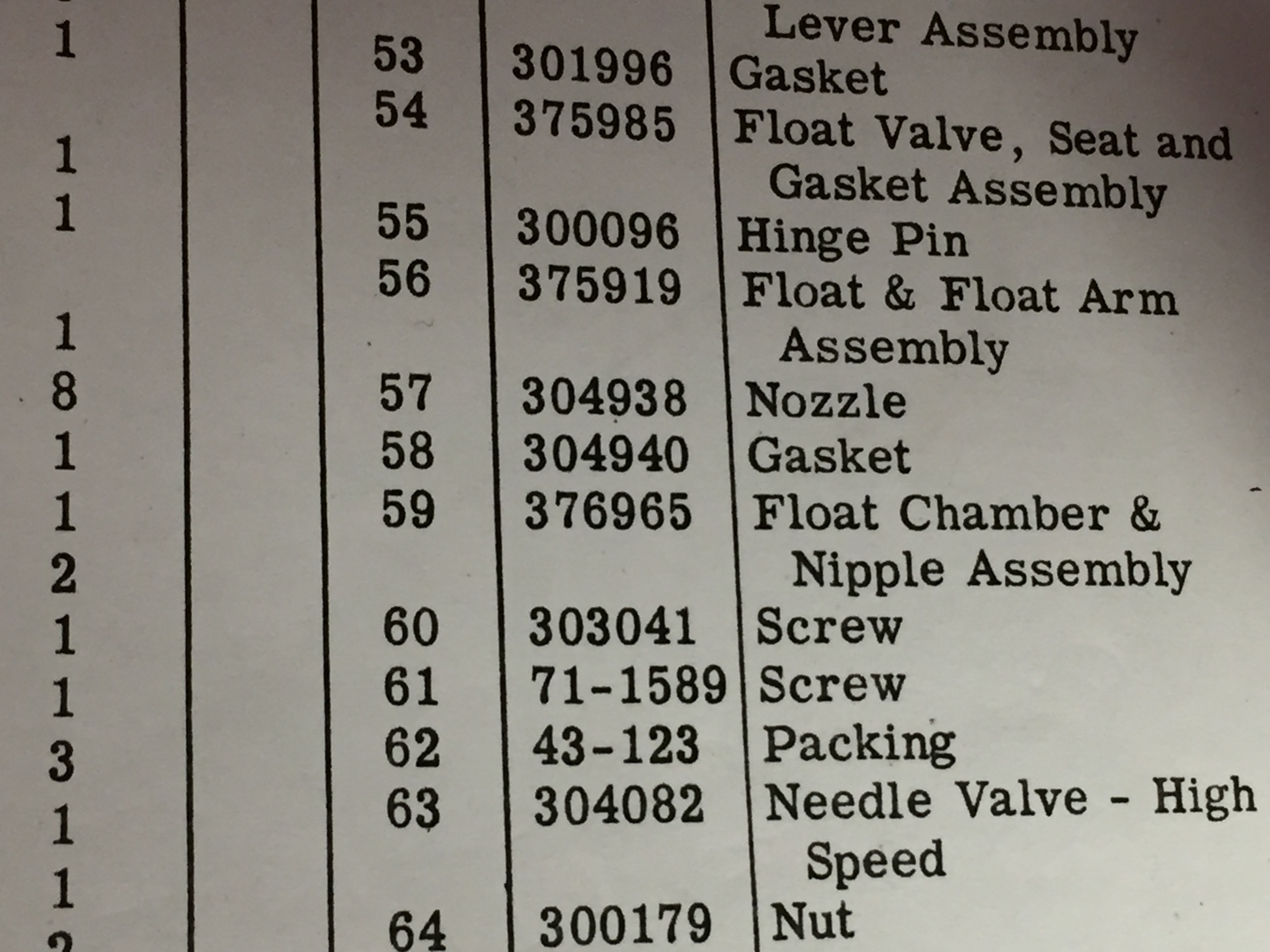

              opposedtwin
                quote FrankR:
                Where did you come up with that odd number for FD models? As far as I know they use the same 302984. I think the oring is 1/4" ID x 3/32" thick, but could be wrong. I’m away from home right now.
                Frank, that number (#304940) came from my 1957 FD parts catalog.
                #63546
                  OK, I agree, my parts books say the same thing. I don’t know what the reason is.
