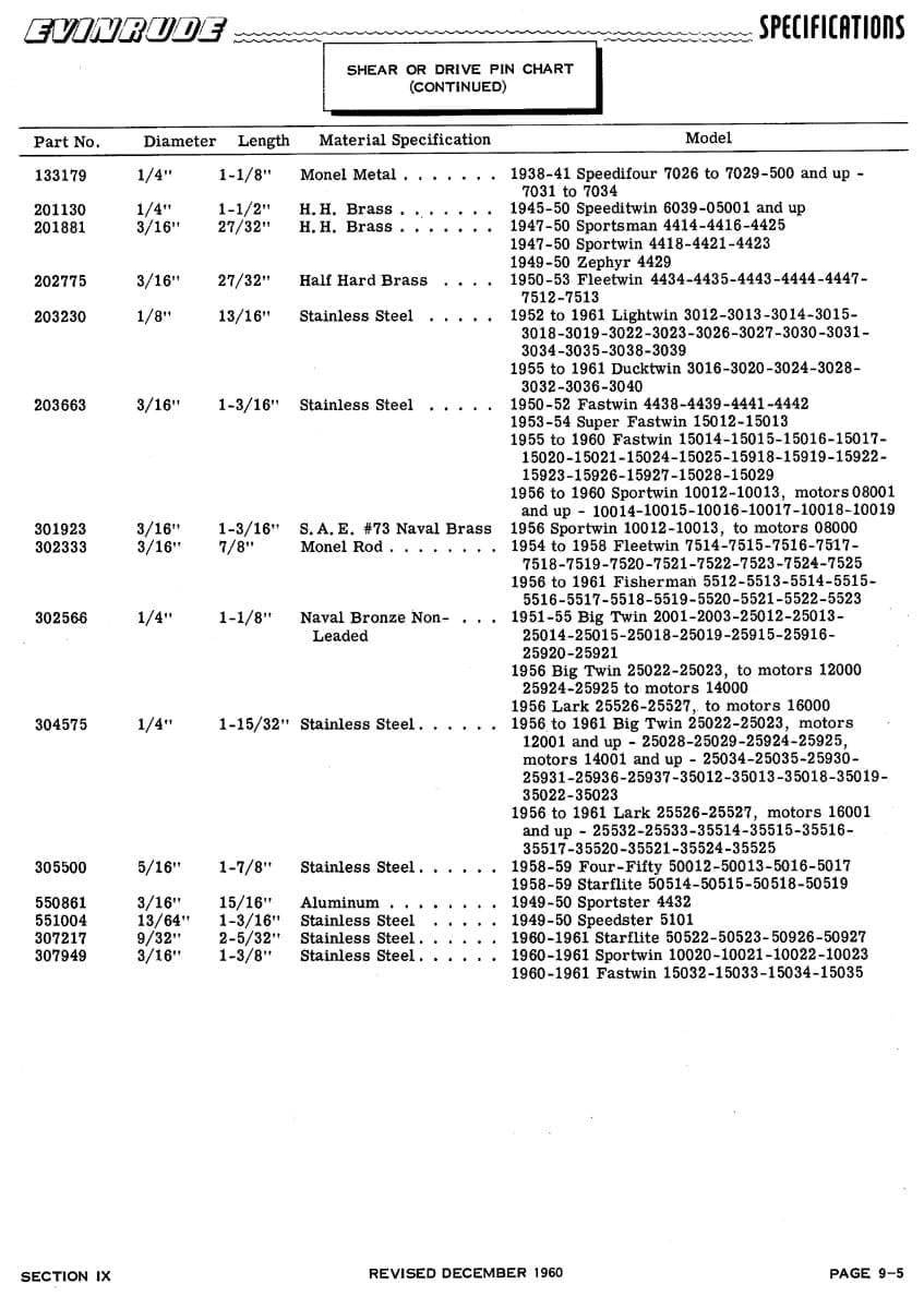

            Steve D
              where do you get brass shear pins?
              If you want to cut your own I think you’ll need 3/16 brass rod found at Home Depot, Loews, eBay, etc. Chart, compliments of Garry I believe…
              https://www.ebay.com/itm/K-S-3-16-in-Dia-x-12-in-L-Brass-Rod-1-pk/282469227054?hash=item41c47a5a2e:g:ko8AAOSwVAtcOIRV:rk:1:pf:1&frcectupt=true
              Shear-Pin-Chart
