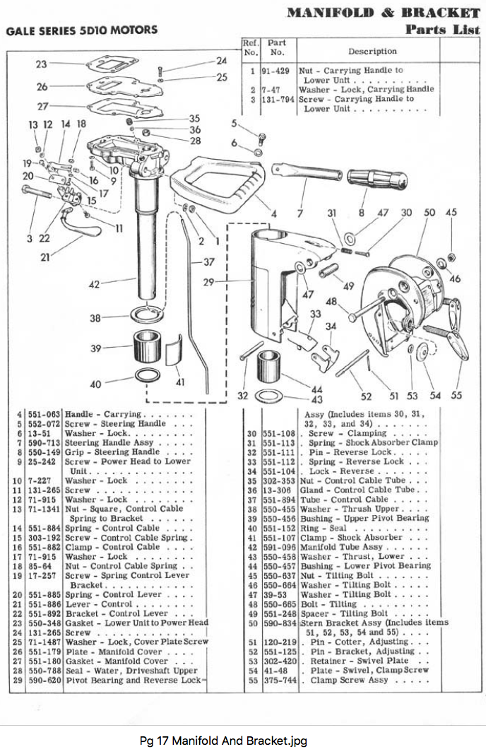

      I have a 1951 SeaKing 5hp (Gale 5D10). I need a powerhead gasket (not head gasket) or advice on what gasket material to use. The original is in decent shape. Can I reuse it with or without sealant? If sealant, which type?
      Or can I just use sealant w/o a gasket?
      #34460
        Gasket 0551180 is available – $5.00 list price – If the old one is good, try it.
        #34478
        wagemaker
          Thank you Garry.
